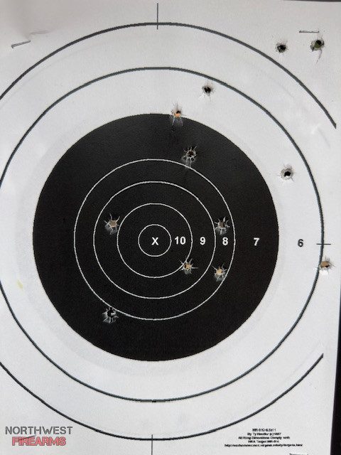

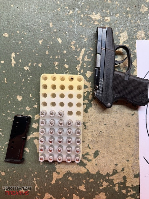

Well, you made me do it......I took a range trip this morning and found "problems" with my Kel Tac P-32.

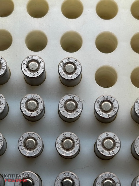

I found some old ammo that I had gotten from someone/somewhere.
I have no idea how many grains the bullet actually is. I'll guess.... it's about 73 grains.
I was not impressed.
It's about a 6" black.
6 o'clock hold and again at a 12 o'clock hold. Even at 21 feet. Dammm.....I can't even see the sights clearly. Not to mention the "problem" with the trigger.
I also tried some old Remington FMJ stuff. It was a little bit better. IMHO.
Sort of center hold. LOL.
BUT.....the trigger problem persisted. Altogether, fewer than 100 rounds in total. Ouch.....my finger hurts. It wasn't a fun day for me.
Aloha, Mark

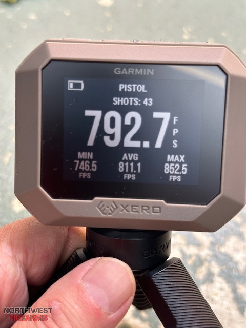

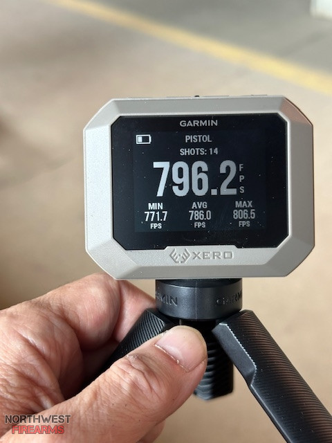

BIG difference in .32 ACP velocity between a Beretta Tomcat and the M1935. You would not think one inch of additional barrel length would matter this much! These data from The Fouling Shot No.246 of March-April 2017:
.........................Tomcat 2.4".............M1935 3.4"
Geco 73 FMJ - 907 fps 14 Sd........977 fps 11 Sd
RWS 73 FMJ - 896 fps 29 Sd........981 fps 16 Sd
Fiocchi 73 FMJ- 848 fps 32 Sd......917 fps 11 Sd
Buffalo Bore 75LFN- 883 fps 6 Sd...997 fps 7 Sd
R-P 71 FMJ - 822 fps 29 Sd...........901 fps 17 Sd
W-W 71 FMJ - 846 fps 24 Sd.........957 fps 18 Sd
