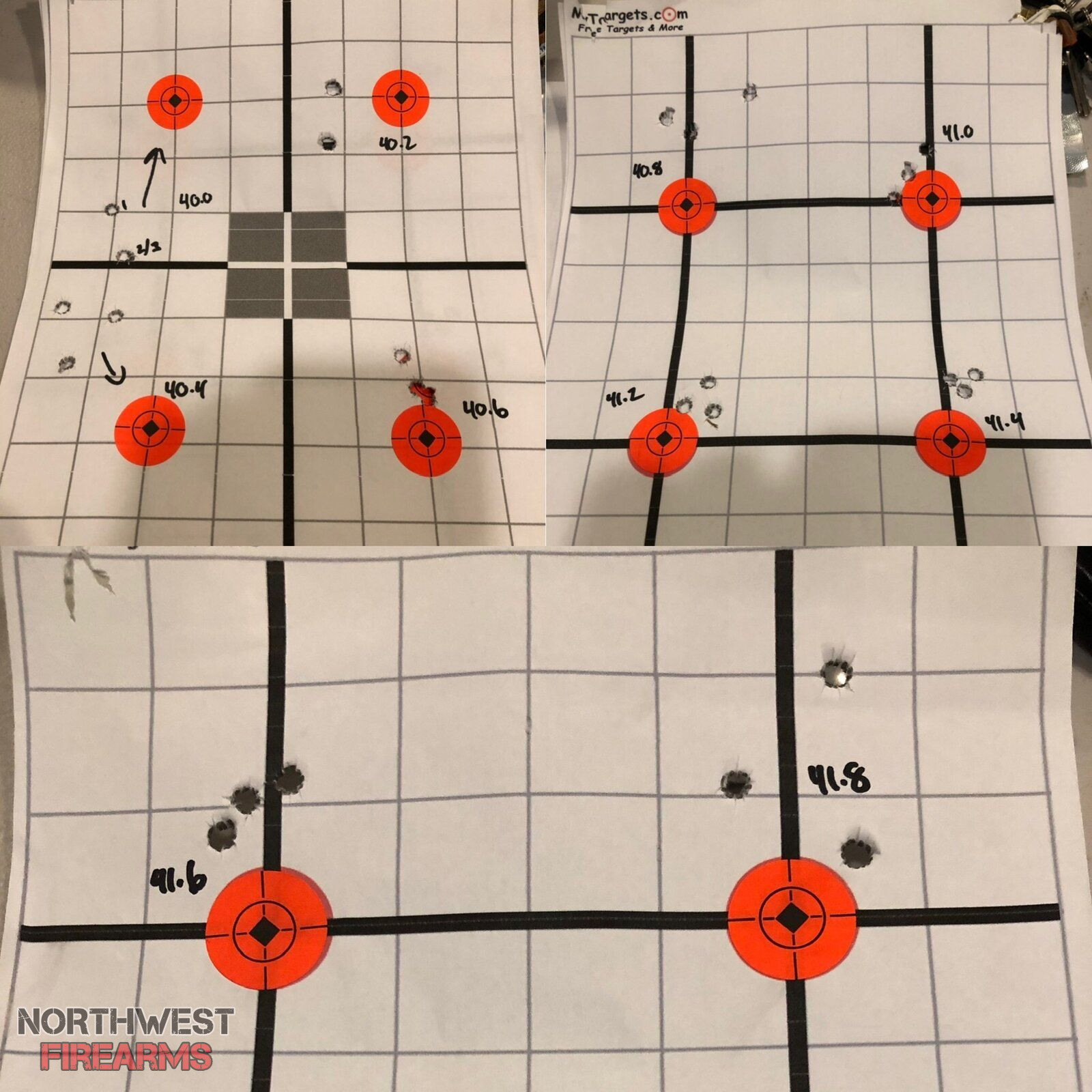

the below is posted for the OP to show the groups getting smaller then opening up.
Easy to track a few accuracy nodes on this one.

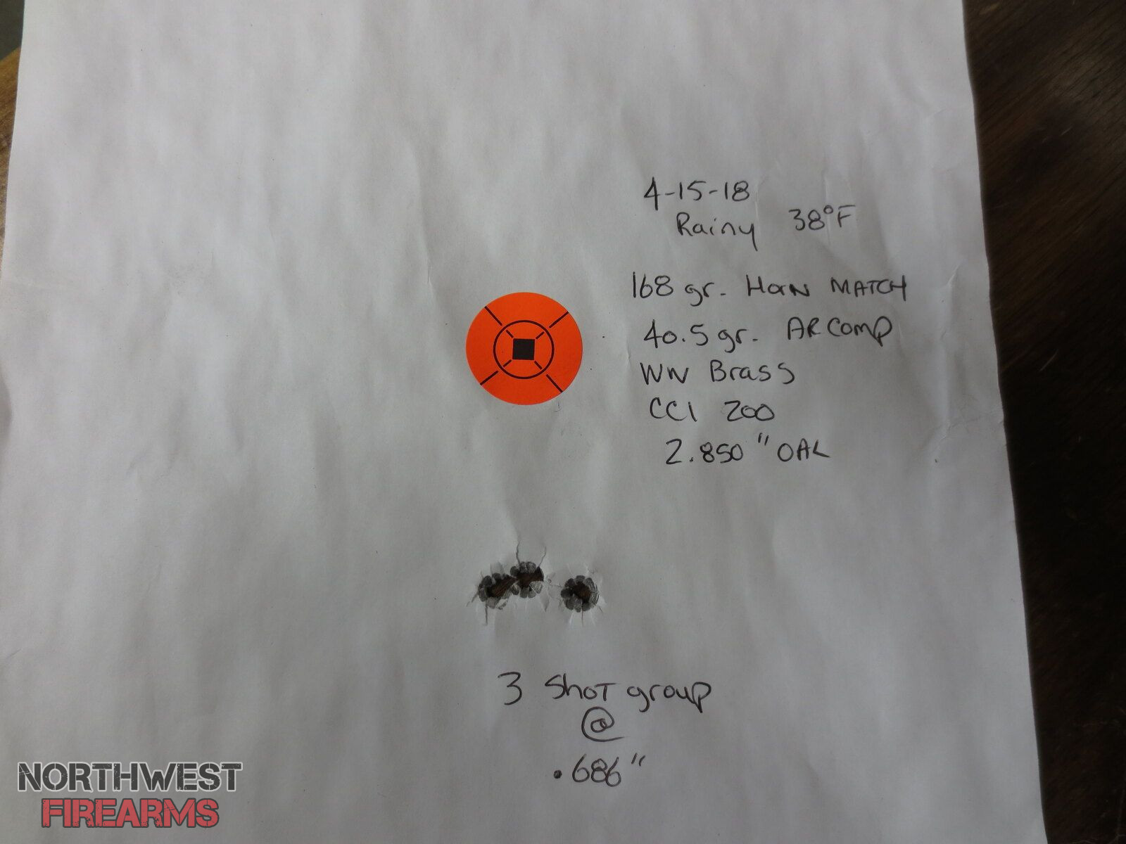

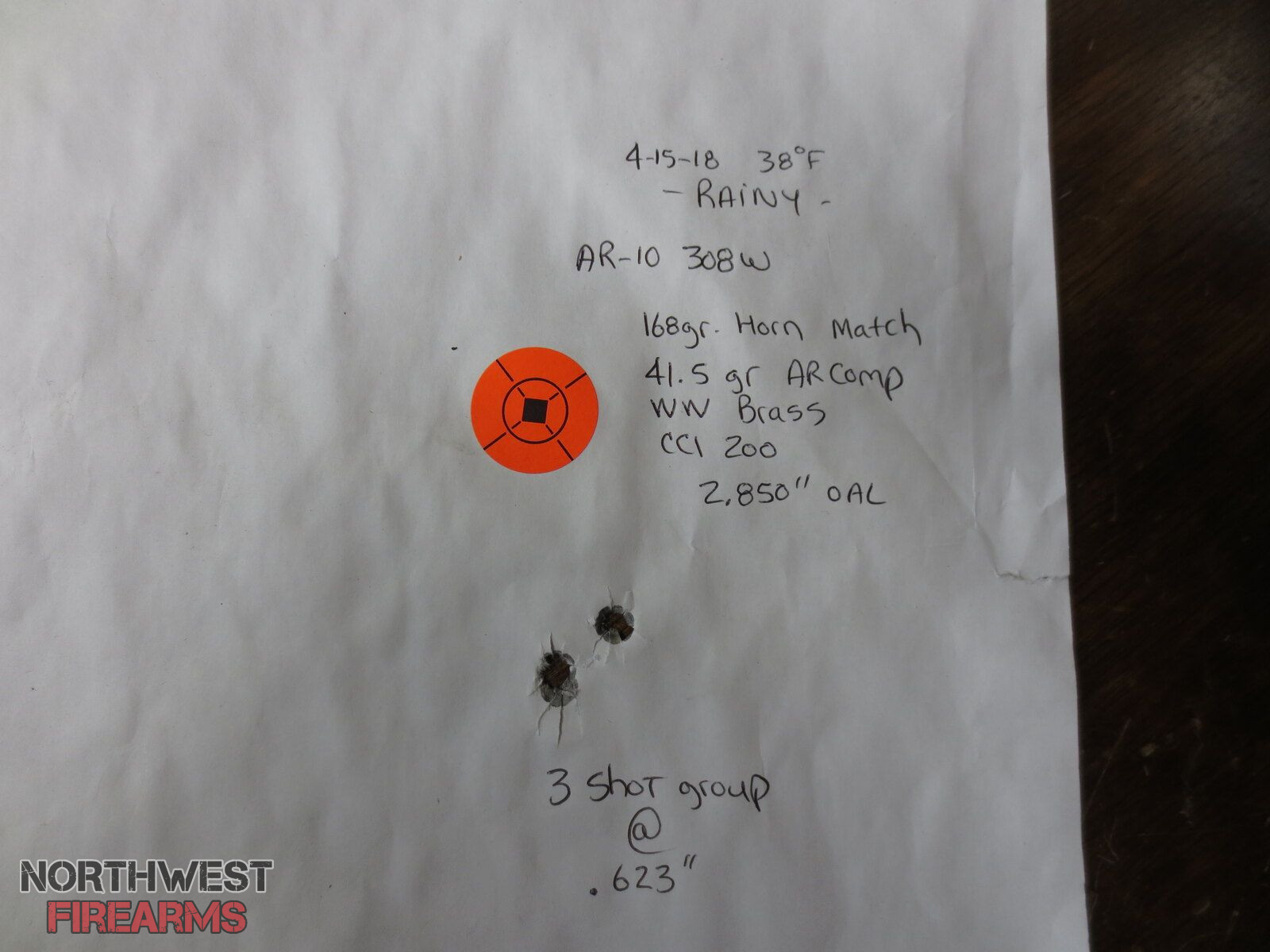

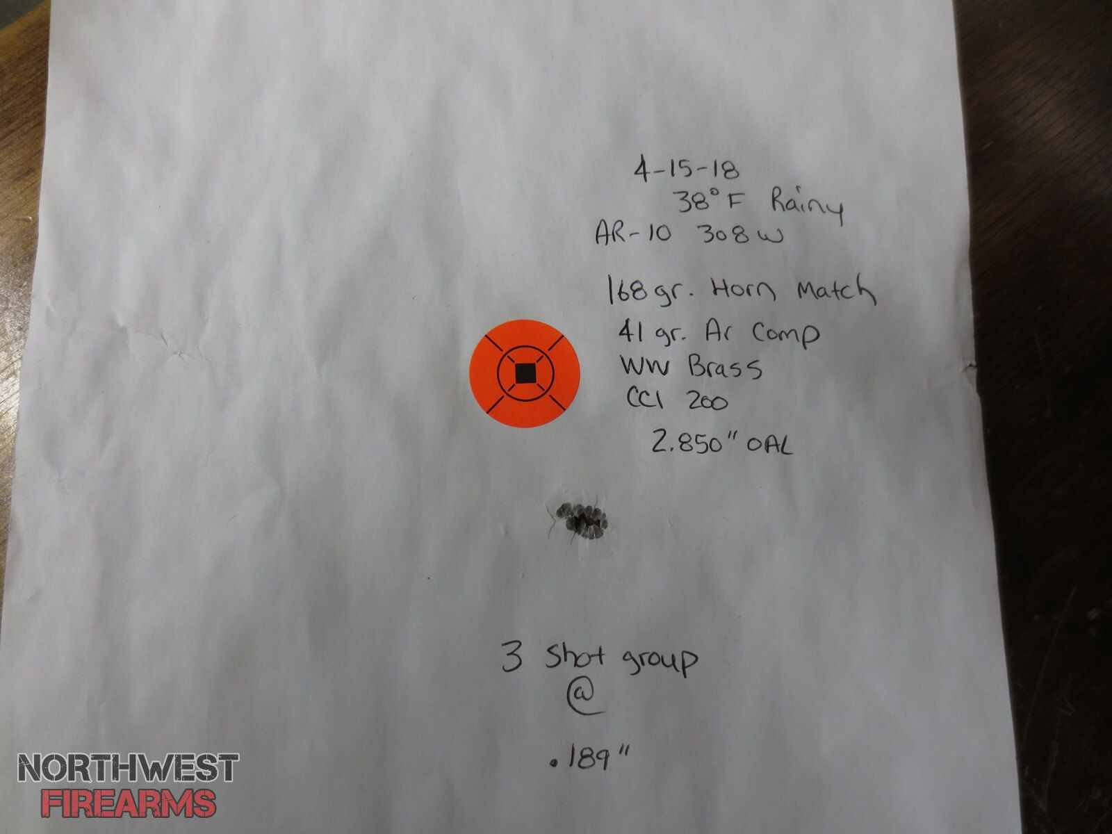

I also like to see the "node" when hand loading as well. Most time it's blatantly obvious. Check out these groups from my AR10, when I was developing the best load with that particular bullet and powder combo. I'm also like Dizzy and vary powder charge weights by .5 grains in cartridges larger than 308w:
Seeing the node is simple most times and finding a good load is rather simple and straight forward.
