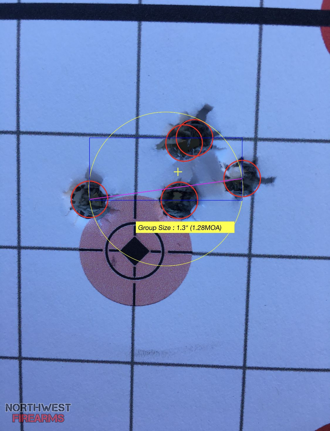

Yeah I've had pretty good luck with the lot of projectiles. They are just pulled M80 projectiles but here is a group that I got with BL-C(2) out of a TC Compass. I'm anxious to get back and see what kind of accuracy I can get with theWC46 and the SIG
