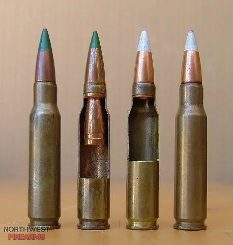

When I saw the thread title, I thought it was going to be something along the lines of the M198 duplex cartridge. 🤭
