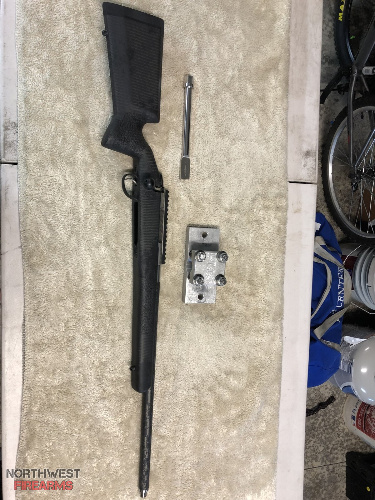

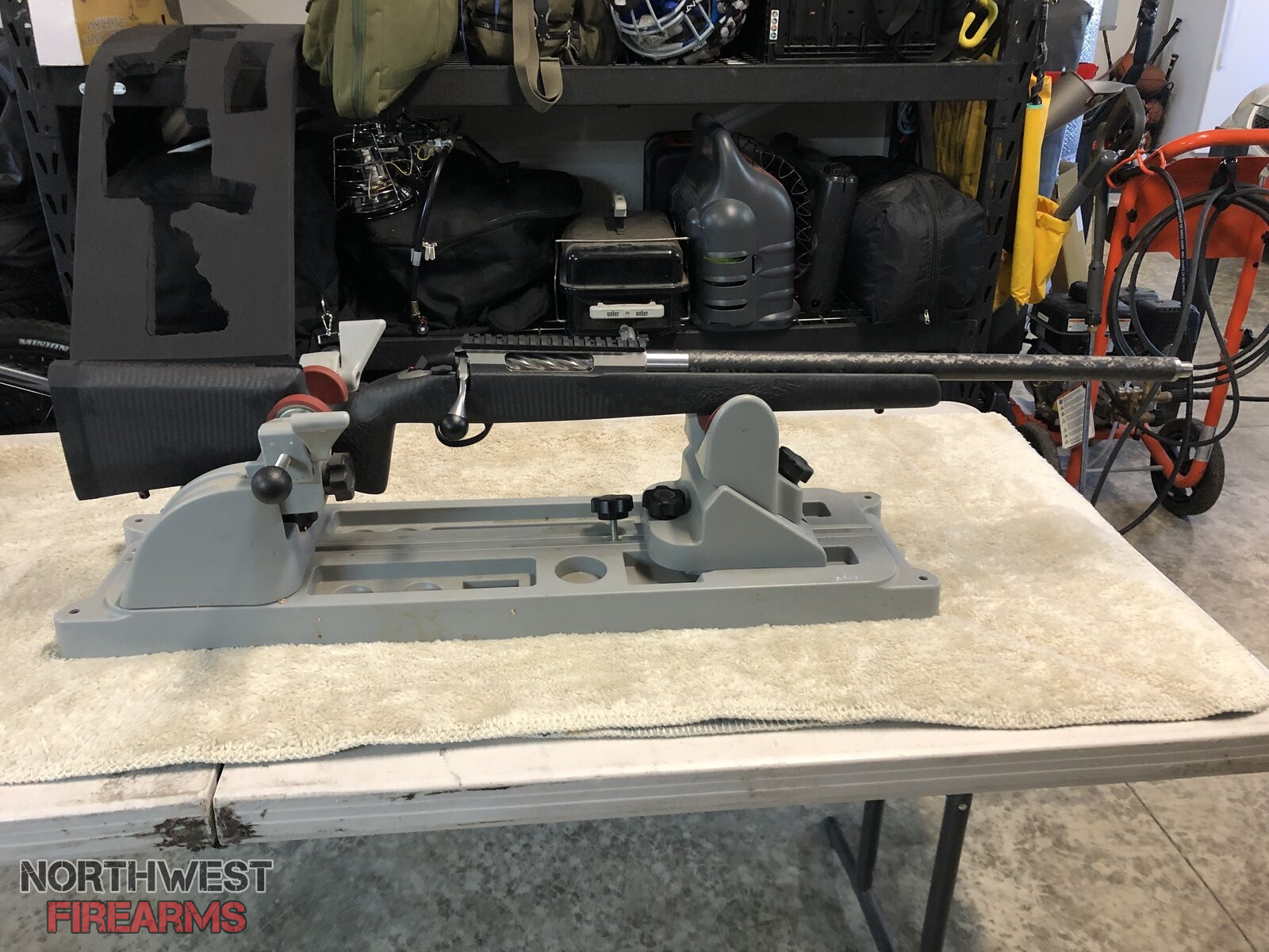

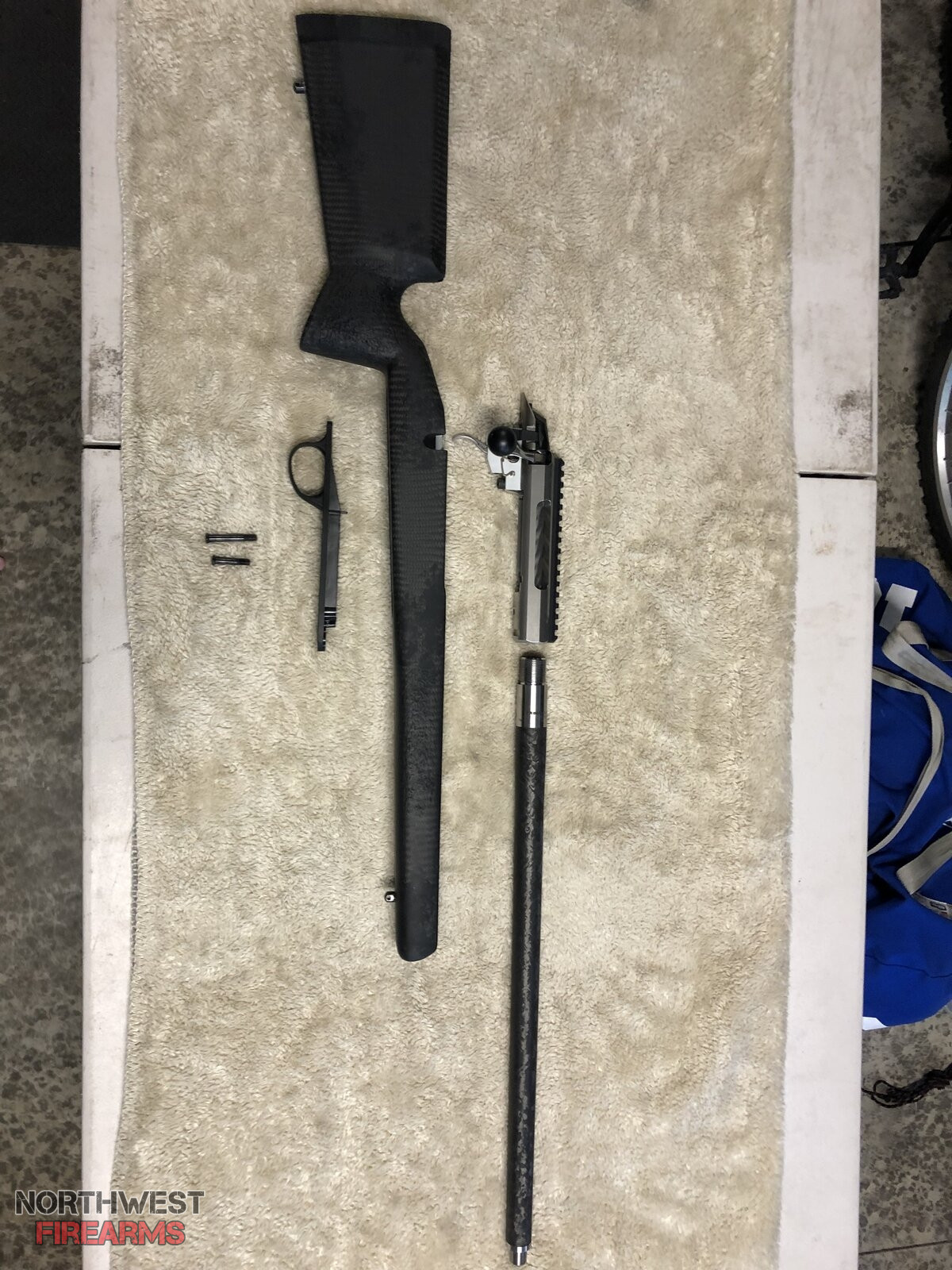

Just finished putting together my first semi custom rifle. Used a Tikka action, 22" Proof 7PRC pre fit barrel and a Manners EH1TK stock. Pretty happy how it turned out. Should have enough cash in a month or so for some glass and then finally get her out to the range. I've got reloading components so I'll update when I start load development.

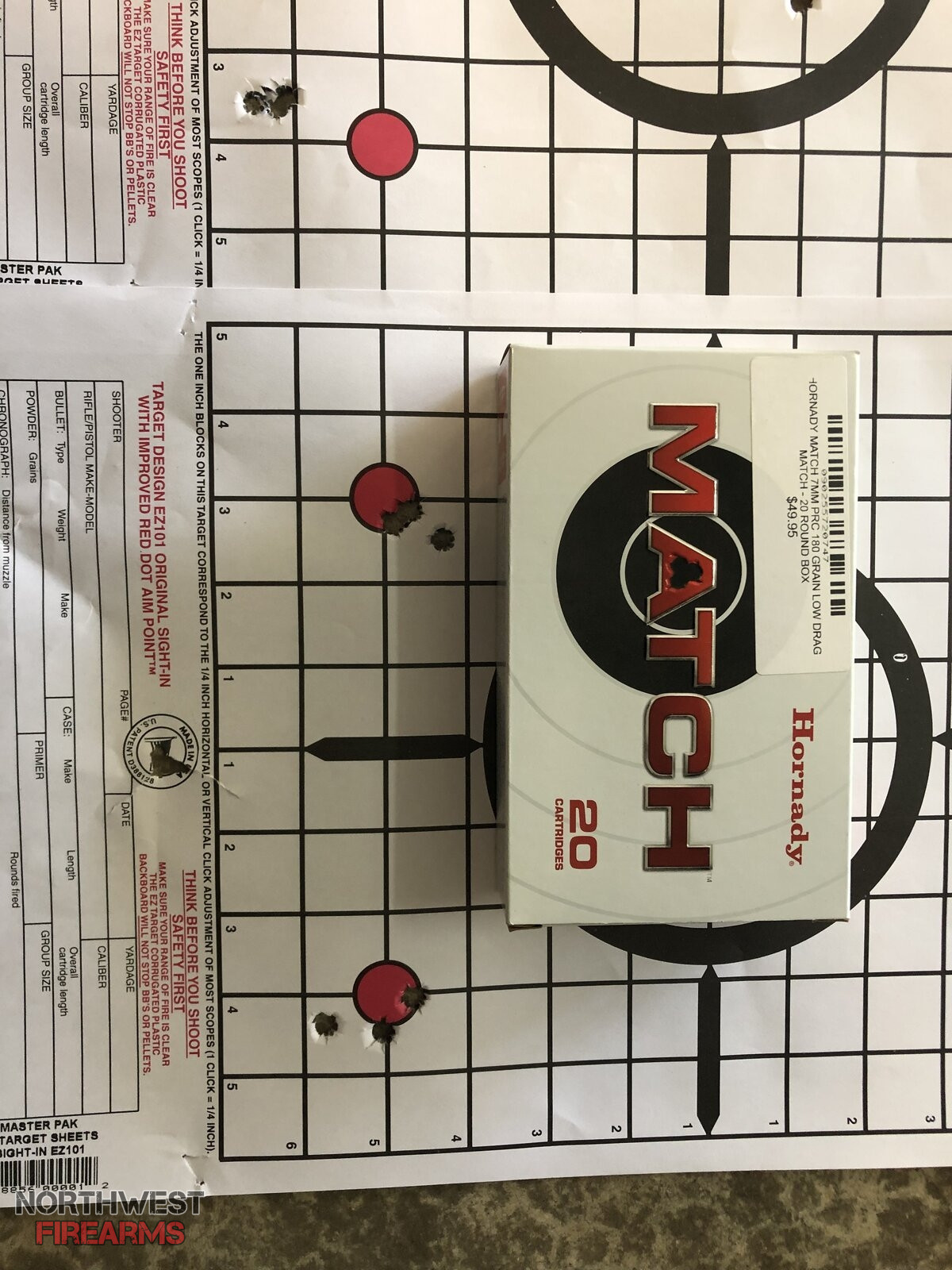

Here's the first three 3 shot groups I had this morning while breaking in the barrel. Not to bad for factory ammo but I think I can do a little better with reloads once I get some dies.
