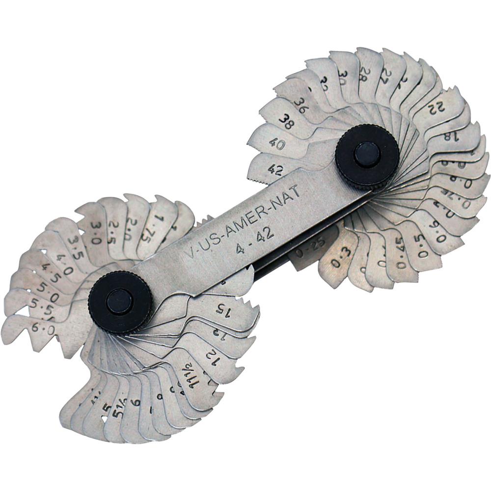

Harbor freight, Lowe's, Home Depot, Amazon all sell thread gauges. That and a set of calibers will get you your thread information.

If you don't know thread gauges, they only speak to the pitch or threads per inch (or MM), you mist measure the diameter to get the first #. Some plus or minus diameter fudge factor required for nut and bolt to actually fit together so in this case "close" actually works..
sans gauges, you can lay a ruler on it, and count the threads in something like a 1/4 inch space (1/2 X 28 would have 7 threads in a 1/4 inch) and multiply X 4 or what ever even # multiple of an inch you measured. you must know if they are metric or not.
Metrics add somewhat a challenge sometimes as some pitch are very close to American gauges so counting may not work. making it best to have the actual pitch gauges to insure there are no stacked tolerances
