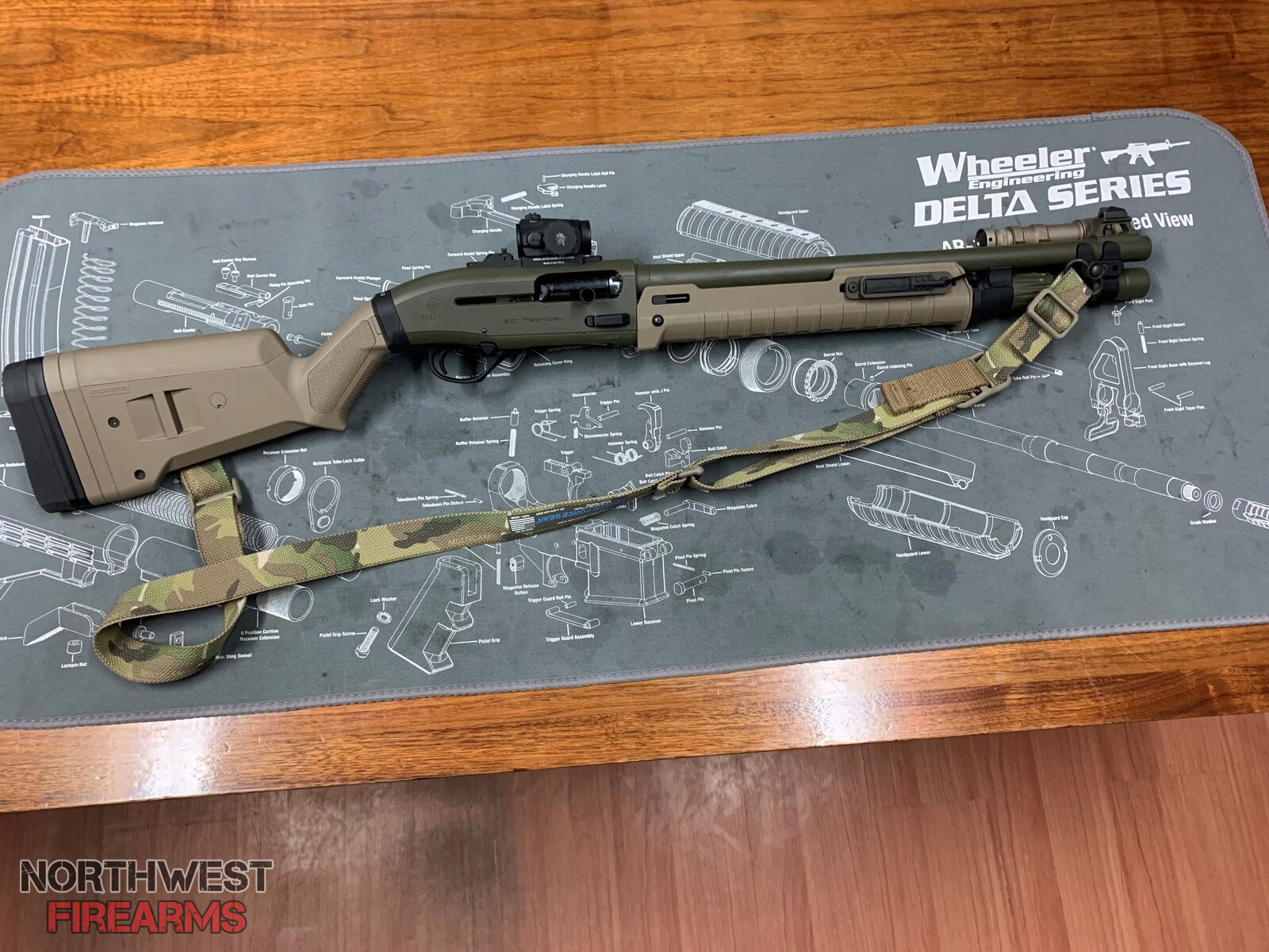

RDS with rifle BUIS on a smoothbore compact barrel for the win.
Titsonritz: "do you even operate, bro?"
F'n COOL. I can't go that hard, without removing the rear sight, but at least now I could put a rail on, since this is drilled to match the rails available for 500s. I think I have an old weaver side mount kicking around and a weaver qwik-point in the parts box (joking)(ok but I do have these)
