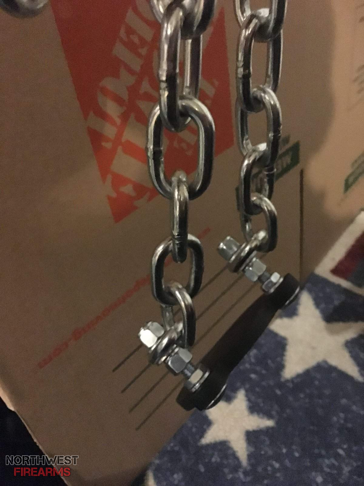

image.jpeg My AR500 steel hang on 2 1/4" carriage bolts. Standard nut against the steel plate, locking nuts and washers to hold the chain at the very end of the bolt.
As you can see, it naturally angles downward... Hope this helps...
