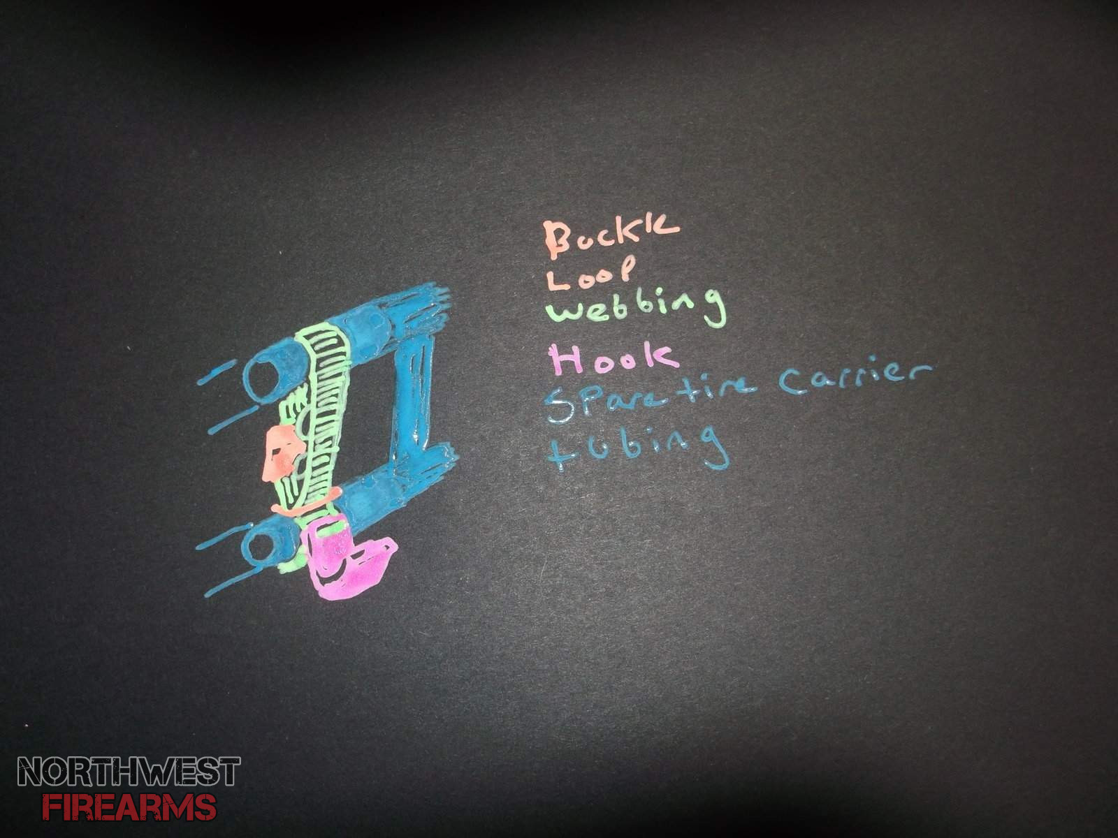

Tell me this is a stupid idea, or not, before I go and get the stuff and sew it up...
1) 2" webbing, heavy duty type (same specs as seatbelt webbing)
2) 2" Ancra flat hook; 10,000 lb break limit, 3,330 lb work limit
3) 2" buckle for quick release
4) 2" steel rectangle loops
Idea; sew up the 2" webbing in such a way, that there are two 1" loops for cross straps (USGI cam lock system), mount to the spare tire carrier with the Ancra flat hook sewn to the main body of the webbing, and 2" loop to ensure that the hook does not go farther than the top of the tubing. Buckle on the back of the body for quick release when not needed.
Basically, for Blitz steel cans with the lip on the bottom, the hook holds it up, and the cross straps holds the can to the body of the webbing, which would be looped around the top and bottom tubing of the spare tire carrier. I realize that it may not be easy to secure it with a lock of some type, but I am thinking it has got to be easier to do than to try and find all the metal hardware and spend as much money on it :rolleyes: Unless someone has a spare jerry can bracket they could let go for $20?

Rough color coded diagram of how it should be set up, without the 2 cross straps that would do the primary duty of retaining the gas can to the strap assembly. Again, I'm not sure if it's a good idea because of the flexibility of the system, meaning it might be prone to excess movement, unless I figure a way to tie it to the two vertical bars without needing excess strap lengths. DSCF1781.JPG

Clever concept, but I wouldn't rely on the bottom lip of the can for support. It doesn't look substantial enough and could (enventually) deform over time and possibly even develop a leak at the bottom seam.
The original Blitz can mount is a similar concept but in steel with a lockable bracket on top that goes on the handle, that was one of the ideas except again the space I have to work with, would require an L shaped bracket to the tubing in order to rotate the can to provide clearance for taillight. Good point on possible failure aspect.

hmm. Specs of the 2" webbing is 6,000lb breaking strength... that just seems burly enough to handle 50 pounds of fuel? And technically the J hook is the metal carrier... but yeah Stomper brings up a good possible failure point with the lip.
Ya see, I'm trying to avoid spending enough money either in custom bracketry or mounts that it would end up being cheaper to just get an ATV hitch cargo carrier ($40 or so):rolleyes:
I mean metal carrier brackets plus custom L bracket and hardware to tubing or custom gas can mount from shop and hardware.. or just a hitch carrier.. which was why I asked if stupid idea to do the strap and hook concept. :) I couldn't find anything like the metal gas carriers at either Cherry City Metals or Burcham's Metals. Lots of flat pieces that could be made into brackets if I have the tools but...

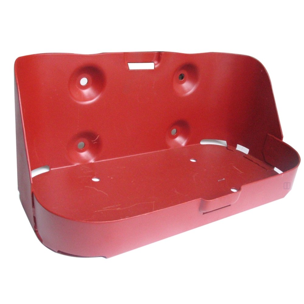

Again like I've said before, if I have a sheet metal brake, I would attempt to fabricate a bracket/holder similar to this; ace-jerry-can-holder-side-close.jpg
Cannot justify $80 for the ace holder, nor 30-+ for custom fabrication work plus cost of brackets, not when $40-60 can get me a hitch mounted cargo carrier that can carry more :confused: and can carry the jerry can
