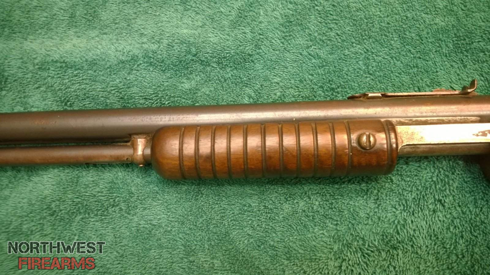

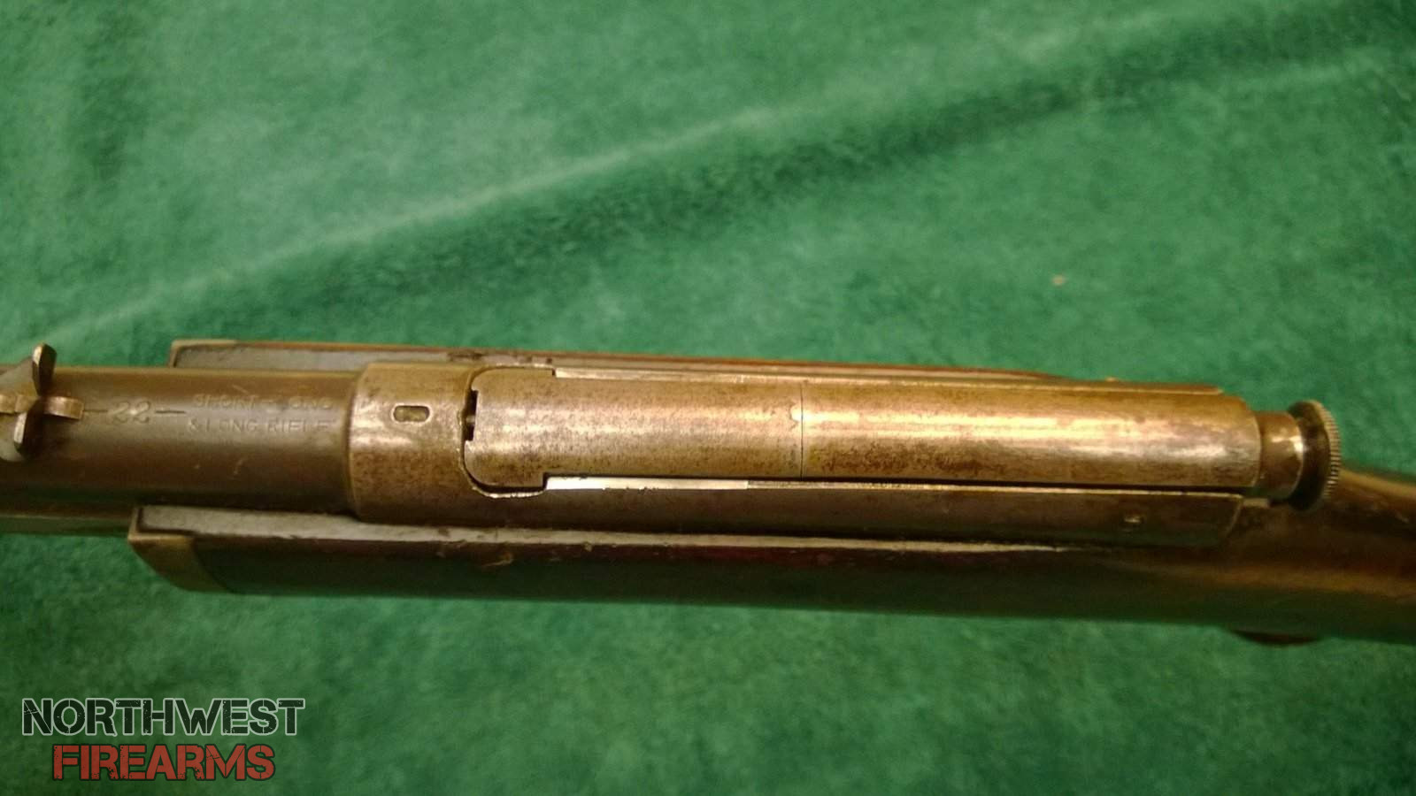

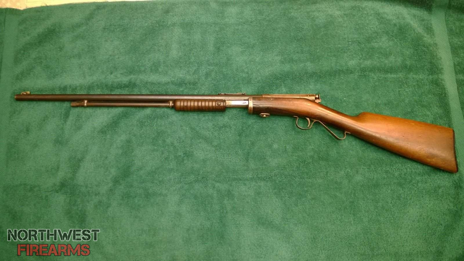

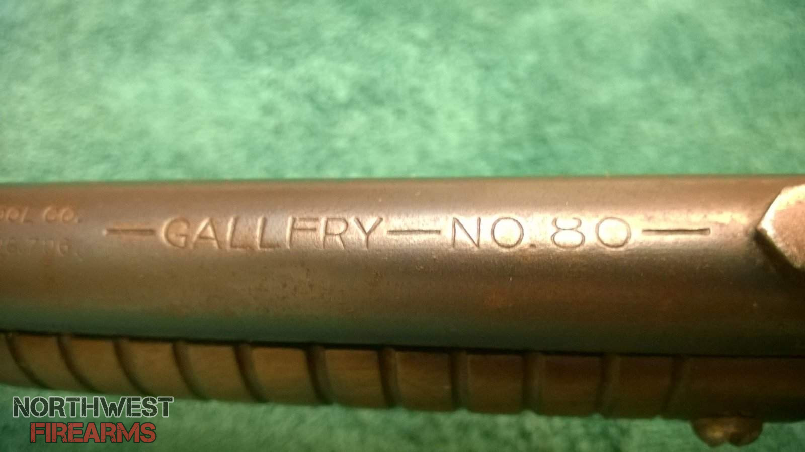

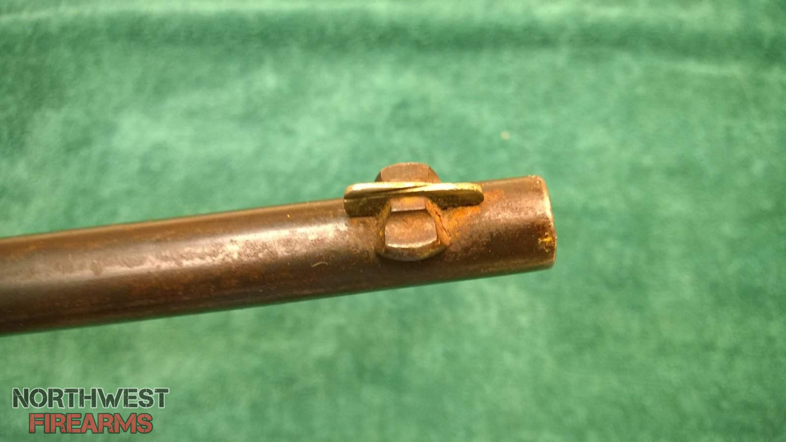

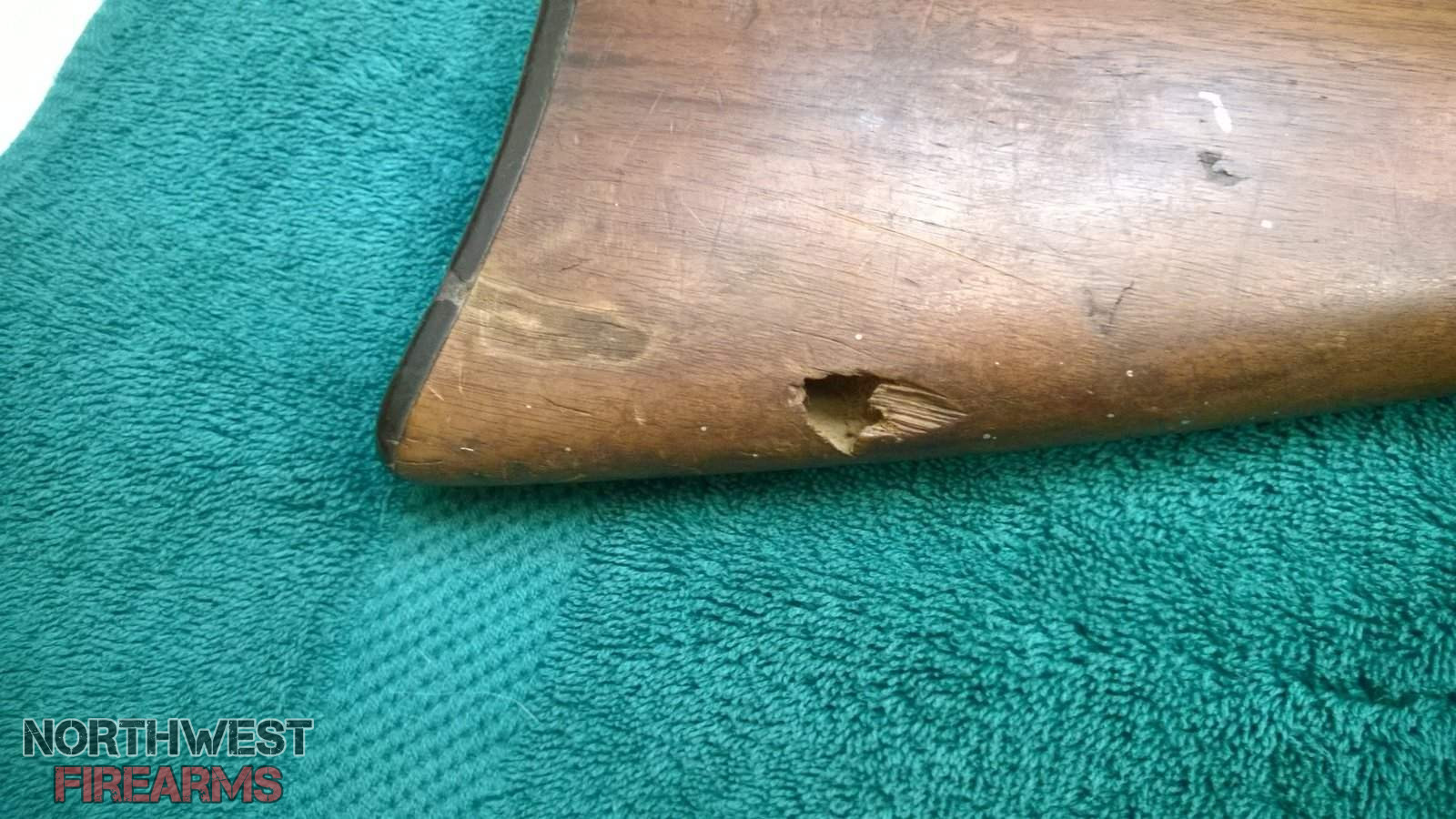

Where to start?? A sad old Stevens Model 80. Even when brand new, somewhere between 1906 and 1910, it was already in trouble. Factory mis-marked as a "GALLFRY" instead of a "GALLERY". Not sure if it's an error or a broken roll-marker, but there it is. One of the holes bored into the butt of it got too close to the surface and has broken through from the outside. It was probably enjoyed for a while but then fell on hard times. Neglect has allowed the outside surfaces to rust a bit. The bore is nothing to write home about. Somewhere along the line one of the fore-end screws was replaced. Hadn't been cleaned until I got it. Still, it is complete and fully functional. Shoots Shorts, Longs and Long Rifles. The picture of the front sight isn't fair, it's a lot nicer than it looks. It has some sort of silver-colored insert in the front sight. The Standard Catalog puts it's value at $125 for parts and $175 in Fair condition. Other than the hole in the stock I think it is a little better than Fair. I'm going to start at $150 and see what happens. Only real trade interest is a Marlin Model 62 in .256 Win. Mag. with cash (quite a bit of cash) from my end. Always willing to listen to offers or other trades.

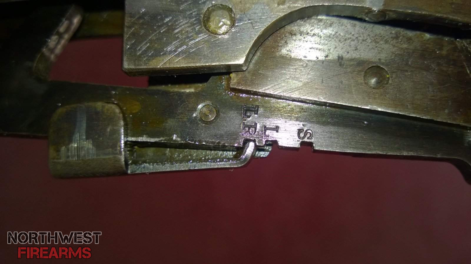

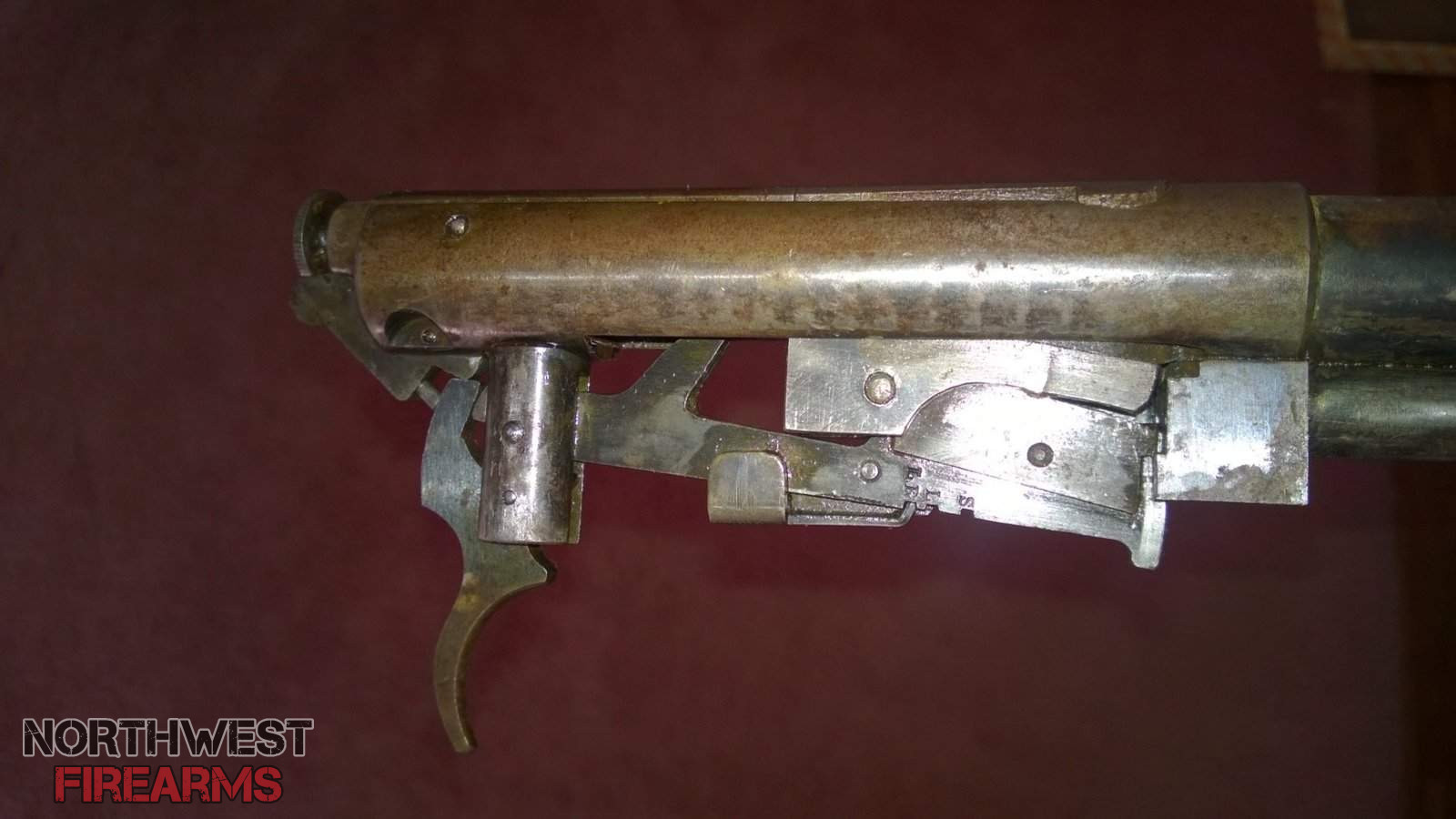

I was reading up on these rifles and they stated that you have to take the stock off and adjust the loading carrier for the different sizes of ammo.
Have you tried to see if this part of the mechanism works?
Here's an excerpt from Rimfire Central.
"Early guns were also offered in 22 SHORT only. Those in 22 S,L&LR had to have a stop on the carrier set for the size that was being shot - they could not be mixed. They also were offered in 25 LONG STEVENS and 22 WRF. The 22 WRF guns were stamped 22 7½ which through some disscussion was thought to be the grains of blackpowder in the load --- but I don't think WRF was ever loaded in blackpowder, so I really don't know for sure why they were stamped that way."
Okay I pulled the stock off and there is a little spring-loaded clip that fits into one of three notches, labeled S, L, or LR. It appears to be the stop for the cartridge as it comes out of the magazine. I will be able to post pictures in a little while. It is intact and moves freely and latches securely into the notches.
