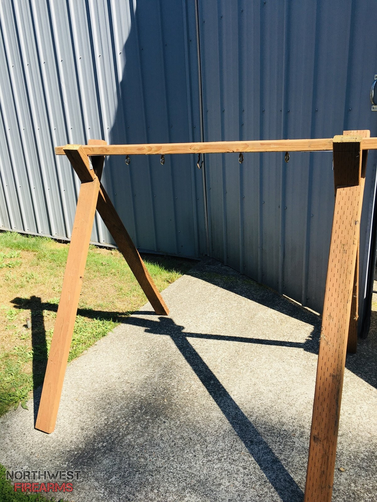

I have some 8" gongs hanging from a wooden saw horse system bought from Harbor freight. Works great and has held up. Also have a couple of shepherd hooks to hang steel too.
That said, looking for something 'taller'. My range requires the bullets impact the berm and the hanging targets/hooks are just too low unless I back it up to the 25ft berm, and that's too far to shoot pistol 'quickly'.
I've seen some stands with a single 2x4 and angled top holder for 1 piece of steel. Concerned those might 'fall backwards' if taller. Just not sure what folks recommend. Or possibly other options. I also considered longer legs on the sawhorse too, but came here for innovation :cool:

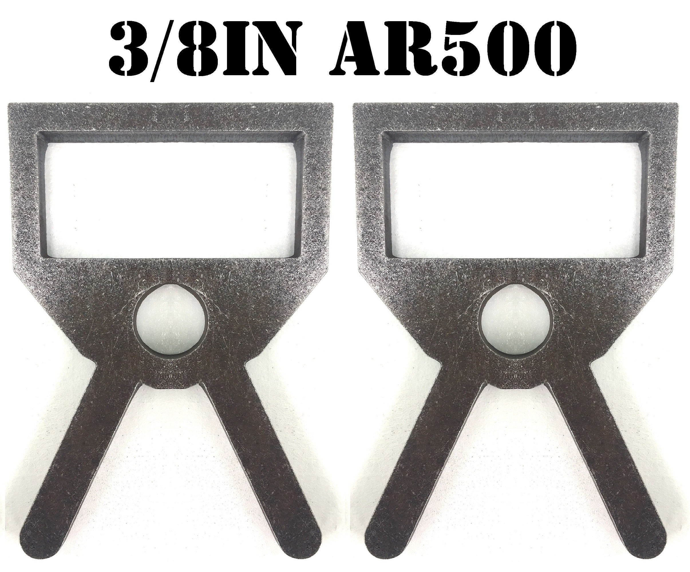

I needed an easy set up/ quick break down system that I could adjust for different heights. I bought a set of these. I am very happy with them.
You attach conduit pipe of any length for legs and a 2x4 of any width. Allows you to adjust the setup to height / width you want, and change it in a minute or two by swapping hardware.
Cheapest, simplest, smallest to pack and lightest solution I could find.

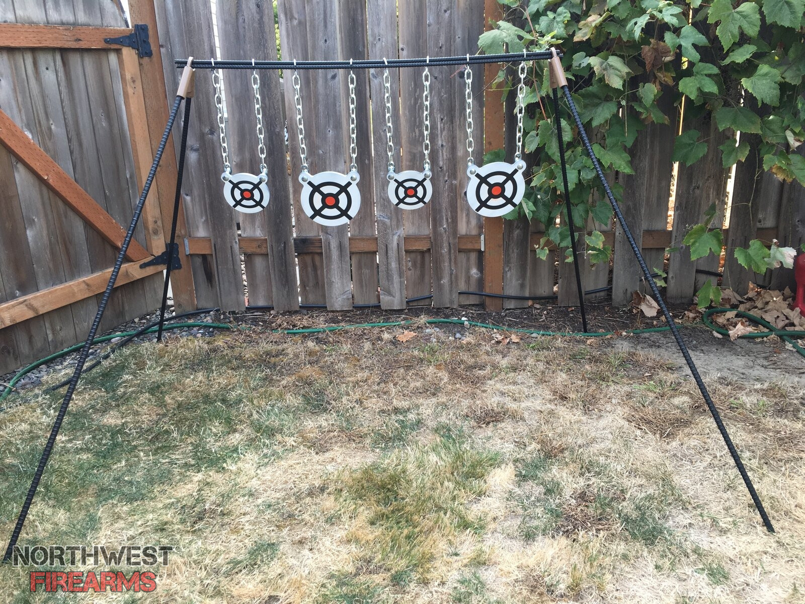

I'd recommend something like this where you can use steel conduit or rebar. I use something similar with rebar, can make it as wide as you need and can hang multiple targets.
My setup…

Thanks for most the feedback, the current sawhorses I have are similar to what everybody's linked with the conduit options. I can easily make it taller with just longer 2x4s, I don't know how you get taller Shepherd's hooks.

I have multiple sets of brackets like @nammac showed and plenty of EMT or old chain-link fence rail.

I like these for what you are trying to do.
There are many like them, but this design is the best I've found.
I like the way the leg tabs come off the top and not the bottom like most. The designer was a thinker.
Gets the 2x4 cross member on edge where it's strongest.
Uses 1" EMT (electrical conduit) for the legs which is the best size for strength to weight. (better than 3/4" EMT and WAY better than rebar)
The bottom holes are for hanging additional weights....I've never had to.
I take 2/ 10' sticks of 1" EMT and cut them in half.
4/ 5' legs work very well, then make the 2x4 however long you want.
I'll sometimes take a 1x6 and tack it to the top of the 2x4 and place jugs of water on it.
