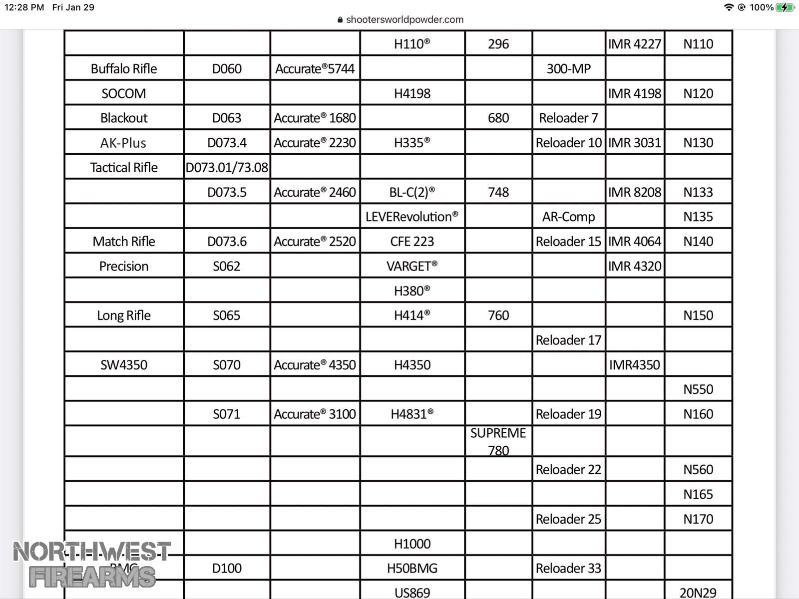

With Varget being so hard to get, has anyone tried Shooter's World Precision Rifle? They bill it as similar to Varget but with slightly better accuracy. I've seen it pop up as available a few times lately so interested in anyone's experiences with it.
One friend used precision powder from them. Close to Varget. Far left on the chart is shooters world burn rate compared to others.
