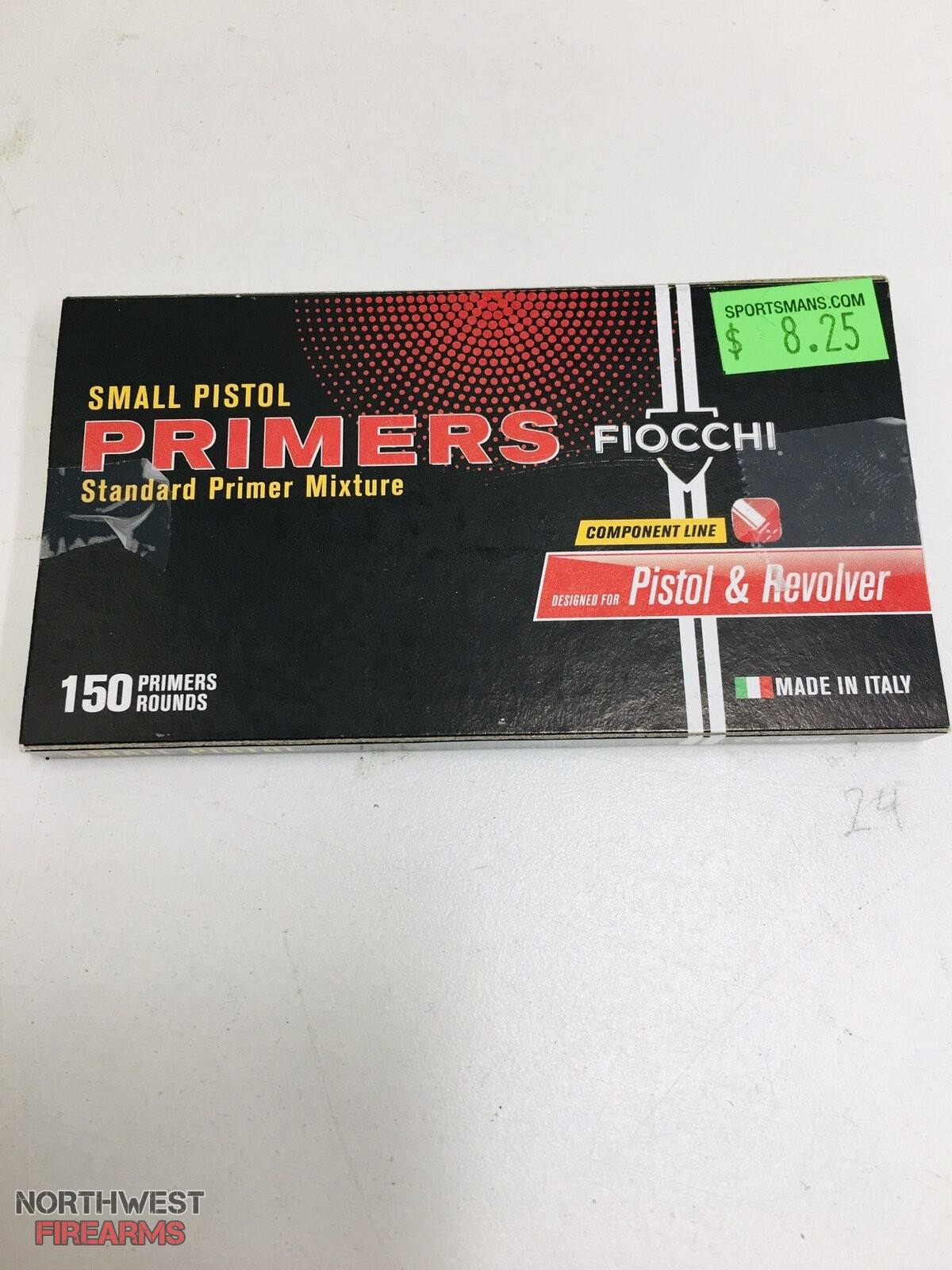

I have been buying them at Sportsmans Warehouse for a while now, no issues. Last week for the first time in years, Sportsmans had a large number of primers out on the shelf instead of behind the counter (still a limit of two boxes).
There were multiple brands and I usually prefer CCI or Federal, but bought the Fiocchi due to being 150 in the box and priced lower per primer.

Forgot to add - when looking at price, the Fiocchi box has 150 primers in it. Price divided by 150 is in line with Sportsman's CCI price for a box of 100.
The only other weird thing is the rows of 18 rows of 8 primers plus one row of six primers instead of rows of ten primers like in a CCI box.
I have picked up about 4000 of the Fiocchi small pistol primers since they appeared at my local Sportsman's Warehouse for $8.25 for a sleeve of 150 (works out to $5.50 per 100) and have loaded at least 500 rounds of 9mm and .357 Magnum. They work just fine and I will continue to grab the two sleeve maximum as long as they are available at that price (or cheaper?).

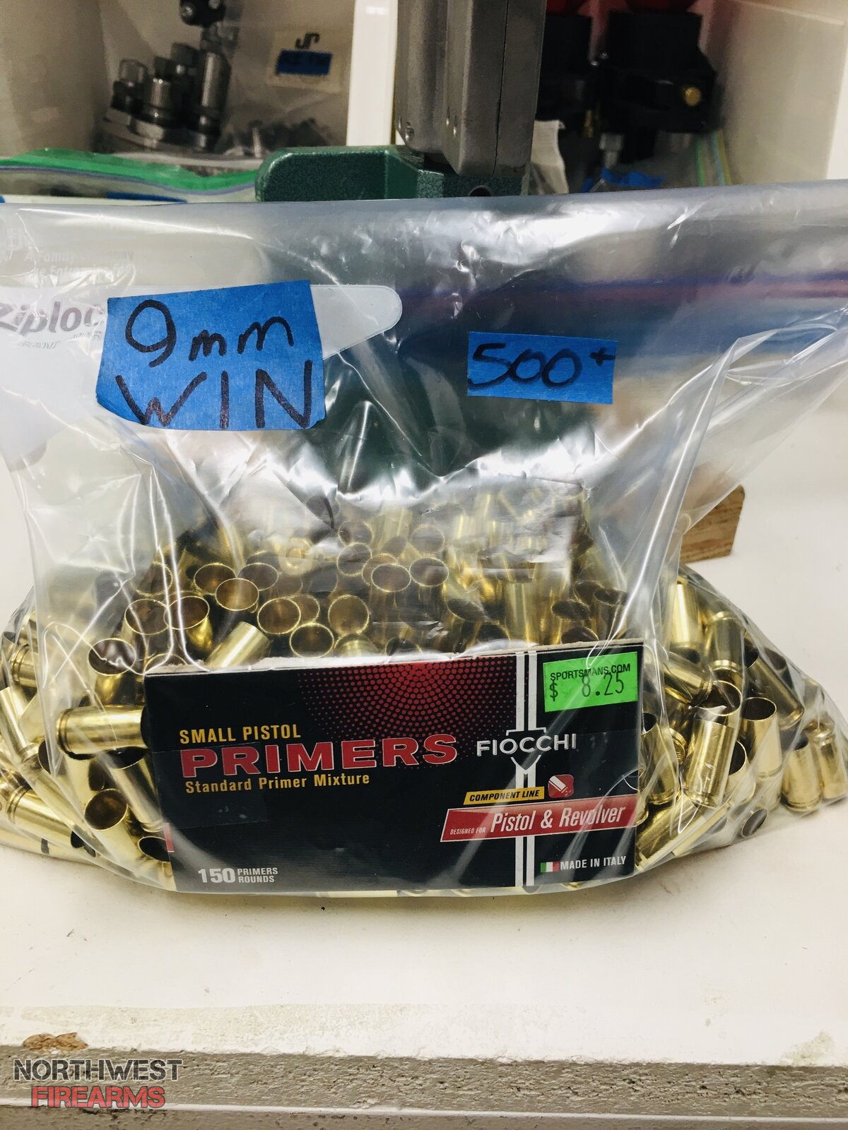

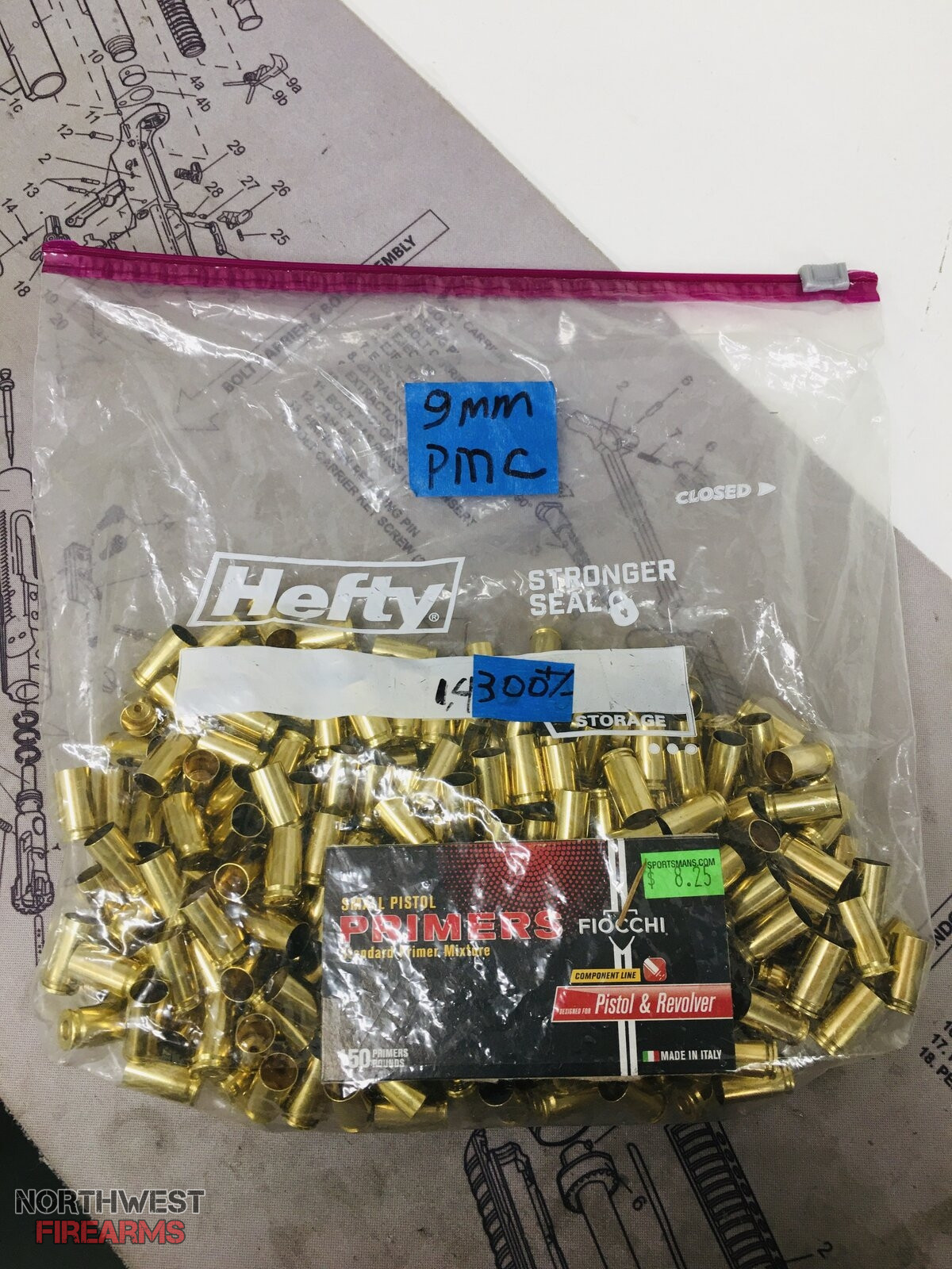

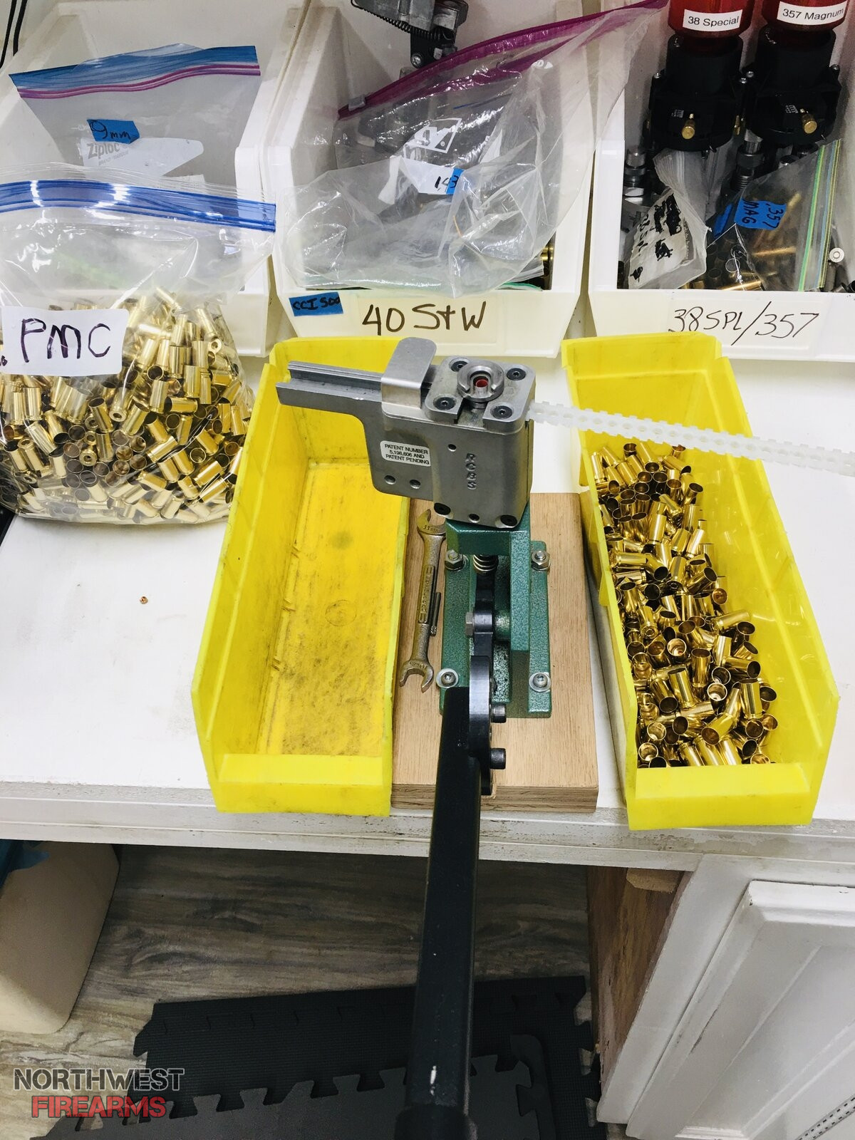

I finally had some time to check out and experiment with these primers. I primed 300 PMC 9 mm cases on the APS. Only had one failure to seat and that was my fault prematurely yankin on the lever, the rest seated perfectly. :p

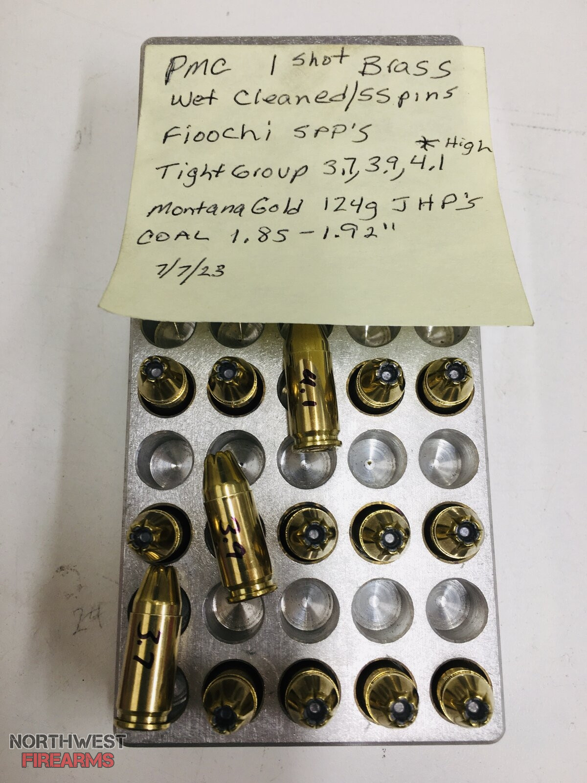

I did a ladder test, once I get some time I will see how they work.
View attachment 1448879 View attachment 1448880 View attachment 1448899
1.8 coal? Or 1.08? Bullets look great!
I got jiggy out in the other day and primeded another 500. There was only 1 primer fubar like always but they worked out fine.
I still haven't got out to shoot the test loads yet.
