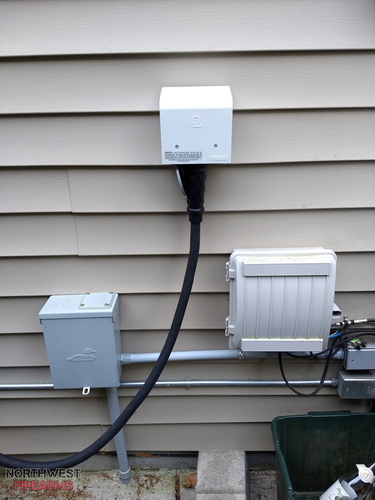

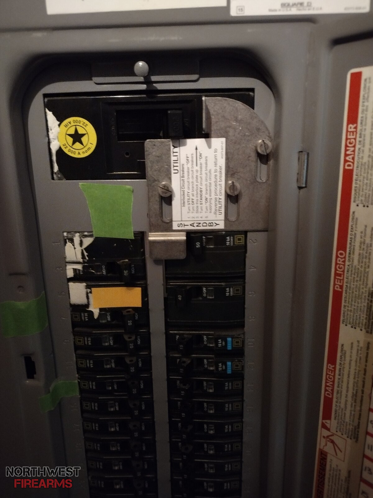

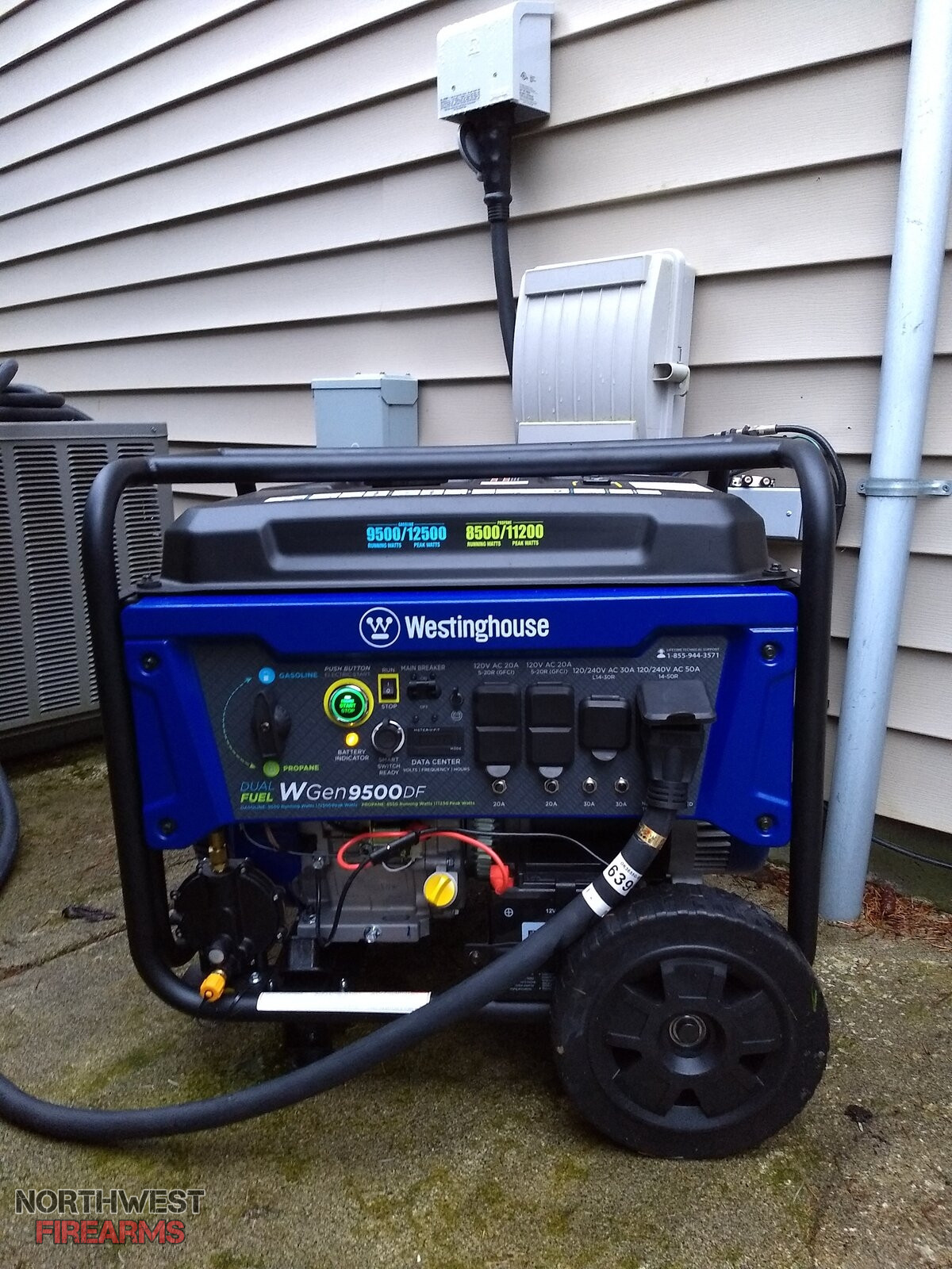

Two years ago I purchased a Westinghouse dual-fuel (gas & propane) 12.5KW generator and wired it into my current breaker box with an Interlock Plate covering the main breaker and a 50amp breaker. When the Interlock Plate is engaged, the main is turned of and only then can the 50amp breaker can be engaged for all of the house circuits
This is a different setup from a Transfer Switch since you have to preselect a set of circuits you want to run with the transfer switch. With this I can use my whole 200amp service set of breakers, then not use high-use appliances like a dryer, AC, etc.
My generator will run my entire house with minimal disruption in what we use. Admittedly, we have a gas fireplace, oven, and hot water heater, but we dynamically choose when to use the high-amp appliances.
The 30ft cable runs to my back patio so I can keep an eye on the generator, since many can't be trusted look-but-not-touch. 😡
I check the generator every 3 months.
View attachment 1895765 View attachment 1895766 View attachment 1895770

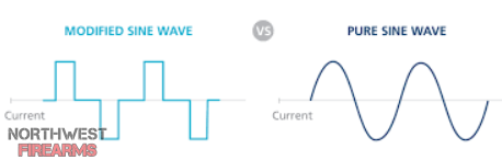

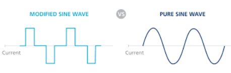

The other consideration is the type and quality of the current output. IE., Many contractor type gensets may still only output a modified sinewave. For an electric motor that'll work, but it's pretty harsh. Electronics... it's never a good thing and some devices won't operate at all on a modified sinewave... or... worst case... be destroyed.
Where contractor type gensets excel is that they are typically quite cheap and the output really doesn't have to be all that clean if you're using electric motors... as intended. Many may have pure sinewave output, but they are notoriously "dirty" simply due to the MFG keeping the costs inline within the "contractor type" generator class.
The additional downside is that they are typically incredibly loud, not very highly efficient and many may not have preinstalled spark arrestors. Although that's not a major issue and can be fairly cheaply and easily installed after the fact. Simply something to be aware of.
That's the "ugly", but even gensets that have pure sinewave output the stability and "cleanliness" of the sinewave pattern can widely vary. How the output acts under load can also "dirty" up the current due to poor regulation. A genset that can maintain a clean pure sinewave at the proper frequency, even under load, is the best option to protect your electrical devices attached to it.
The other option is to place a line conditioner between your genset and electronics, but that adds additional cost (they are NOT cheap) and an additional point of failure. It's generally best to simply go with a genset that will produce the cleanest output from the get go.
Just to illustrate the different sinewaves. The "slamming" up and down of a modified sinewave is what creates large amounts of heat in your electronics vs. a pure sinewave. The most notorious appliances that will either not run at all on a modified sinewave are cooling compressors (fridge/freezer) and microwaves. Some microwave magnetrons won't fire at all... OR... can be immediately burnt out.
Fine electronics, like computers, etc, are also very susceptible to an early death on "dirty" current. Most inverter gensets these days do proved pure sinewave output, but again, there can be a big disparity on how "clean" and stable the output regulation is.
