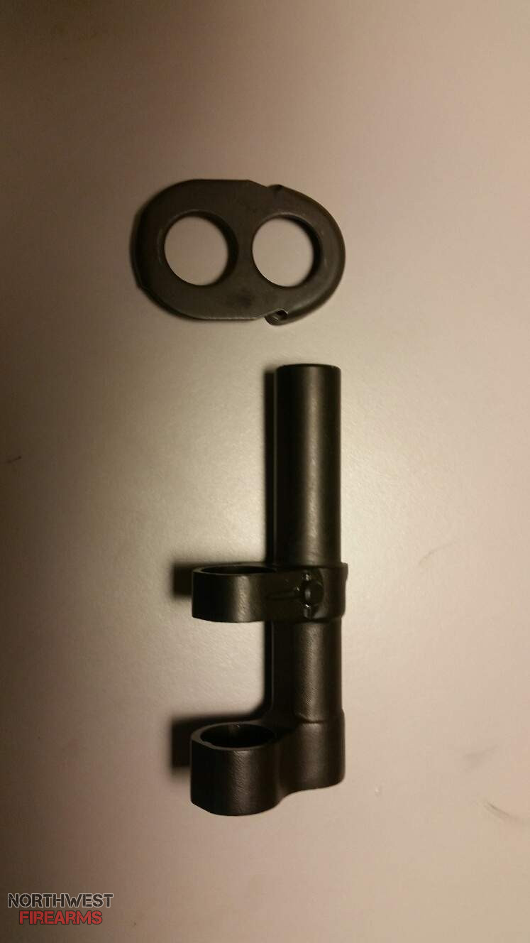

What does it mean when you state " unitizing the gas cylinder" what actually occurs. Before I do it I want to understand what it is.

The stock M14/M1A gas cylinder comes in two pieces: the cylinder itself and the front band that goes on the end of your stock.
By making the assembly one piece you are positively affecting the harmonics of your free floating barrel since (unless it's bedded) the barrel only touches the receiver and the piston assembly. There are two ways to unitize the cylinder: the Army AMU method using screws or the Marine Corps welding method. I chose welded, though many prefer the screw method since there are supposedly stories out there of welds breaking. I personally don't think that's very likely.
In any case, a one-piece unitized gas piston assembly will make for a more accurate M14/M1A and is de rigeur equipment for any kind of serious marksman who uses an M14/M1A/M21.
