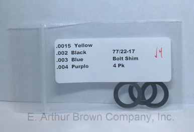

My strong recommendation as a partner improvement to your rifle (and MUCH cheaper) is to consider bolt shim washers.
www.TriggerShims.com
These "tighten up" the mating surfaces of your two-piece bolt, headspace becomes more consistent, and in my experience with two rimfire 77's and one centerfire (77/357 converted to .256 Winchester Magnum), accuracy improvement is easily measurable.

I've done the Volquartsen sear and spring and the bolt shims Spitpatch linked in his post on a 77/44 and a 77/357. Both made a noticeable improvement for these rifles and the cost was reasonable.
The factory triggers weren't awful, but a bit heavy with more creep than I wanted to deal with. The Volquartsen sear and spring helped this. The bolt shims seemed to help with accuracy, although I didn't do significant testing before and after.

I've ordered a Basix trigger from Gunbroker and a bolt shim kit from EABCO (thanks to SpitPatch for that piece of advice). My bolt has a noticeable gap and I did have one round fail to fire due to light firing pin strike.

Bolt has now been shimmed and Basix trigger fitted. Yet to be tried out at the range however the difference in the trigger with just dry firing (on an empty case) is phenomenal!
No creep just a crisp break with the trigger weight a lot less than what it was. I'll take an allen key when I take it to the range to adjust the trigger, if it's needed.
