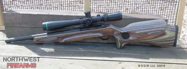

The heart of any .22 rimfire lies within the barrel. As was mentioned above, KIDD and Fedderson are two of the "good" ones, the Lilja reins supreme. Tony Kidd guarantees his barrels to shoot ½ inch groups at 50 yards. This 10/22 uses a KIDD barrel:

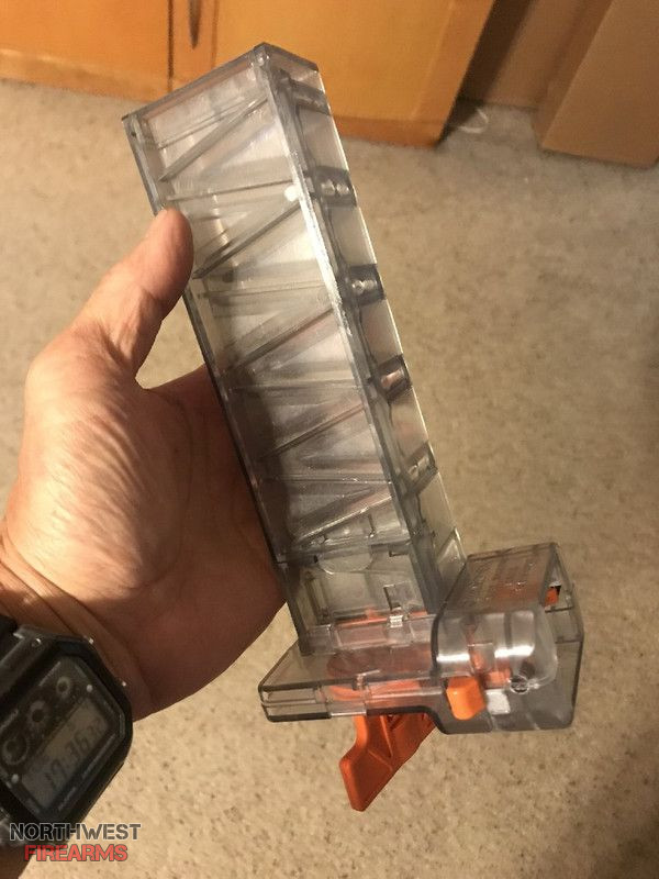

I bought the standard bull barrel target 10/22 that Ruger put out. Great shooter, but what really upped the fun level is the HCMag set up. It makes loading magazine so quick and easy. Literally dump the .22 bullets in a box and shake it, then slot them into clips that easily slide into mags at the range. Unfortunately, not sure if they are still doing them as the online store they set up is "sold out".

HC Mags HC3R Tactical Pack
I use this to load up hi-cap Ruger Brand magazines (in my case BX-25).
Champion brand....
You will need to specify which brand of mags you're gonna be using them with and they aren't of much help with the factory 10 round Ruger mags.

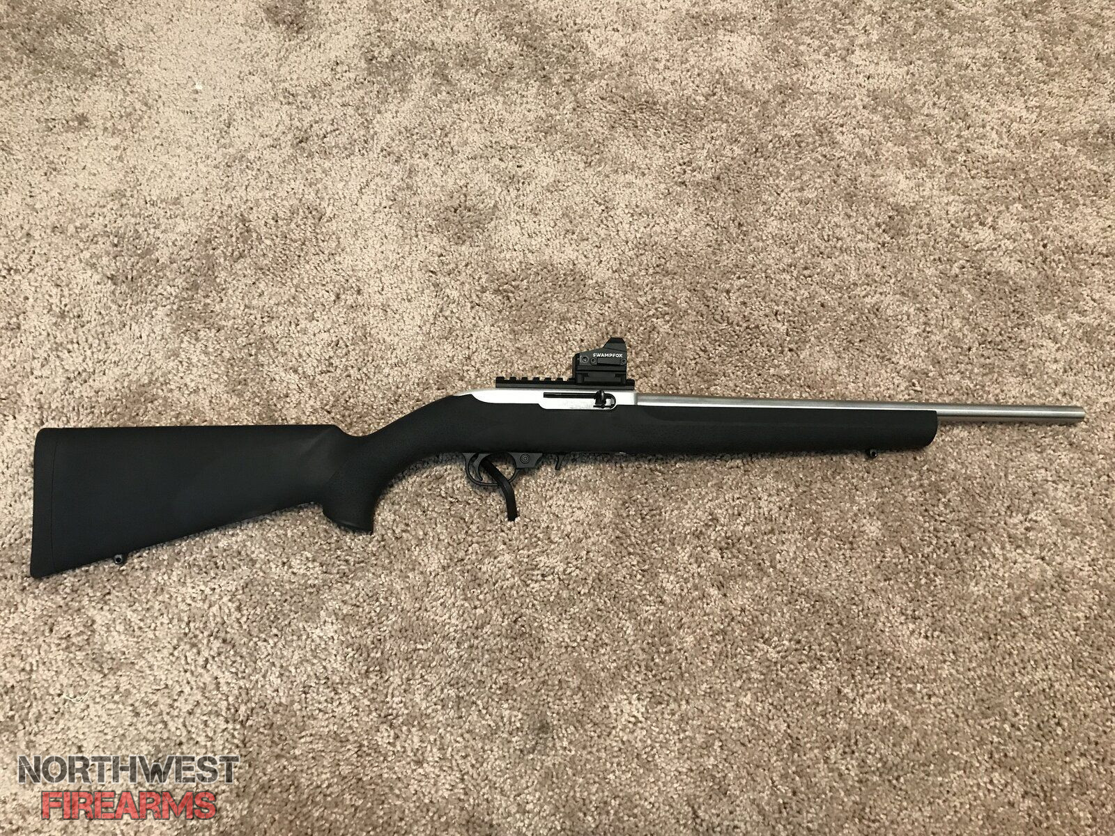

this one has an old Volquartsen SS bull barrel with a 1:9 twist and Bentz chamber
built to shoot heavy 60 gn subsonic bullets
Tony Kidd classic red trigger
Hogue overmolded stock
it is capable of dime sized groups at 50 yrds with subsonic target ammo

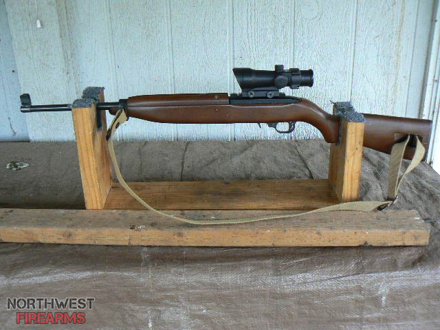

Dude... that is awesome. Did you fabricate the stock yourself?
I wish
they are sold by Eabco
the M1 Carbine was the first rifle I ever fired back in '64 at Military Summer Camp
just like an old friend
