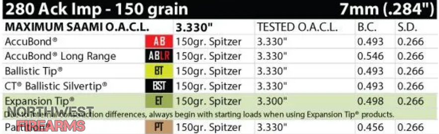

Almost no monolithic will have BCs commonly found in target bullets. They are too light for their length. Being longer lead-core bullets of the same weight, they can also get into stability problems that don't seem to jive with their weight.
I think the chart below from Nosler demonstrates that. The Expansion Tip is Nosler's monolith, so having the same overall weight at the other bullets must be physically longer. Even though it is longer, it's BC is only slightly better than most of the other spitzer/boattails.

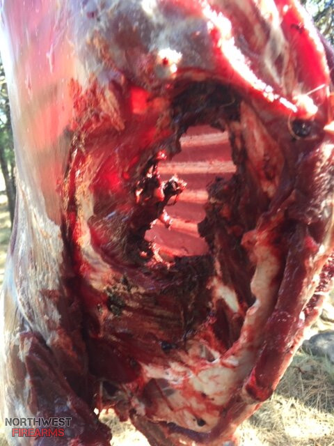

When it comes to the 25-06, IMO, using anything more than 115gr bullets becomes grounds for a 270. A 270 will push 130s as fast or faster than a 25-06 with 115gr bullets. It may be possible with a longer barrel and a powder like RL26 to get the heavier bullets going a bit faster, but I don't think it makes sense. The 100gr copper or 110gr bonded bullets are just fine for anything up to elk.
I think I posted this before. This little buck was killed with my 270 and a 130gr TTSX. I shoot 140's in my 7mm.
