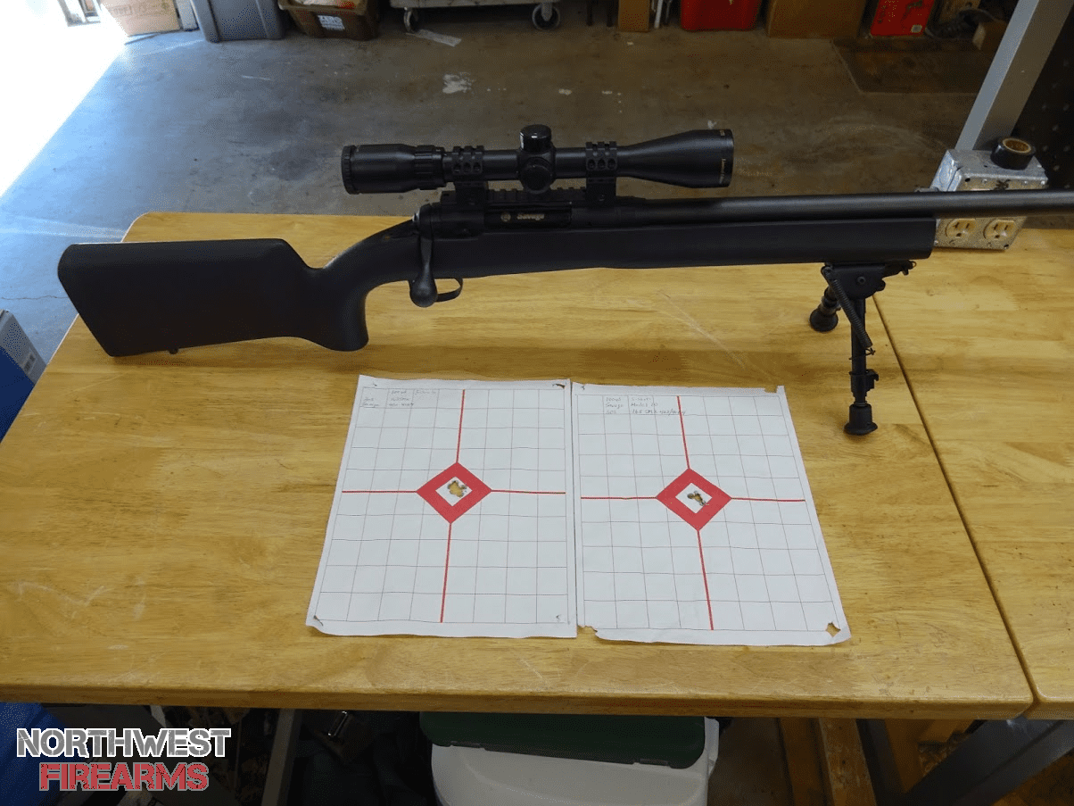

Savage 308 Bolt gun. Nothing special stone stock. I will have to take some picks of my 200 yard targets.
Here are some 5 shots @ 100 yards. These are IMR 4064 and 168 SMK
I certainly wouldn't complain about those!
