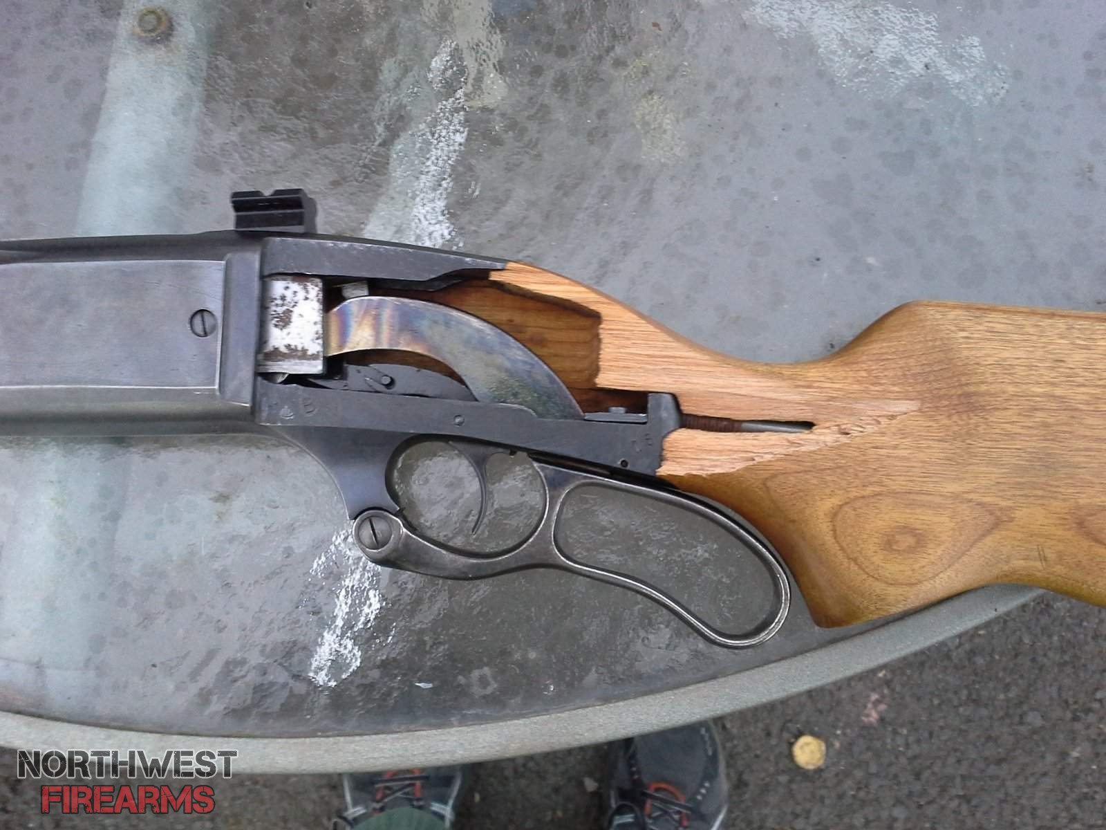

Here the aftermath of a coworkers reloads! I don't know if was caused by an overcharge or wrong power (which is what I suspect)
