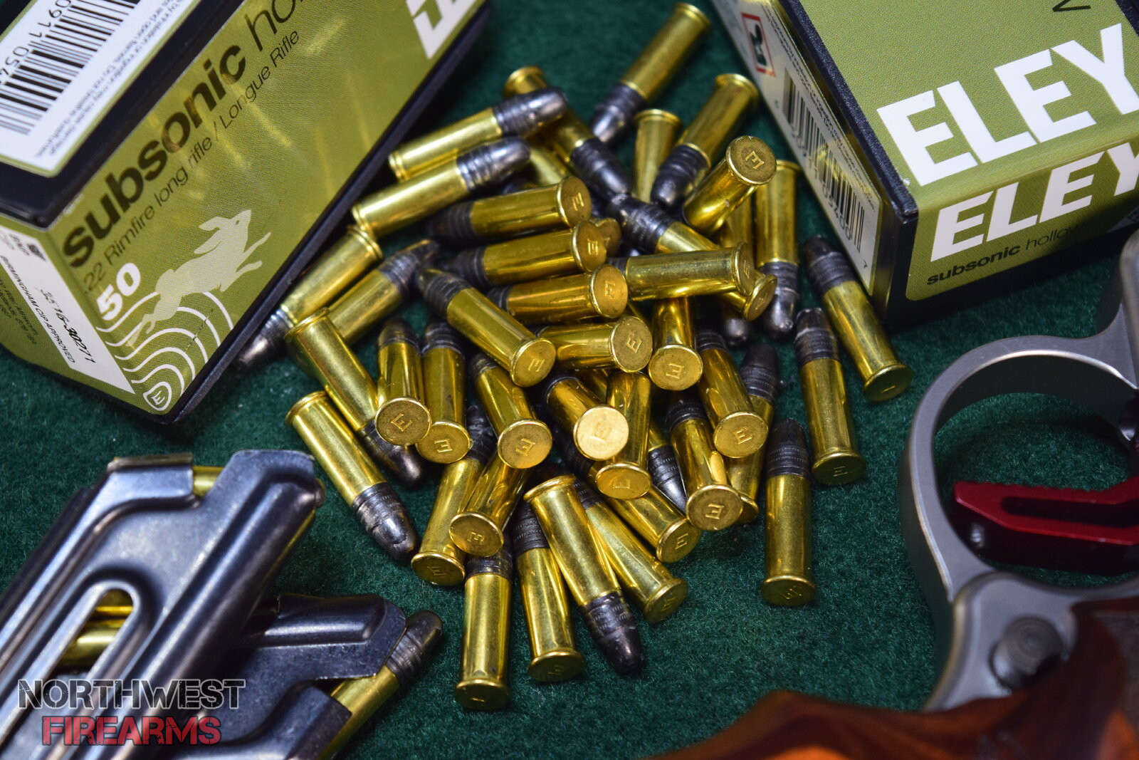

I got turned on to Eley branded .22LR & haven't used much of anything else since. 1000s of rounds in rifles and pistols and never a failed pew pew pew (yet).
