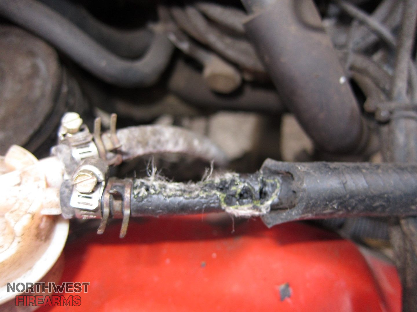

So I went out to drive my old Toyota truck today and it wouldn't start. Just cranked and cranked. So I start checking ignition, distributor and plug wires. I finally got over to the fuel side and saw my rubber fuel line had been eaten in half by what I'm guessing was a rodent. New fuel line and rat trap were installed.

I had a friend come back from Hawaii after two weeks and had her engine wiring in her 4runner eaten.
it was all her fuel injector wiring.
I took her to Toyota who said all they could do was sell her a a complete engine harness for $1000.
So I spent over two hours dismantling parts and pulling out the damaged harness, cut, stripped, and soldiered it back together.
ran like a Toyota for another 6 years until she sold it. Probably still running the same
