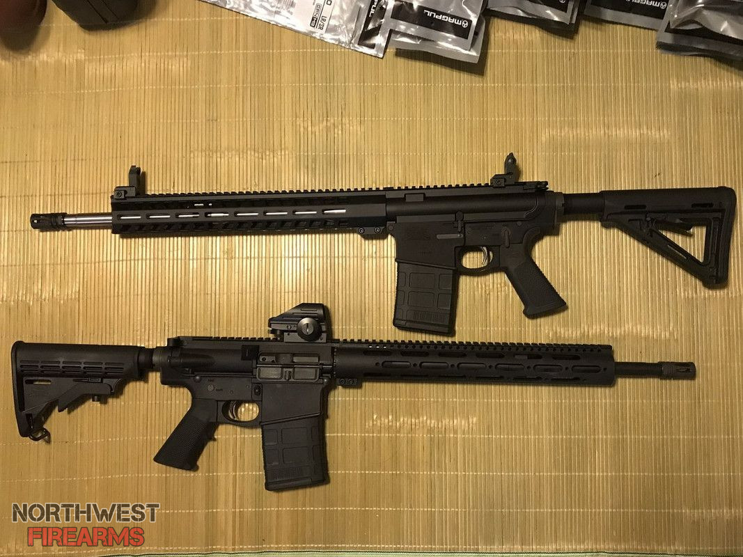

I picked this up right about last Christmas. BTW, it was purchased right off of the classifieds here at NWF.
The SS bbl version is built on a 2nd gen lower with a 3rd gen upper. I haven't fired it yet.
The other one (in all blk) is a 2nd gen rifle. It has been fired. Though I still like my M1a better. LOL.
Last pic is of Pmag 20 rd 3rd gen magazines. I picked up a bunch of these from Brownells just before the Coronavirus panic.
Aloha, Mark
