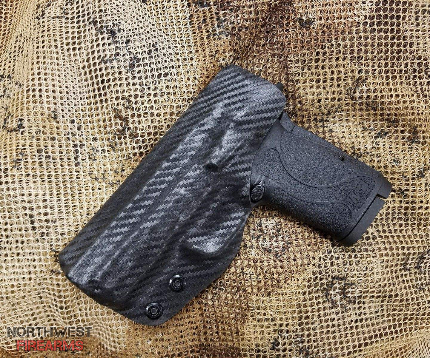

Well, I tried a few things experimenting with my mag problem. Finely came to a conclusion on what is causing the problem with my mags dropping out. It was a holster problem. The IWB kydex holster I was using covered the mag release button and was pressing up against it just enough to release the mag. I had a couple of others including one that was shaped so that the button was not pressed when in the holster. Tried it and haven't had the problem since.

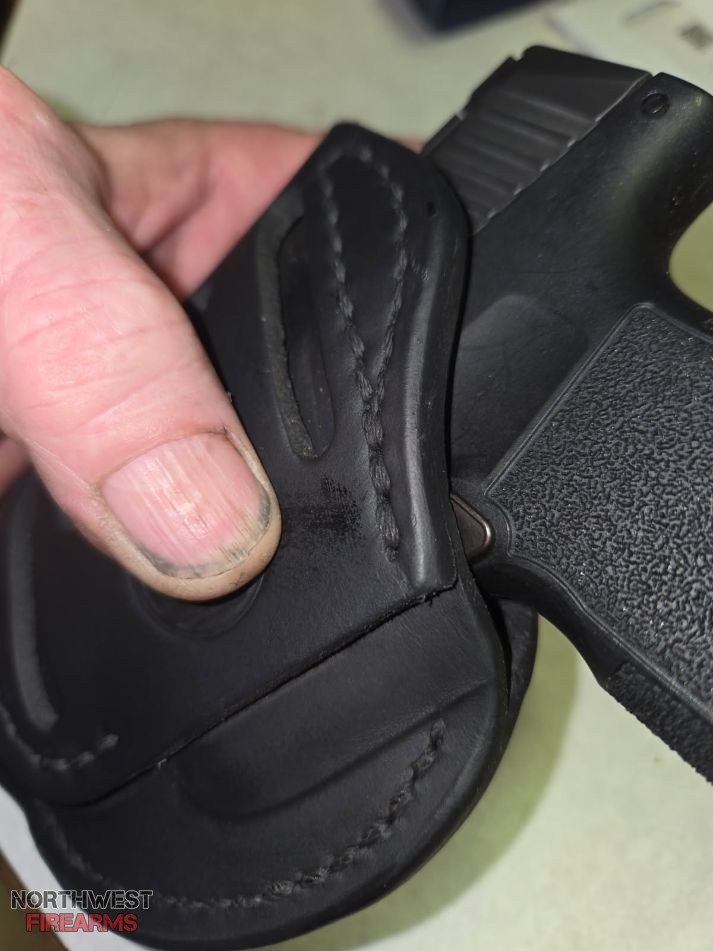

Just now researching this issue for one of my kids. She carries IWB. Her holster allows the mag release to be pushed THROUGH the leather sweat shield. The only fix I've seen is filing down the proud section of the button.

Sounds like a holster problem, not a gun problem. I don't think I would modify my gun to meet the needs of the holster. Has she contacted the holster maker? She might start there.

I just experienced the same issue with a Sig 365. At first I thought I'd bumped it with my thumb, but found the holster covers half of the mag release and can flex enough to trip the release.
