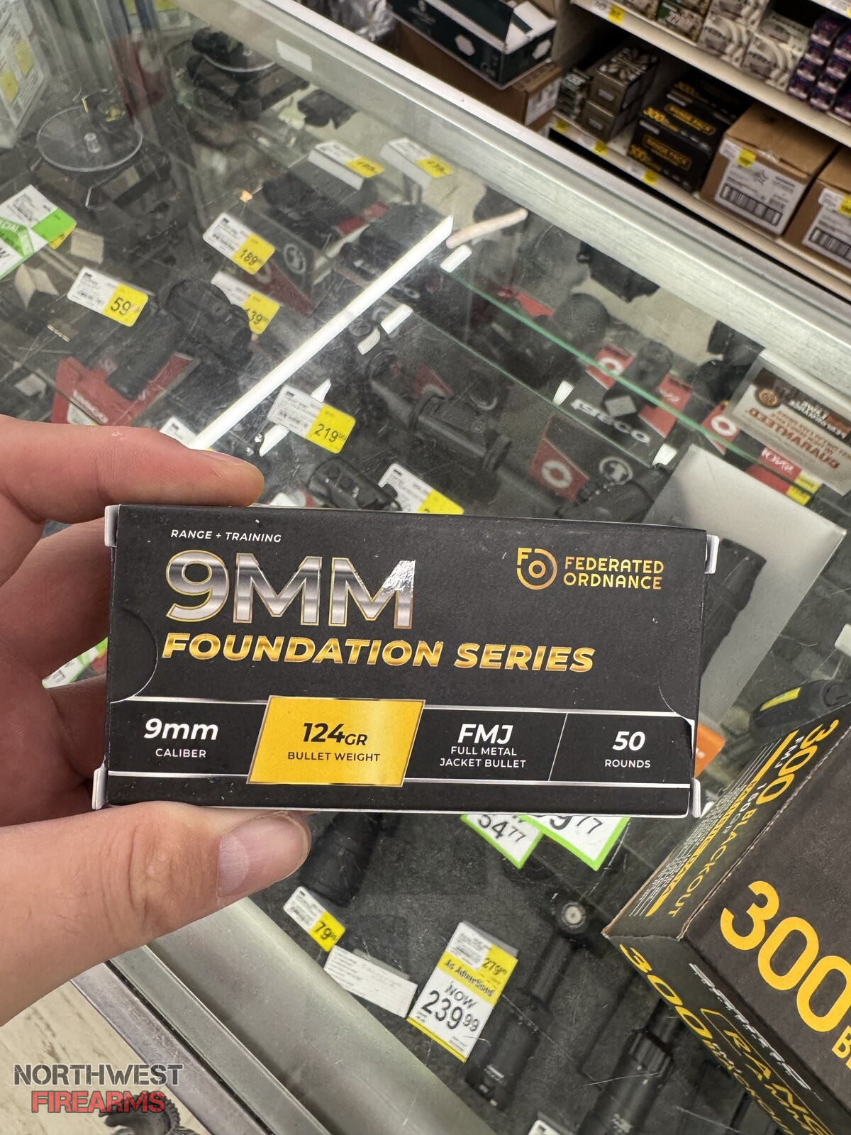

So earlier today me and my buddy went shooting and while he was letting off a magazine the mag blew out the bottom of the gun. So naturally I took the gun, I tried to clear the weapon and the bolt was stuck in the closed position. Took quite a bit of force but I was able to release the bolt and eject the spent casing. Any idea what might've caused this? Maybe it was a squib load? Idk but I took the gun apart when I got home and there's zero damage to the bolt head, locking peice, the entire upper is intact, no bullet stuck in the barrel etc,. However now my problem is that my undamaged magazines aren't locking into the gun properly. Smh I'm going to take it into my gunsmith in the morning but I just wanted to see if anybody could shed some light onto this for me. Thanks.

Good idea, factory rounds from bi mart. I was hoping the gunsmith would give some validity to our theory here, but your saying to contact the manufacturer before?
Yep- if your smith is just going to look at it, then no harm, but you don't want to do anything to the gun that would alter its "after accident state" . But whatever he thinks, the manufacturer will make their own determination anyway.
Hopefully you have the casing, what ever is left of that same ammo and the box that may have manufacturing/ batch numbers on it.
I would ask which factory rounds. I've come across some non standard stuff at BiMart in 308 that my bolt rifle, Ruger American, doesn't like. The bolt drags, won't seat, etc. The AR10 on the same ammo has no problem.

Yknow usually I do shoot suppressed with my huxwrx flow 9k ti but this specific time I was shooting it unsuppressed. So yea I usually only use flow through cans.
