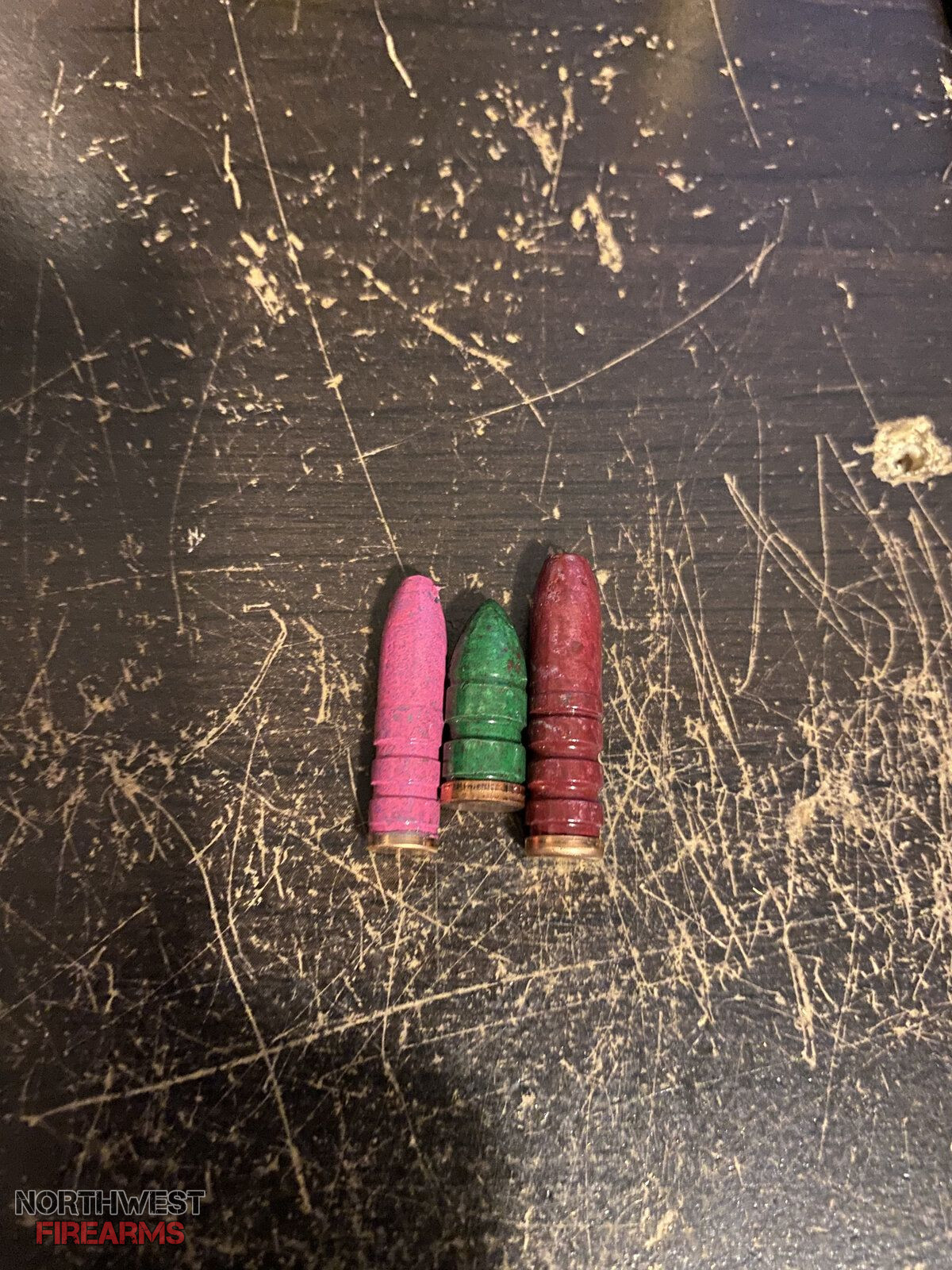

I powder coat and then put the check on during sizing. Works great.
