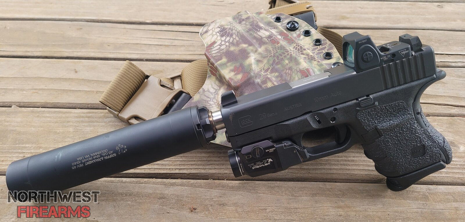

With the arrival of my threaded KKM barrel, my Tactical-Teded out G29 Gen4 is now complete.
This now sports the following:
RMR 3.5 MOA, Slide milled by JaegerWerks
KKM Stainless threaded barrel
Streamlight TLR-7a
XS Big-dot suppressor sights
24lb recoil spring
3lb connector
Talon Grips
Griffin Armament Revolution 45 in the short configuration.
I did some chronographing and sound measurement today. All shots were with Georgia Arms 180gr FMJ 10mm advertised @1100FPS.
Stock G29 Barrel:
FPS Db
1. 1024, 120.3
2. 1031, 120.4
3. 1013, 120.2
4. 1044, 120.6
5. 1003, 120.3
KKM Barrel, unsupressed:
FPS, Db
1. 1118, 120.3
2. 1111, 120.3
3. 1114, 120.3
4. 1111, 120.3
5. 1092, 120.2
KKM Barrel w/Griffin Rev45k:
FPS, Db
1. 1103, 116.4
2. 1158, 115.0
3. 1117, 116.5
4. 1149, 117.0
5. 1138, 116.8
Cool - the stock slide stop on Glocks are insufficient to my liking, I always add the extended upside down triangle version. Your G29 is pretty fancy.

BTW, I really like Talon grips and have them on my EDC, but I really prefer the old school sandpaper grit ones. I'll probably order another set and use it as a stencil with a roll of skateboard tape from Amazon. FWIW, I also put strips of skateboard tape at contact points on my slide as well.

Cool gun! Great FPS #s, but remember for sound u have to have an impulse sound meter with ultra fast rise time and test to mil spec protocols (which is easy to do). The peak of the sound only lasts around 20 millionths of a second and unless you have a meter that can catch that (most don't) u won't get accurate sound numbers as it's missing the loudest part.
9mm unsurpressed is somewhere around 160 db and most good suppressors can drop that by 30-34ish db when shooting subsonics. I don't know what typical 10mm numbers are but I assume they are higher than 9mm.
Good info on the sound meter. This was some meter my wife had bought a while ago to do something for dog sports. I'm sure it's not mil-spec or anything certified. I just wanted to get an idea of shot-to-shot consistency.
I had it mounted on a tripod, ~24" from my ear.
I was really happy with the increased speed with the slightly longer KKM barrel though. That made more of a difference than I expected.
When primers become available again, I'll run some of my favorite handloads though it and test again.
