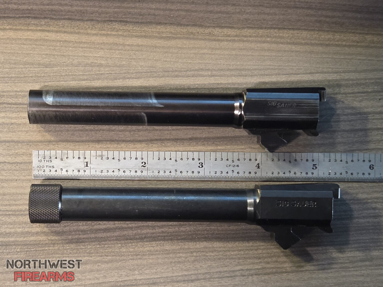

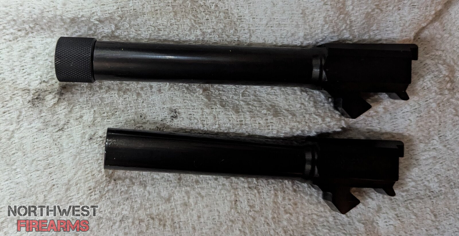

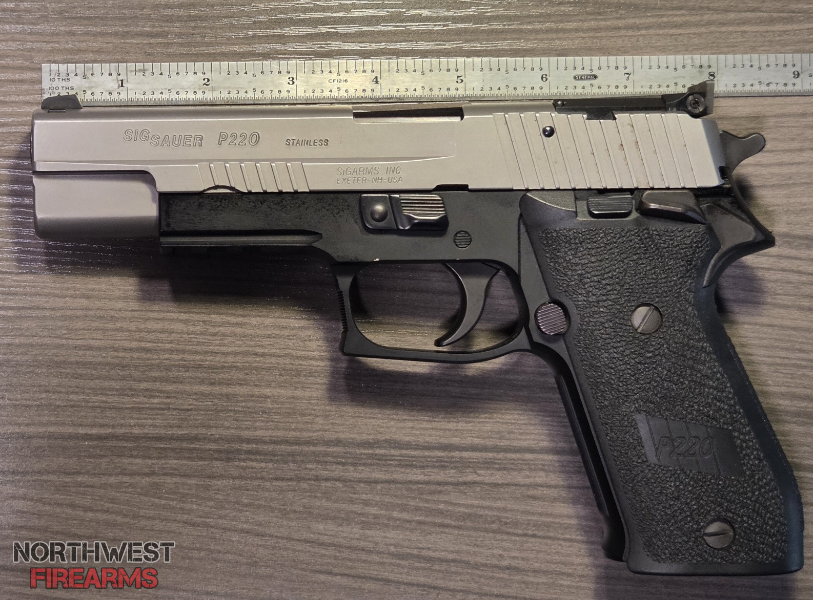

I have a P220 and I have two barrels: the original and a threaded. The threaded was the longest one I could find, 4.9", but it doesn't protrude from the more than 1/8". Turns out it is only slightly longer than the stock barrel. I did some searching online, but there is very little info I could find on the various slide lengths and barrel lengths. I'm assuming I could get a slightly shorter slide, but I can't find longer barrels, and I can't really buy threaded in WA anymore anyway, so I think I'm stuck. Is there a way to find out what slide lengths are compatible with which barrel lengths?
Not sure how to measure the length, but here they are side by side
Original barrel is marked .45 Auto, threaded is marked .45 ACP
A thread adapter made by a machinist/gunsmith to extend the barrel, or try to find one online.
I had Tornado Technologies extend my stock HK P9s 9mm barrel and you could barely see where the factory barrel met the threaded extension.
That appears to be a Super Match Two-Tone SAO… Nice! They have 5" barrels.
