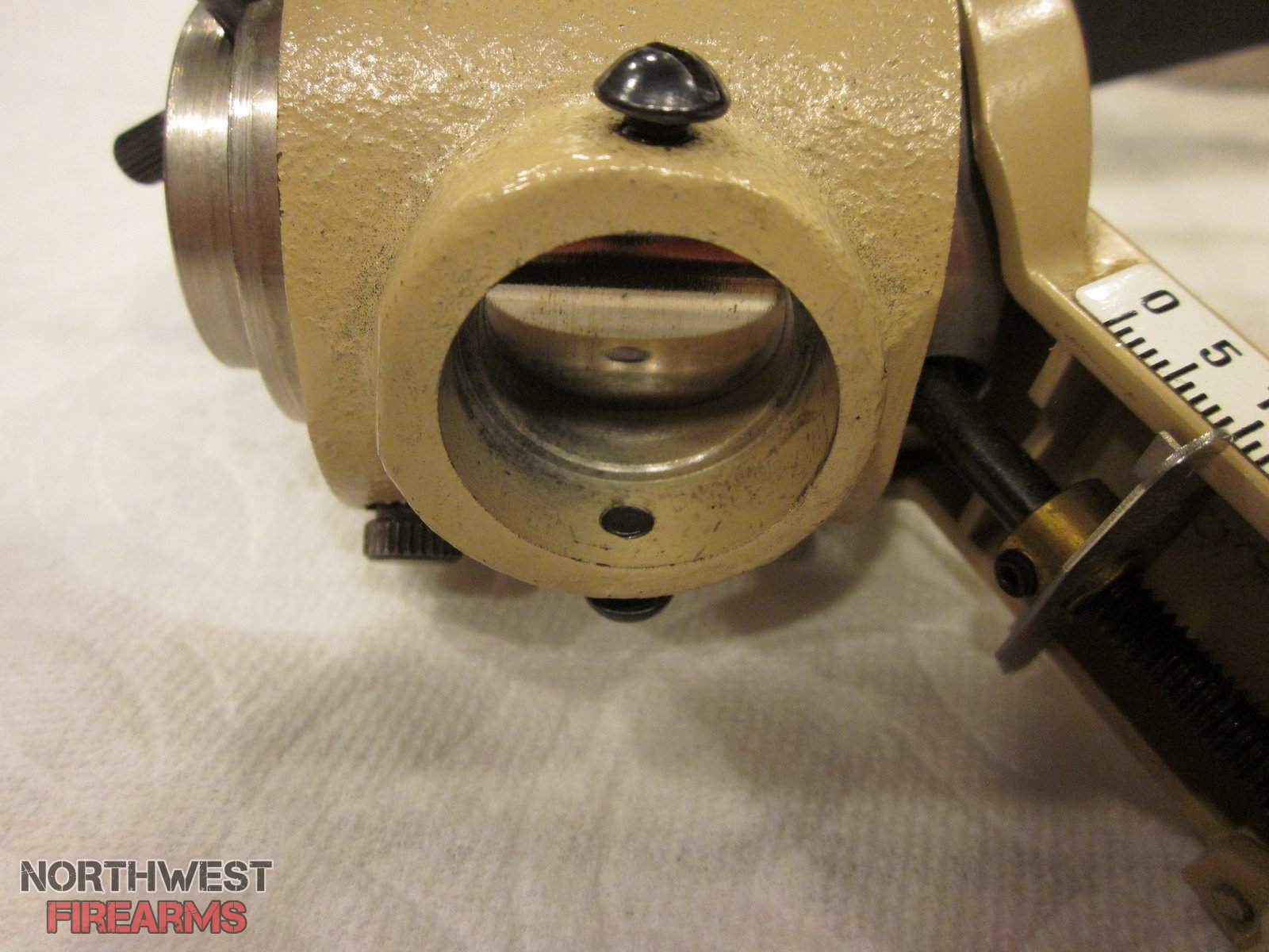

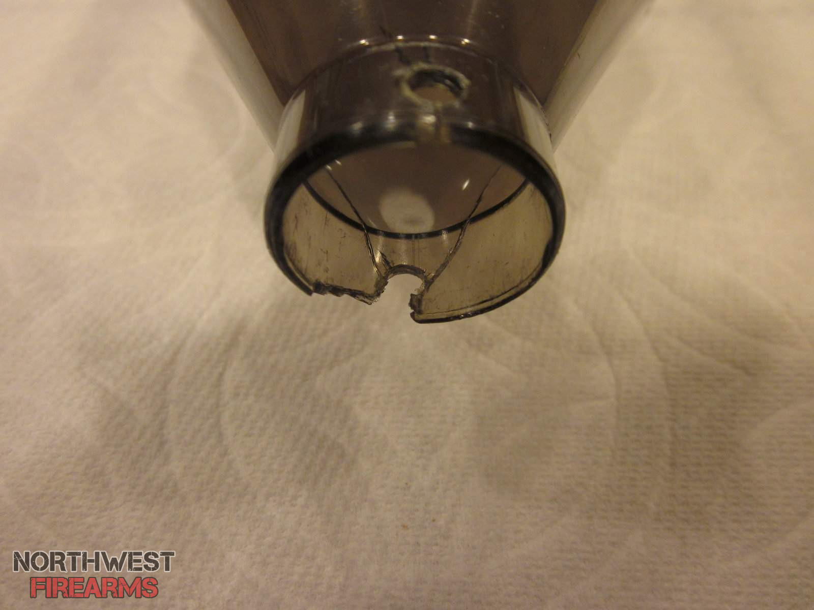

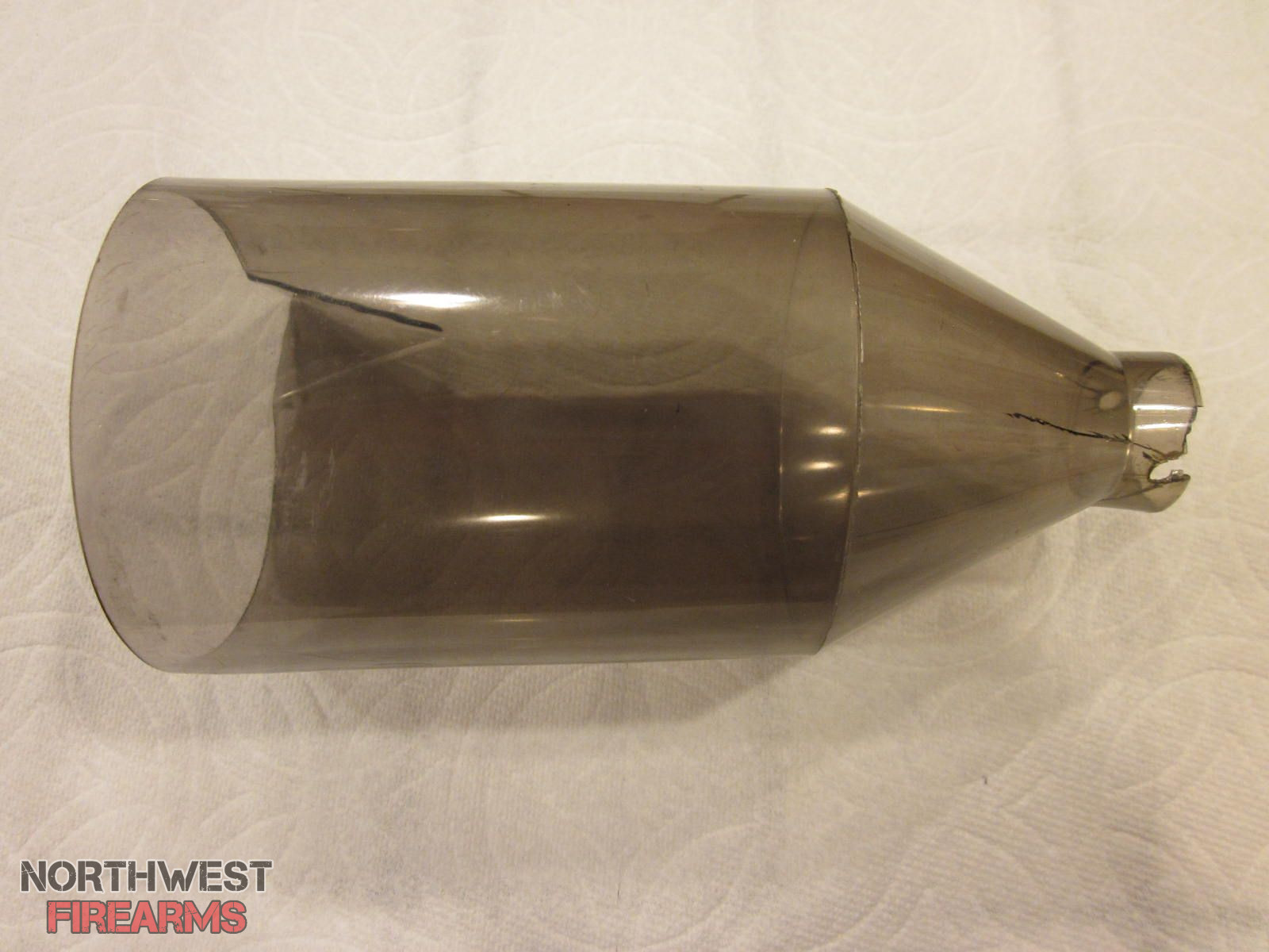

I, like many budding curmudgeon reloaders, have one of the excellent but flawed Ohaus Dou-Measures. The problem was always the reservoir, which was fragile where it slipped into the measure body. They chipped, cracked and broke at the two screw holes. Ohaus supported the measure for a few years, but replacement are decades gone.
I have thought of writing Lee to see if they could make an adapter to use their reservoirs. Although they would sell no measures, they would sell adapters and reservoirs.The Ohaus body measures 0.980" at the insertion point. Does anyone know of another measure's reservoir which is compatible?

Thanks, guys! I have heard the MEC shotgun bottles work, but they are white and have threads, IIRC. To start, I have emailed Lee to see if there is any interest. Who knows, since they already make the reservoirs and the adapter would not be a major project? Here are some pics. Will report back.

It looks very easy to make. Can you measure inside the opening of that metal part?
The opening in the measure body is 0.980" diameter and nominally 0.375" deep. The trick will be to see which reservoirs can be made to work with such an adapter.

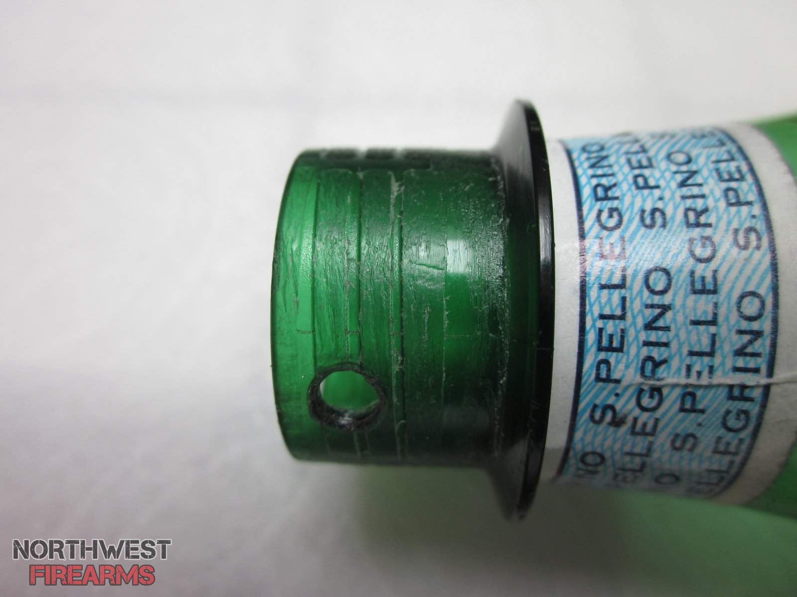

Edit: Found a perfect bottle and removed the threads for a perfect fit. The problem is that the bottle flares out too early and the lever hits it. I need a riser/adapter to lift the bottle and inch or so. Will look into PVC/ABS plumbing connectors, but if I draw a blank, I will make a dimensioned drawing and get it to you.
OK. I found a super-secret European source (which I cannot divulge) for Ohaus Powder measure reservoirs. The measure opening is 0.890" which struck me as an odd dimension. However, the typical 2 liter soda bottle (and many smaller plastic bottles) measures the same around its neck once the threads are removed. So I found a mandrel over which the bottle neck would fit. Clamped the mandrel in a vise and, using a couple different coarse files, I worked my way around the neck, making sure I didn't cut into the neck itself, but just removed the threads. Finished up with a flat mill file and it turned out pretty well.
I had the measure body handy and tried fit several times. Once it was a snug, no-rattle slip fit, I stopped and cleaned the plastic "curls" up with a small wire brush. There was still a trace of the threads left, so trial fitting as you go is the best. As to trimming the thin plastic bottom of the bottle off, I puzzled over that until it hit me that I could simply freeze some water in the bottle and use a utility knife to cut the bottom off. I held the bottle in the corner of a counter top so that I could simply rotate it using the neck and hold the knife steady. A little file work and some wet-or-dry on the cut edge and it was good to go.
Now, the Ohaus measures have dual opposing screws which engaged oversized holes in the OEM reservoir. Convenient, but this allowed the reservoir to rock slightly - which it did from the lever banging against the stop at both ends of the stroke. Eventually, the plastic cracked and the reservoir was on its way out. And, those threads were a comparatively small 8-32 thread.
I drilled the holes out slightly and tapped them 10-32, which is a substantially larger thread. I then drilled pilot holes through the bottle neck, tapping them 10-32 as well. I ran the tap through the measure body and into the bottle neck, so that the threads would be "timed." Thus, the reservoir screws (and the friction fit) keep the reservoir tightly snugged into the measure body. A perusal of my bottle cap collection (don't ask) turned up an old mayo or salad dressing lid that was a perfect slip fit over the bottle bottom (top?). A little creative de-burring of the 10-31 threads in the measure body and bottle neck and all was well.
