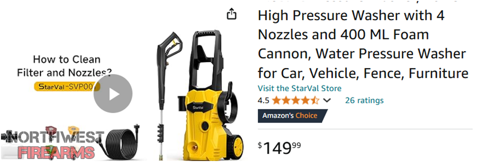

I'm looking for power washer advice. I want to buy an electric PW. For several reason: I'm not so fit as to be able to produce the energy to physically scrub things any more, The water bill in Beaverton is enormous so a power washer would use less volume than a regular hose., I have a neighbor with a gigantic Sycamore tree that extends over forty feet onto my property and produces 7 million tons of pollen that if not removed nearly immediately, will stick like JB weld to everything it lands on (and its everywhere) especially irritatingly on the vehicles and trailer. No nozzle on a regular hose I've found will remove it from the little cracks and edges around seems, windows and canopy creases. Not to mention BBQ and other things,.
So, While I don't need to blow the doors off the truck or carve my name in the concrete, I thought something around 15 to 2k psi would be enough, which seems in line with electrical PW's
I saw a Dewalt that used a 20 volt battery I have, looked pretty simple but it was 500 PSI which didn't seem enough though I don't know what pressure I need for things. I don't want blow the paint off the car or if 500 PSI is enough to get the dried on pollen crud.
Also, I need it to be reasonably light and preferable with wheels, I don't bend over well but I read comments on some taller ones were "tippy"
I have nearly no experience with Power washers, for something little used by an old guy, If you Please, opine on what you suggest or this:
Supposedly 1600PSI 1.2gpm looks like a small compact easy to store package.
Or recommend another:
Thank you kindly.
Give it a try. What you don't want is some piece of sh!t that'll barely blow a leaf around.
What I'd do is rent an electric from Home Depot and then make an educated extrapolation of what psi and gpm is required. You don't want underpowered.. you can always easily throttle down a beast if necessary.
Oh and they sell their used rental equipment too.
