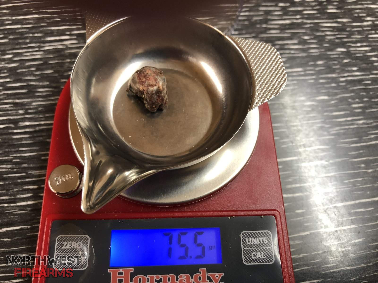

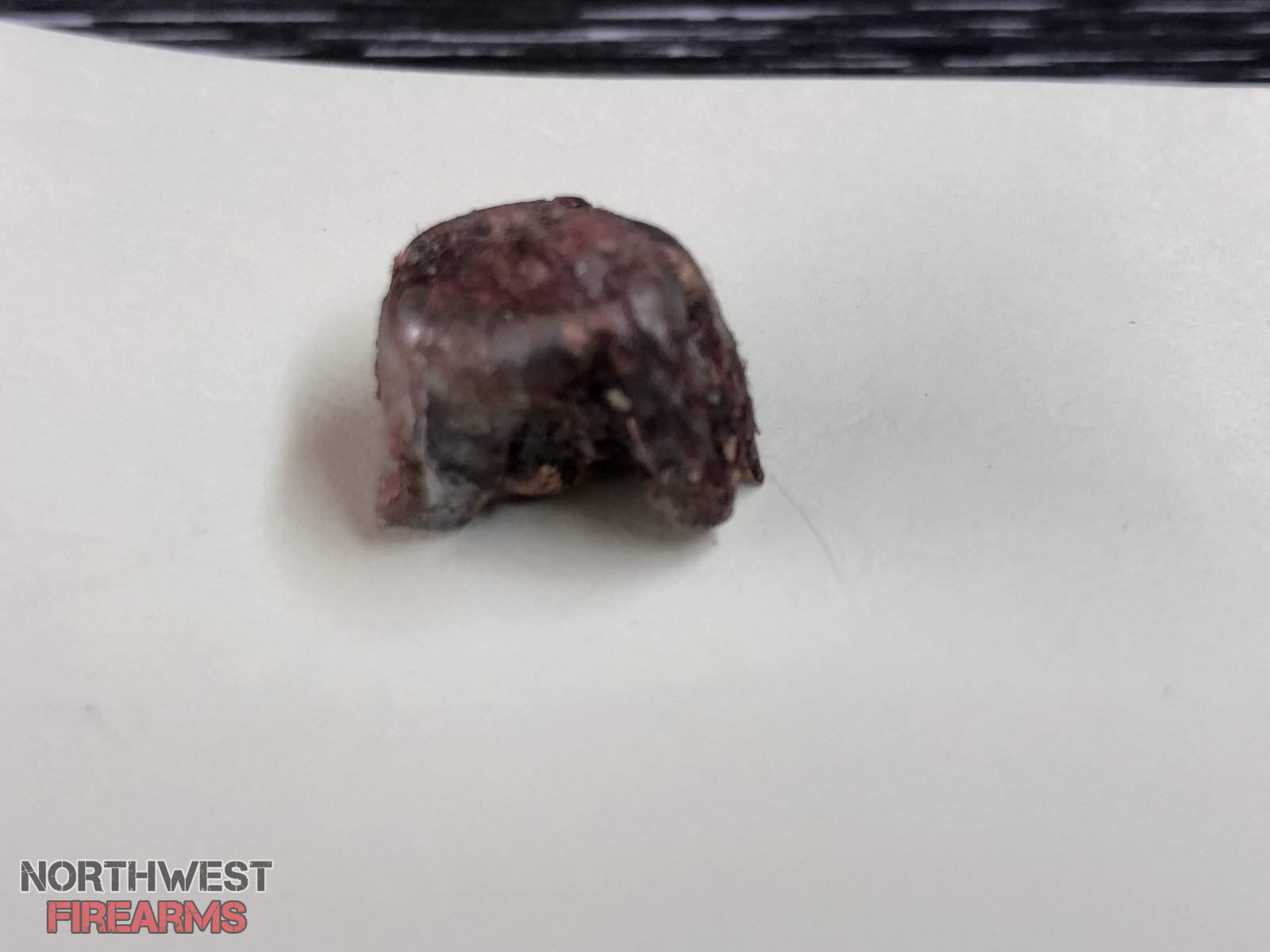

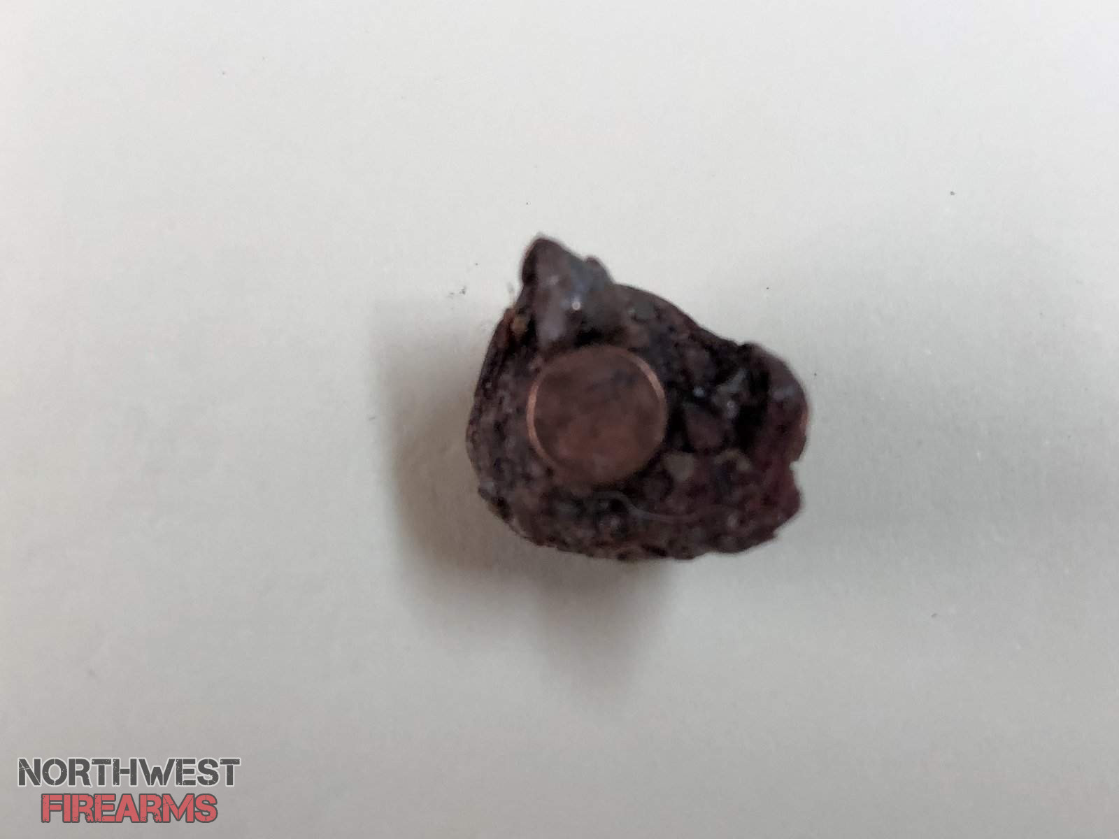

I have used regular Nosler accubond bullets for years with great results. 3 years ago I bought a rifle in 6.5 Creedmoor and developed loads with the then new Accubond 129gr long range bullet. The lr version is supposed to expand down to 1300fps compared the 1800fps of the regular AB. The lr version also has a higher bc for long range work. I read several accounts of this lr version "blowing up" and causing extensive meat damage when striking game at close range. Well after killing 2 deer with my Creed at fairly close range I can honestly say I have not experience this at all. Muzzle velocity in my rifle is 2975fps with this bullet. The first deer, 2 yrs ago, was at 100 yds and was shot behind the shoulder. He was uphill and slightly angled towards me, so the bullet exited through the scapula on the off shoulder. He was drt with minimal meat damage and bullet was not recovered. Deer #2, shot last week, was at 50yds and was downhill and at a pretty good angle towards me. Bullet entered the neck hitting the spine and came to rest inside the the off shoulder. The deer was drt. The bullet certainly shed a good amount of weight but the mushroom looked good and remaining lead core was still bonded to jacket. Meat loss was also very minimal, isolated to some neck meat loss. Now while I probably wouldn't choose this bullet for a 26 Nosler, I believe it is a very good match for the 6.5 Creedmoor for hunting deer, antelope and caribou. I have yet to test the bullets performance at long range on game, but I am confident it will do well. I will try to get a pic of the recovered bullet and a retained weight tonight when I get home. Just from looking at it, I am guessing it retained around 40-50% of original weight.

So the recovered NAB LR that started at 129gr, weighed 75.5gr. I haven't cleaned it up yet so there is still organic matter on it. So let's just call it 75gr. That is 58% retention of original weight. Diameter of expanded bullet was about .475" or about 1.8x original diameter. Here are a few pics of the recovered bullet.
A97EFA5F-9089-494C-B712-6C9EFEB2A1D9.jpeg 3095FD0E-D994-4994-BEBD-013E9948EBB5.jpeg D83ACB67-0B28-4A78-A271-ED5E5EB2C684.jpeg BD033A9B-3F43-4270-A3DD-F9229C64F2F9.jpeg
