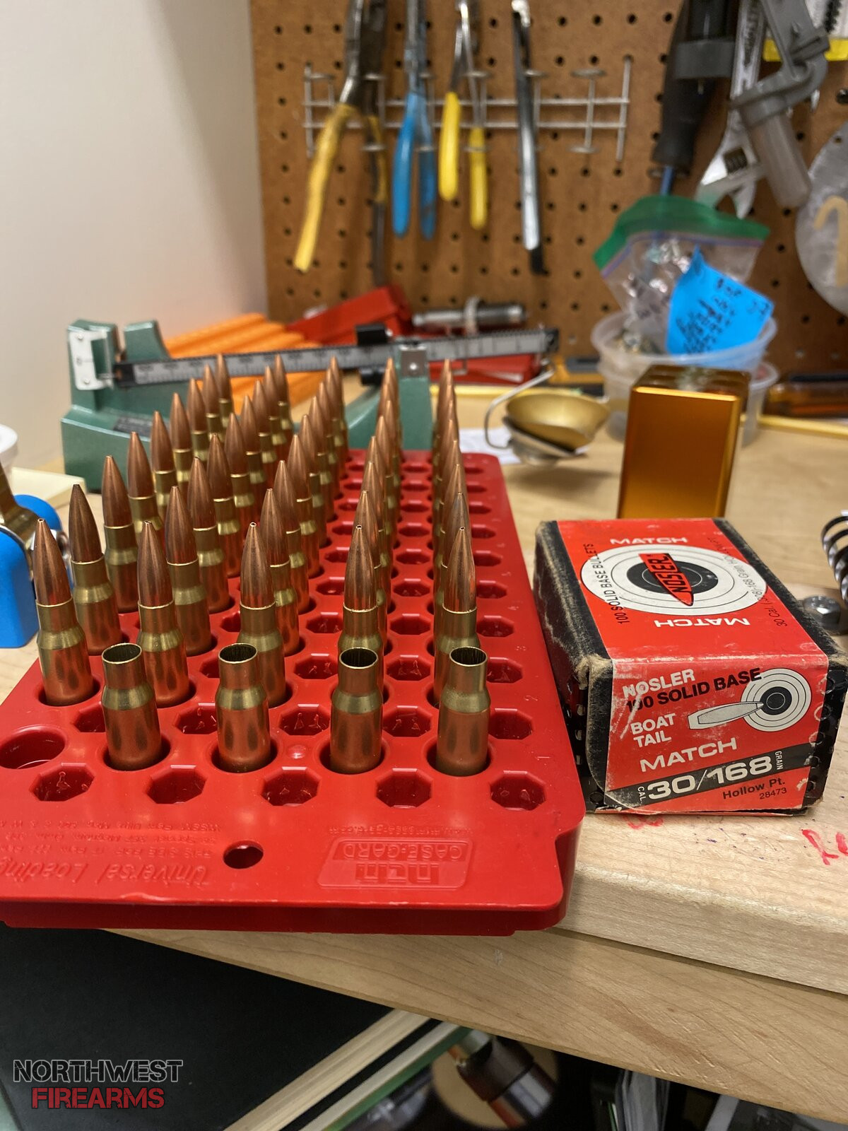

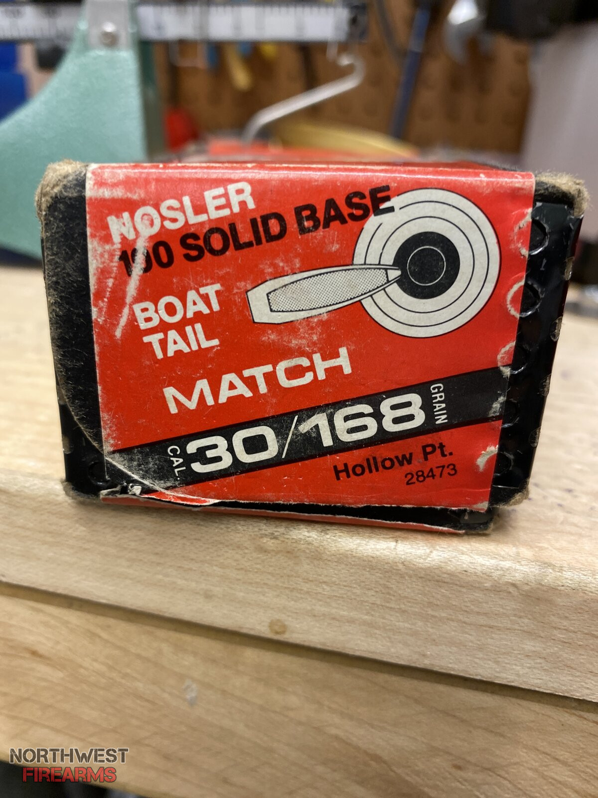

Can someone with a Nosler book pass .308 and 3006 load data onto me from there Nosler manual for there 30 cal. 168g boat tail match #28473?
I have the one book one caliber for both calibers but the Nosler section is scarce on info.

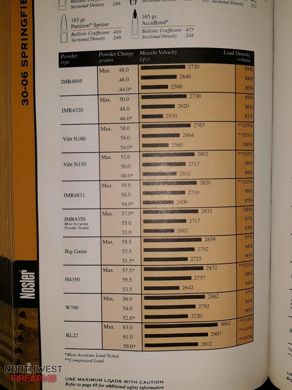

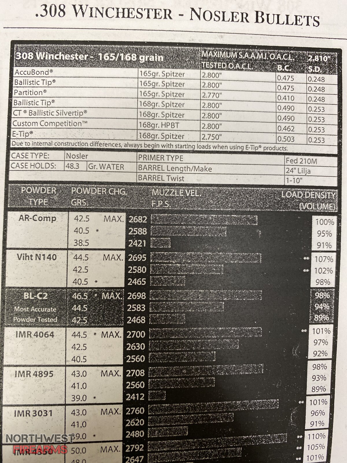

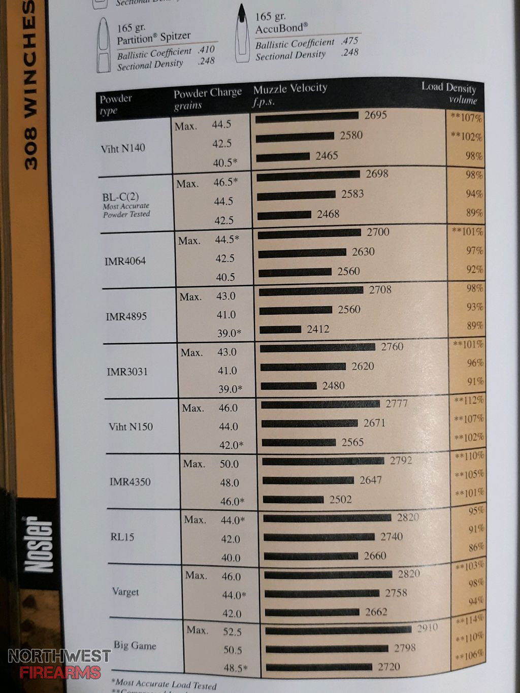

For some reason my phone keeps chopping off the top of the page. These pics are from Nosler #6.
Both the 308 and the 30-06 data is for these Nosler bullets.
308
30-06
I think where you are getting confused is that you want data for one specific bullet and Nosler lists the same data for 9 different bullets. The data is a guide and reference but isn't an absolute. Any of the listed loads will shoot safely and they even list the load THEY liked best. Now you are into the alchemy part of loading and that is finding YOUR best load. That's why they call it load development.

Another factor that should be pointed out is that the bullets you are using are no longer produced so you are going to have to pick something that matches as closely as possible. I would go by the Custom Competition specs if it was me.
