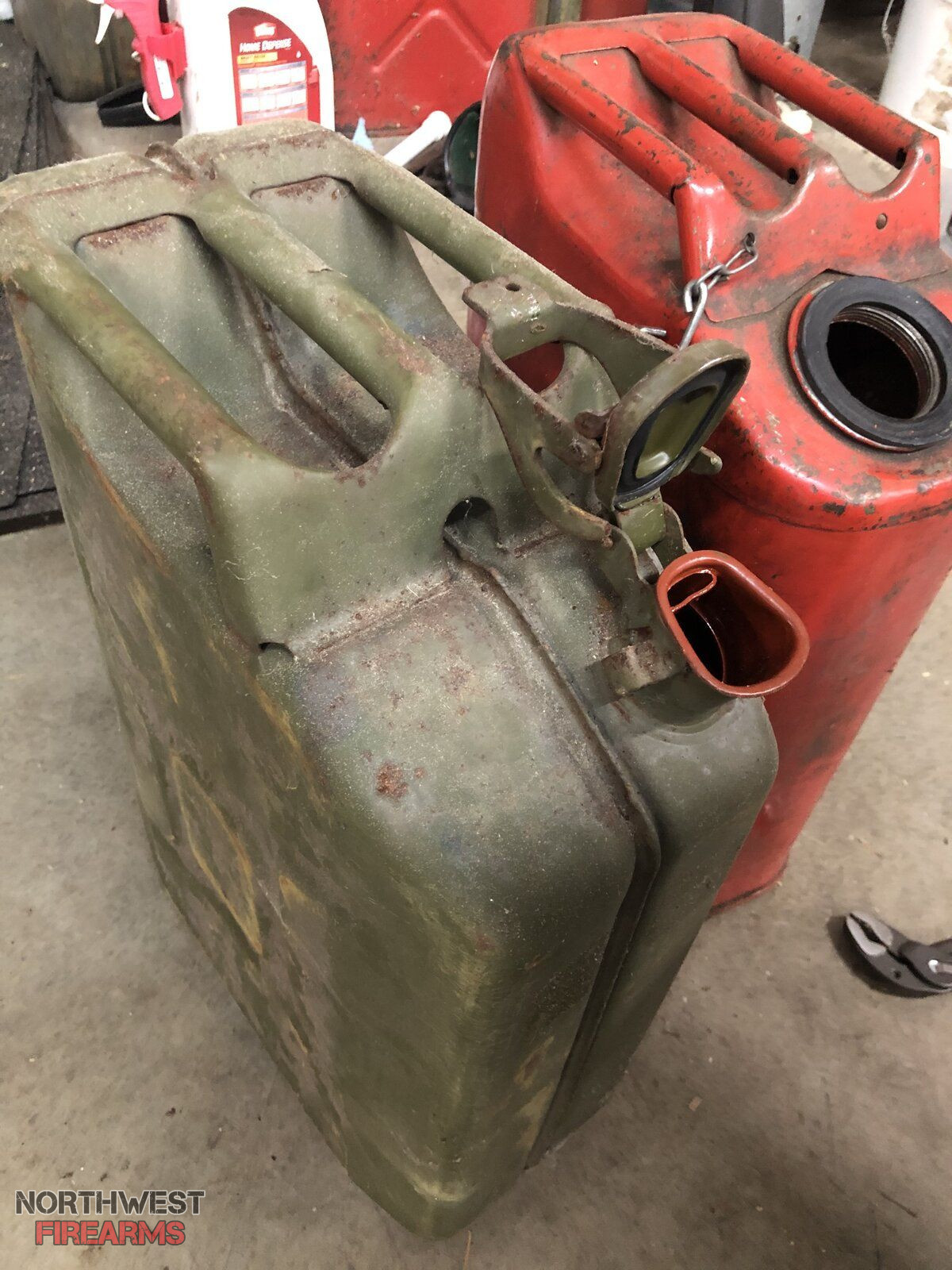

I'm usually pretty good at finding stuff online, but not doing so hot on this one, and figured given this is preparedness oriented some of you on here might have experience with this. I have a stock of old school metal 5 gallon fuel cans. I believe one is called "Wavian" or NATO style (green one) and the other is old school GI issue (red one). Problem is I do not have any spouts for the green type, and only the large diameter spouts that won't fit in the new school vehicle gas tanks on the red style. I'm trying to see if anyone has experience where they can recommend a specific good quality after market nozzle for each that are designed for these type of cans that are of the right diameter to work with normal car gas tanks. I've seen a couple online, but with mixed reviews, so just seeing if there are any first hand experience here. I've just been using a siphon/pump, but would really like to not have to go that route if there is something else out there. Any help is certainly appreciated.
The extended spouts made in Estonia are excellent for NATO cans. $21.72 each. Long enough that you wont scratch your car up trying to get the last of it. I'll look for a link.
Edit: https://smile.amazon.com/gp/product/B081HZGDDD/ref=ppx_yo_dt_b_asin_title_o03_s00?ie=UTF8&psc=1 I can't attest to the longevity as I just got mine. I was using the older shorter standard ones and then I got a new car which I do NOT want scratched up. Title is
VALPRO Long-Nose Flexible NATO Jerry Can Spout/Nozzle, Fits Wavian or VALPRO Euro Military Spec Cans (Olive Drab)
Suggest getting a few new gaskets as well - those are not always available and they don't cost much.
Thanks Bill! Those look like they would work good, and I appreciate the first hand recommendation. Good call on the gaskets. The ones I have seem decent, but cheap insurance.
P7M13 - Are you local to Vancouver/BG area? I wasn't really looking to sell, and don't want to ship. But I do have a few of these, which is more than I really need. If you need one and are local we can work something out.
Cigars, every one of those will scratch your Ford Truck right at the end of the pour as you tip the can up. At least they did my Ford. So if your body panel config is different, they might work, otherwise, pass. The other thing the Estonia long one does better is that they increased the air size. Those small ones will more easily leak through the airhole if you get over enthusiastic when dumping the can upside down. I learned that the hard way too.
It's possible that those will last longer as they are a single construction, whereas the Estonia ones are flexible. If all you were doing was filling a lawnmower, those would be as good as the next one, perhaps better, I suppose. I rotate the fuel when it gets old and do that by dumping it into a vehicle. I have the cans tagged with the date and put PRI-G and/or Stabil Storage in it.
My Wavian is now 5 seasons old, made in Latvia. The original spout with bump in middle certification for Cal.gov was leaky fraudulent failure within weeks. They replaced with more primitive flexible spout that remains flawless. I'd buy a second 5 gallon if I could find one.
