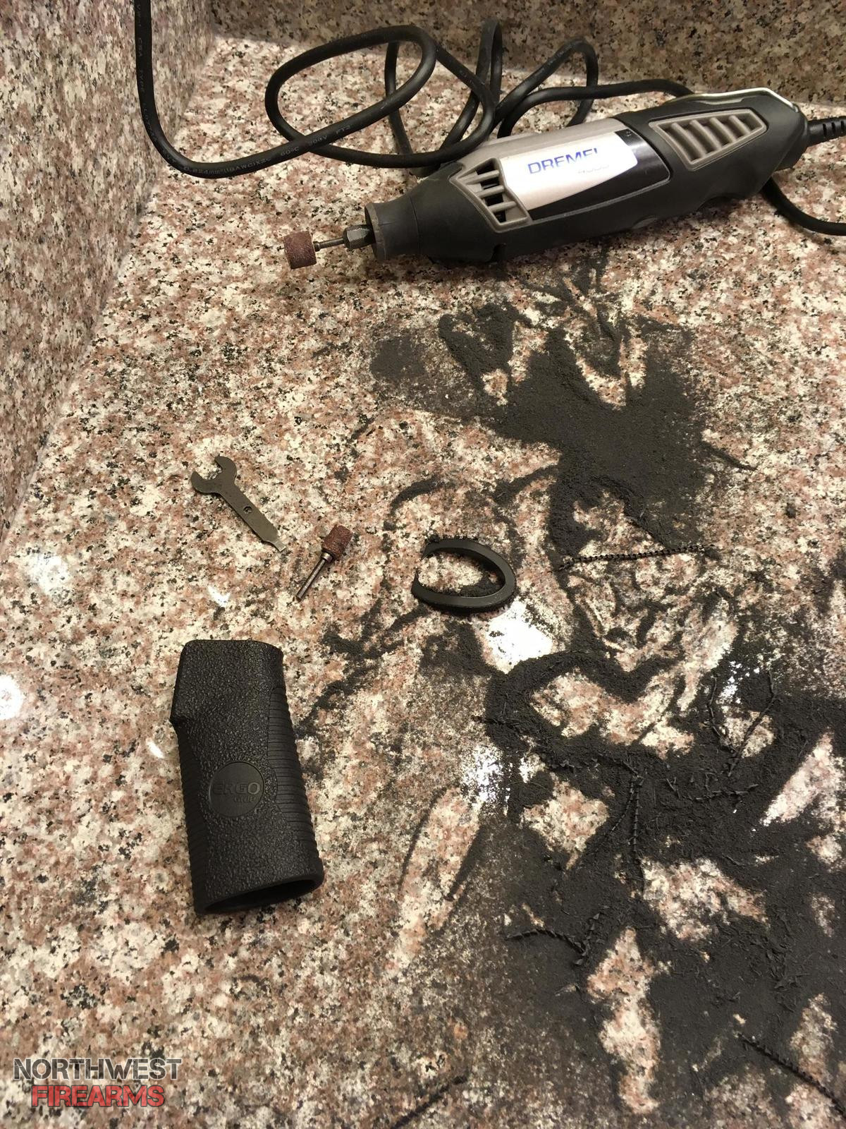

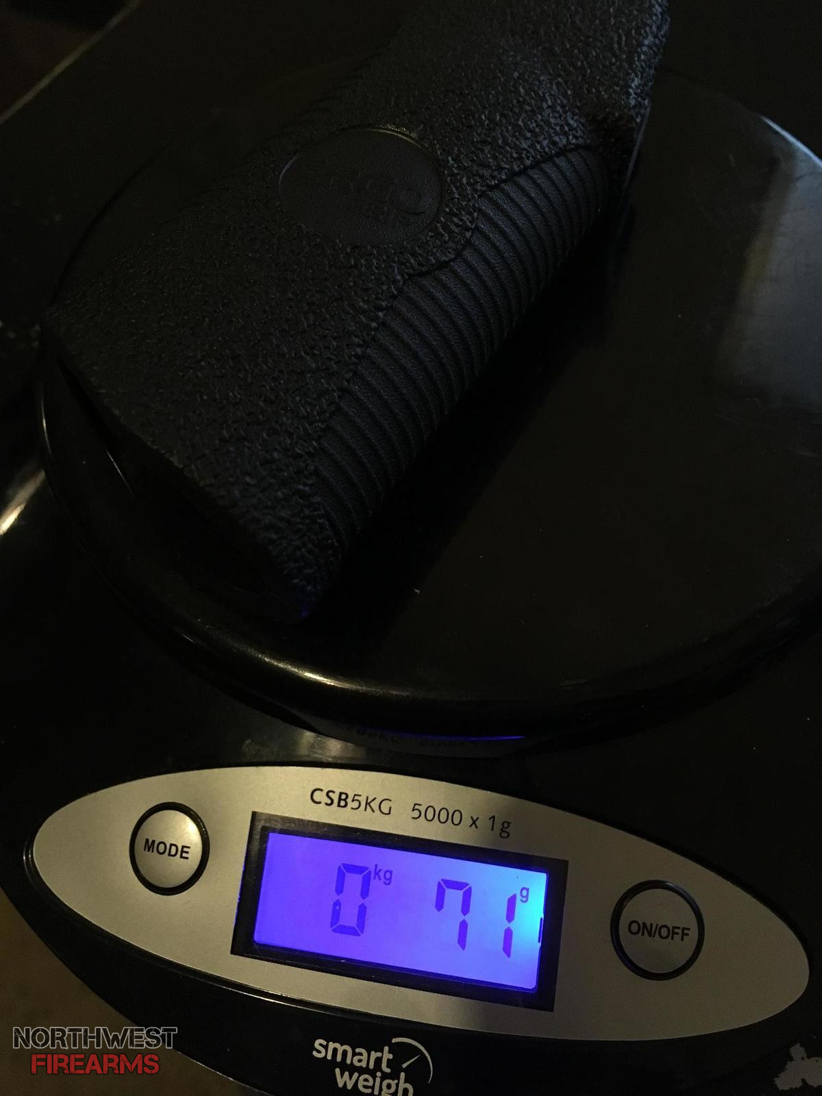

Got an ERGO Swift grip. 2.5oz
Did this.
Started by cutting the excess plastic off the bottom of the mag. Ground out the inside to thin out the very thick plastic. Thinnest place is still 1/8" thick.
Took off some excess material from the "out of sight" areas. In my opinion, i accomplished this without weakening the structural integrity of the grip.
The above steps resulted in a .5oz weight loss lol. 2oz.
Im very happy with the feel of this grip the angle might allow me to run a BAD LBS. I have one on the way to try out.

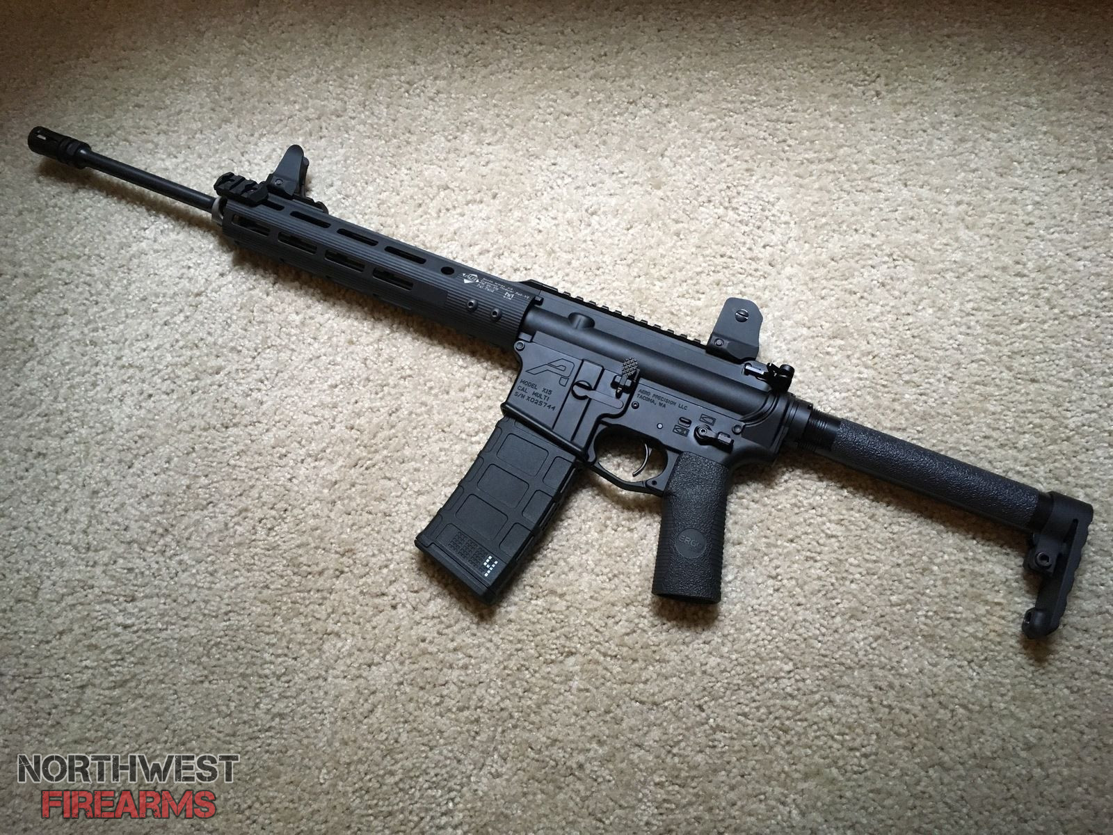

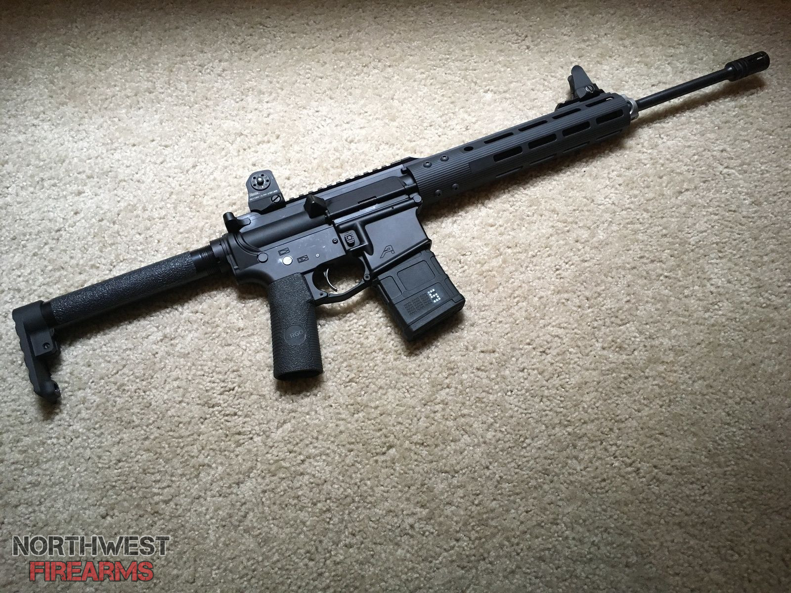

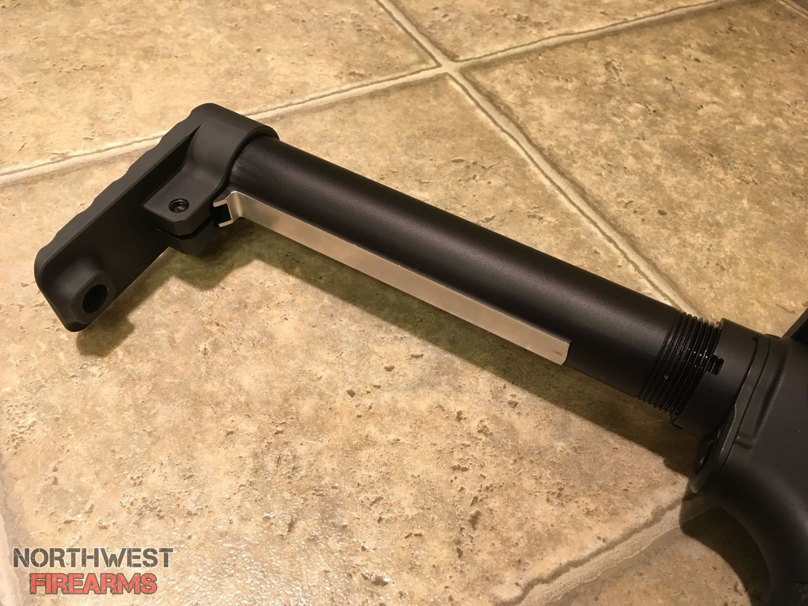

New stock setup. AR10 buffer tube and a bad lbs replica. After modification, the buffer tube weighs 3.4oz and the buttstock weighs 2.6oz with the screw. I still need to make up a spacer for the inside of the tube so that the carrier doesn't over travel. Assuming the internal spacer is ~.3oz i will have dropped ~2.5oz off the back of the rifle which is the last place i want to remove weight from but i cant really think of any more ways to drop weight up front.
The length of pull is doable with the ar10 tube, this butt stock on the normal carbine tube was too short. Im pretty happy with it. Probably going to have it cerakoted.

Made the action spacer today. .2oz! nylon. Not sure how it will hold up. I might end up having an aluminum one made or just hack up another carbine buffer.

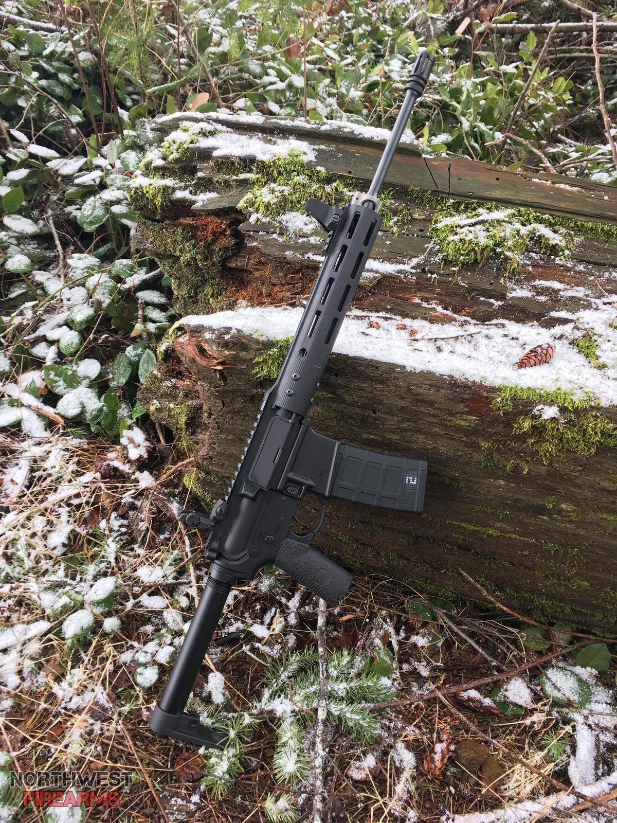

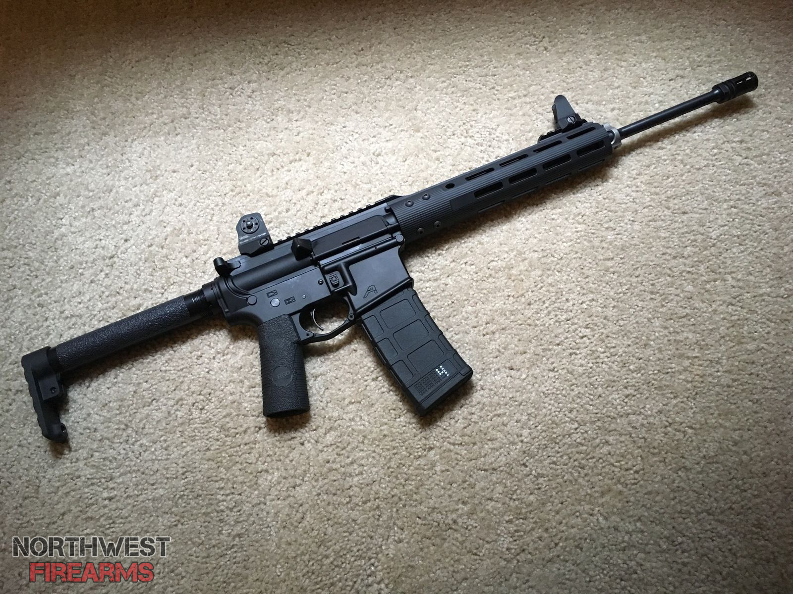

Thanks! Got the buffer tube back from cerakote. Added some talon grip material to the tube to keep it from being so cold/hot on my cheek. New DD sights are all sighted in, put a few hundred rounds through it. I think im done... Final weight is 4lbs 9.9oz. Thanks for looking. Ill post updates as i put more ammo through it.
Exactly 6lbs with 20 rounds in the mag :)
