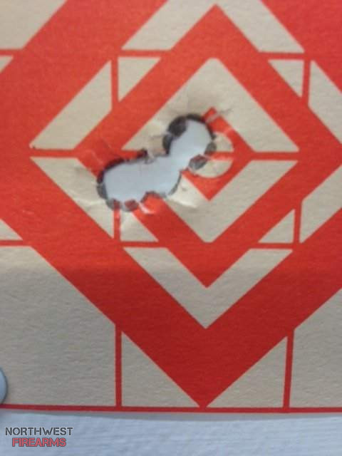

Right now my Tikka likes 175 gr and I'm gouping where they all touch at 100 yards. IMG_0627.JPG 100 yds

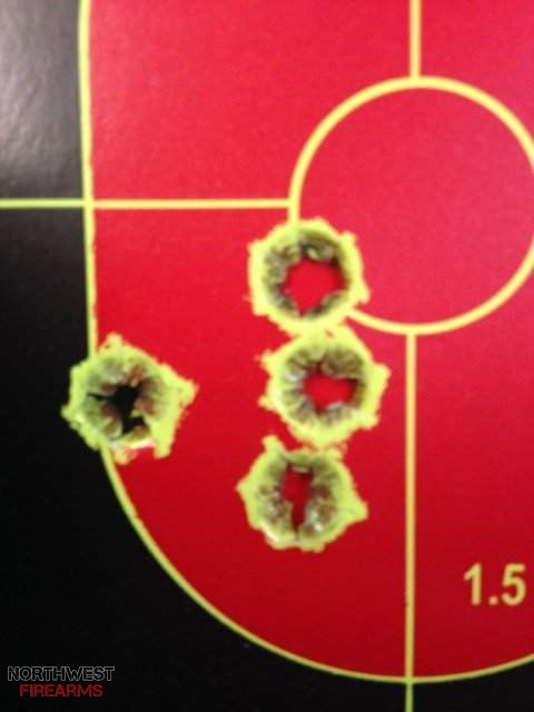

IMG_0712.JPG This one is at 300 yards

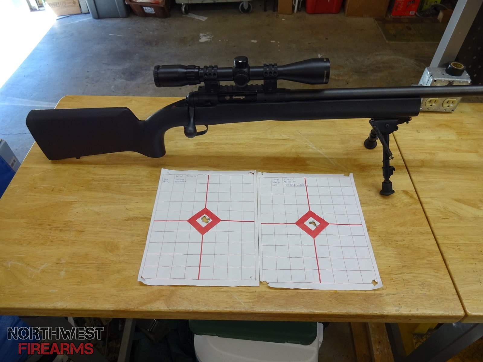

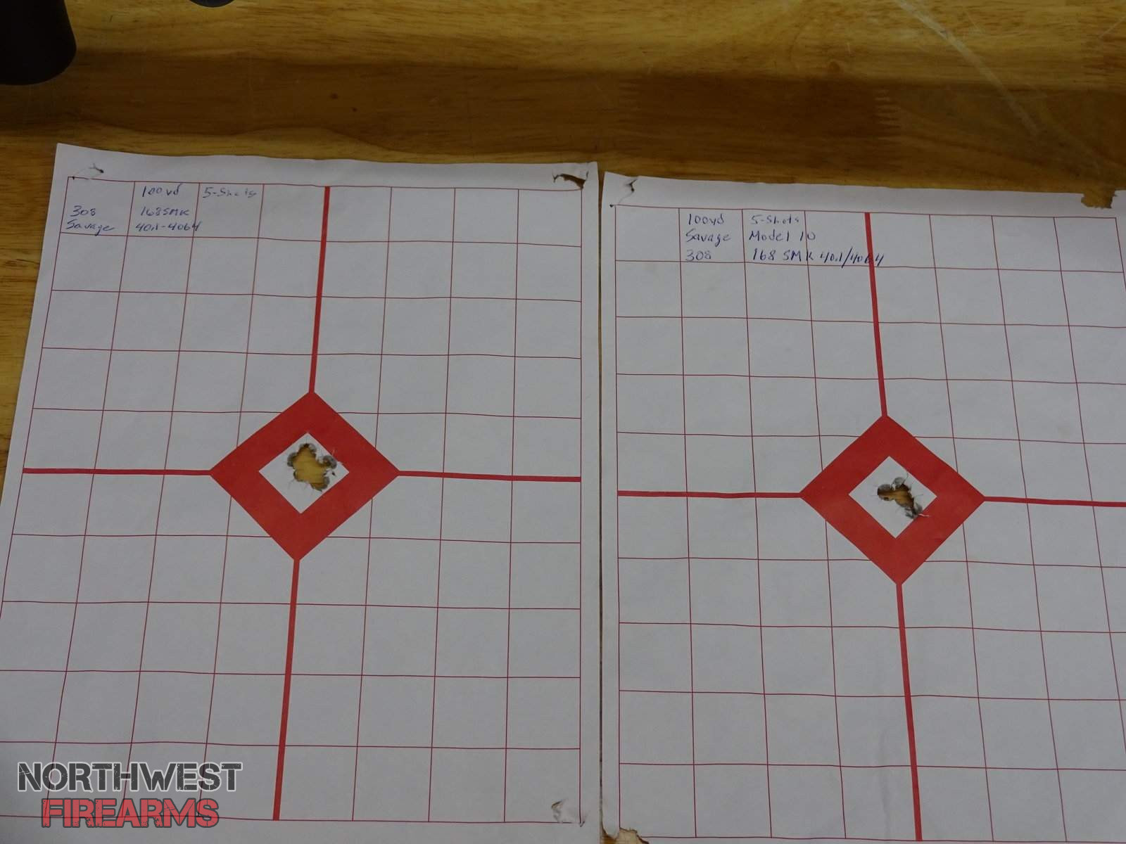

I got some good results with 168 SMK and IMR 4064. Full length resized
load for my M1A. Savage Model 10
5 shots at 100 yards. I need some better glass for this Savageo_O
