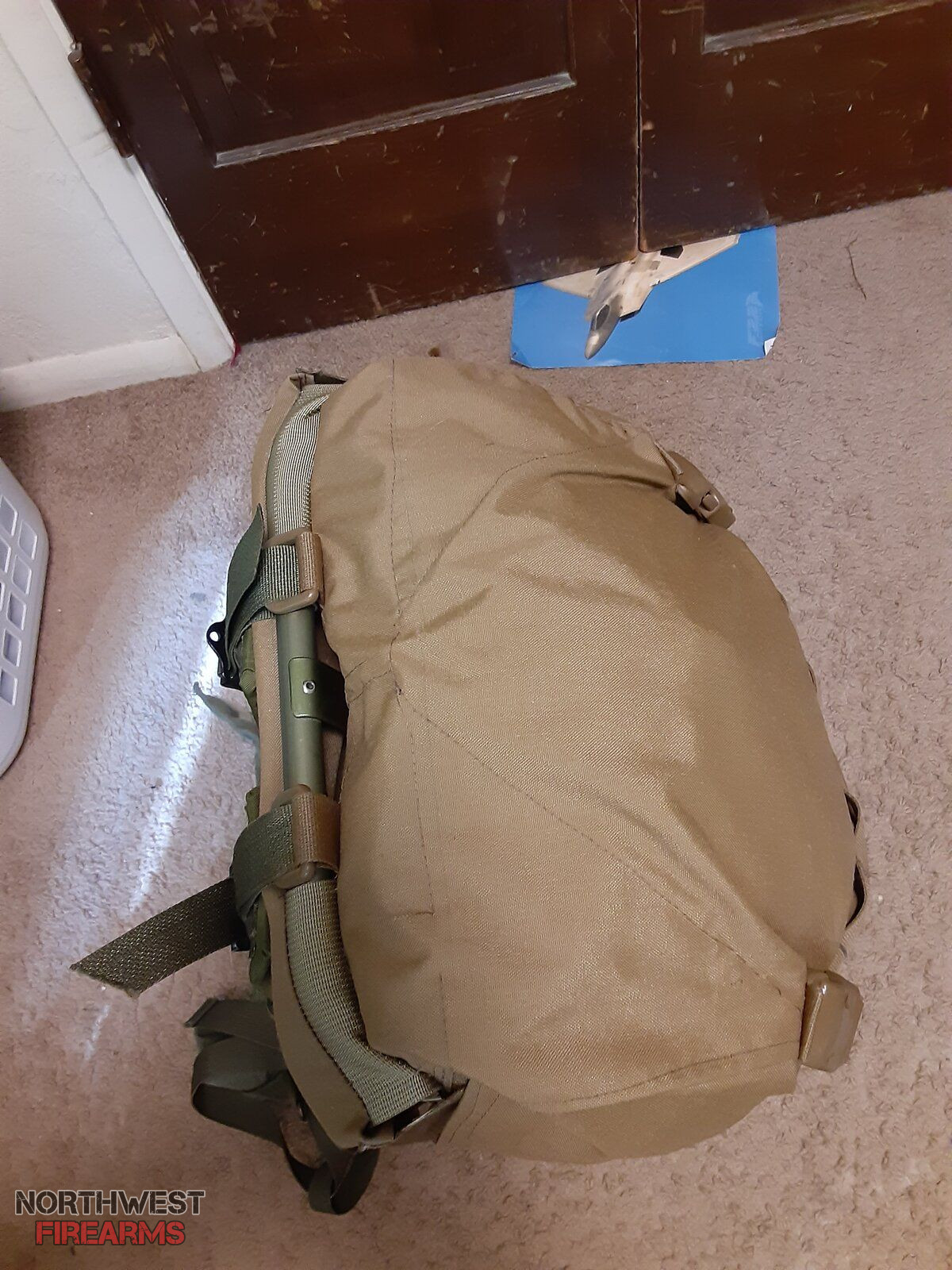

Made this. Specs
500D Flame Resistant Cordura, Coyote Brown
22x6x13 approximate size, about 1700 cubic inches.
Weights? Heavier than it needs be; but should be sturdy enough to replace the Medium ALICE packs as grab and go bag.
Can be used frameless, or with the following frames;
Outdoors Products/Coleman Peak 1 Ram-Flex frame, the 26" tall junior/small size
Molle Medium/Down East Inc (DEI) 1609 Open Perimeter frame (with MOLLE II belt and ALICE straps)- these two frames are the lightest without suspension.
Bog standard ALICE frame
USMC FILBE frame
May fit Kifaru Bikini frame and Mystery Ranch NICE frame and maybe others as long as approximately 12-13" wide on ths outside
Shown with 2x Tactical Tailor Large Utility Pouches and USGI MOLLE II Sustainment pouch.
Also shown, the 2,000 CI short and fat MOLLE bag I made as well, on FILBE frame for size comparison
Horizontal Lash strap attaches to frame with tri glide buckles. On to pics! Please excuse them being out of order... too tired to attach one by one :rolleyes:
20200428_001043.jpg 20200428_001054.jpg 20200427_235556.jpg 20200427_125208.jpg 20200428_000019.jpg 20200427_125321.jpg 20200428_000032.jpg 20200428_000053.jpg 20200427_235510.jpg 20200427_235515.jpg 20200427_235531.jpg 20200427_125123.jpg 20200427_235548.jpg 20200427_125134.jpg 20200427_235028.jpg 20200427_235037.jpg 20200427_130918.jpg 20200427_235500.jpg 20200427_130926.jpg 20200427_130941.jpg 20200427_095448.jpg 20200427_095501.jpg 20200427_095512.jpg 20200427_095538.jpg 20200427_095440.jpg 20200428_001103.jpg
Bought 3 Coyote Brown Sustainment Pouches for real cheap... decided to fit 2 onto this pack... ends up looking like a modernized ARVN Rucksack lol:s0151: Running the lid straps behind the pouches sure cleans up the look. Now I am looking for a set of CB shoulder straps that are light and afforfable.
A single Sustainment pouch fits an USGI Poncho Liner, or the ECW parka with liner 20200622_135604.jpg 20200622_135608.jpg 20200622_135613.jpg 20200622_135620.jpg
