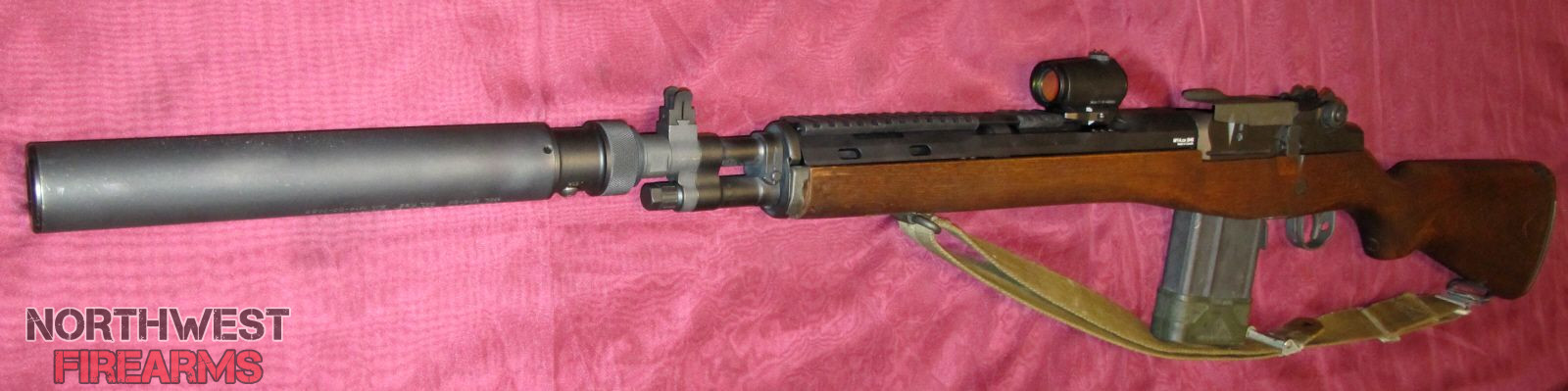

  • I will have to research the front sight/gas block situation. That is a potential wrinkle, though I have seen suppressed M1As, so I presume doable.
  • The can in question has just about every conceivable thread types available, so that should be doable.

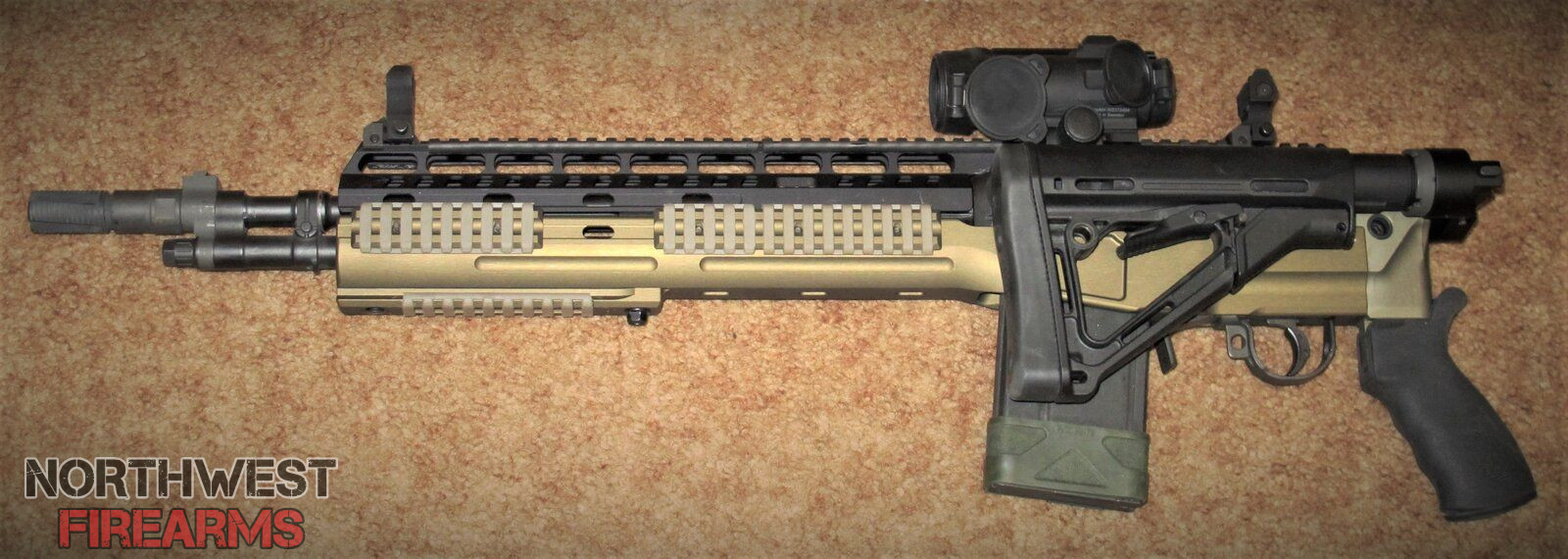

what I wanted ten years ago was the SOCOM with a bunch of rails on the forearm like a quad rail. I think you can buy them aftermarket, but I now have a DDM4 with a quad rail and I don't care for that set up anymore, but great for a red dot and weapons light.

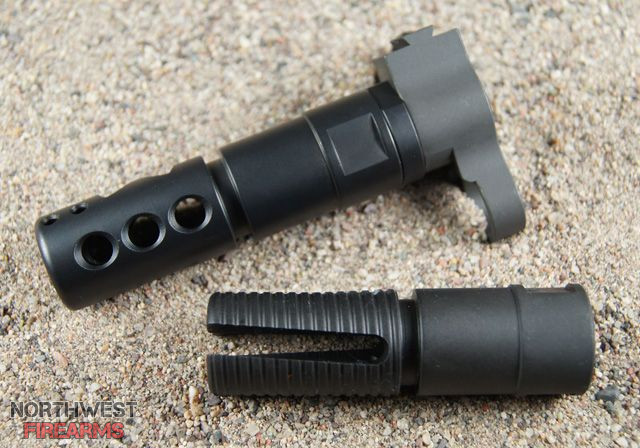

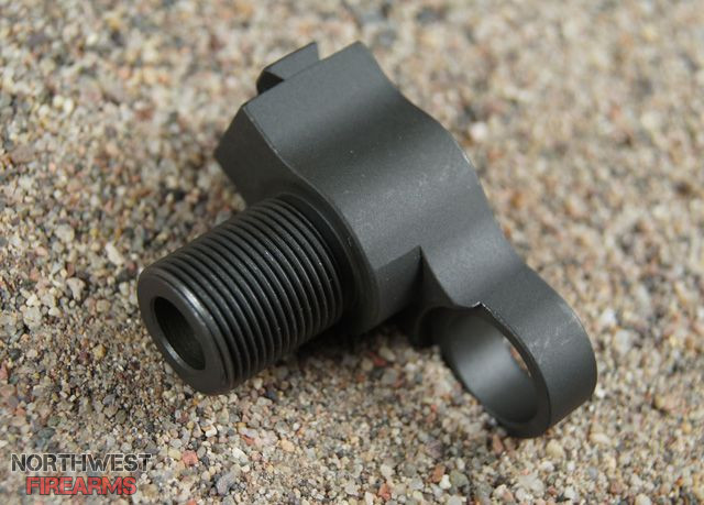

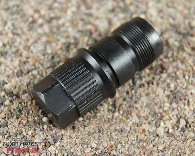

You will need a threaded gas lock to suppress the Tanker.
1602991444904.jpeg SEI Gas Lock for SOCOM 16
1602991569059.jpeg SEI Short Gas Plug (For Suppressor Clearance)
1602991700014.jpeg SEI Kit

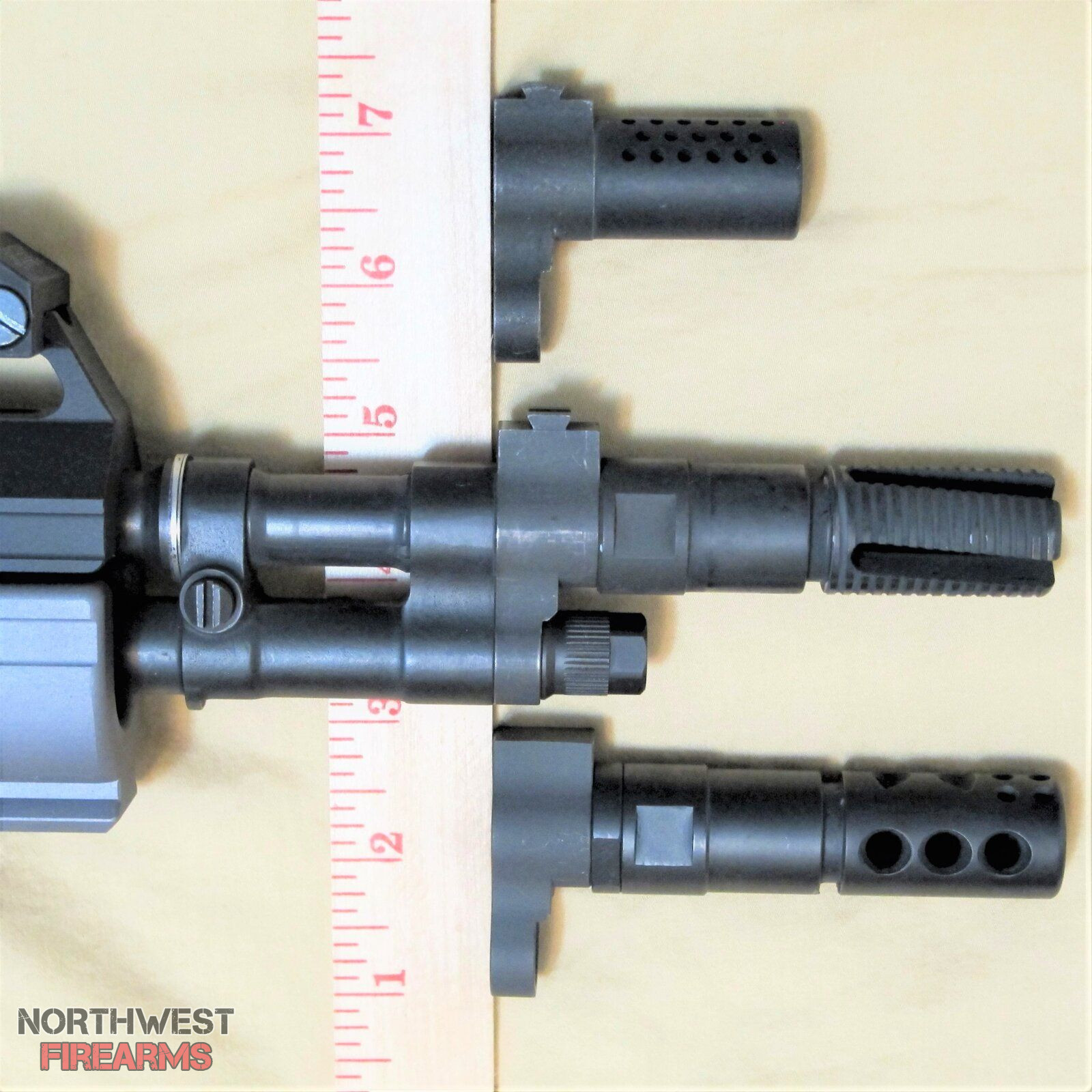

The Tanker is a Socom 16 with a standard hand guard in a wooden stock, it has the 16.25" barrel that was introduced in 1999.
Using a Smith Enterprise gas lock allows you to use a standard front sight, and you can use different muzzle devices.
I use SEI's DC Vortex flash hider, it accepts my Wind Talker suppressor... it's set up with a light weight SHG and Aimpoint Micro
I love my CQB-16 type SEI, but the best shorty is the 18" Scout / MK14 Mod 0 & 1. It is easier and cheaper to change gas locks and muzzle devices on the 18" barrel.

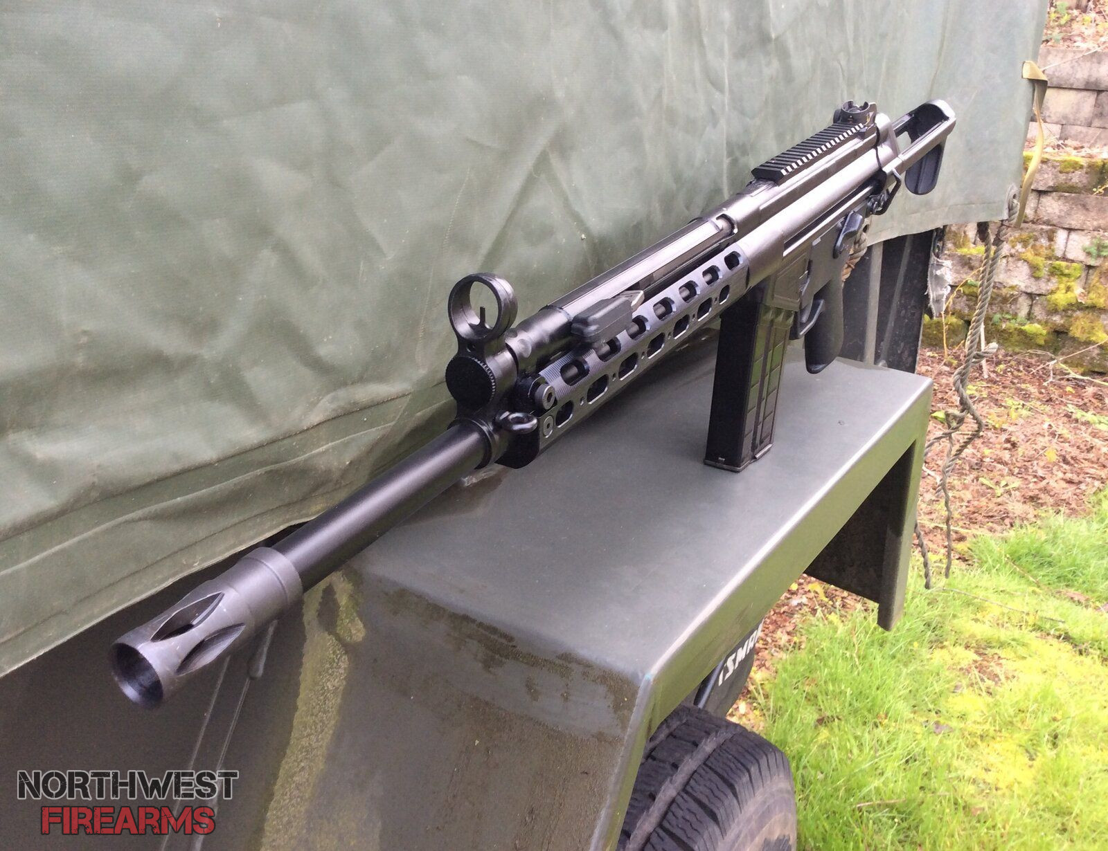

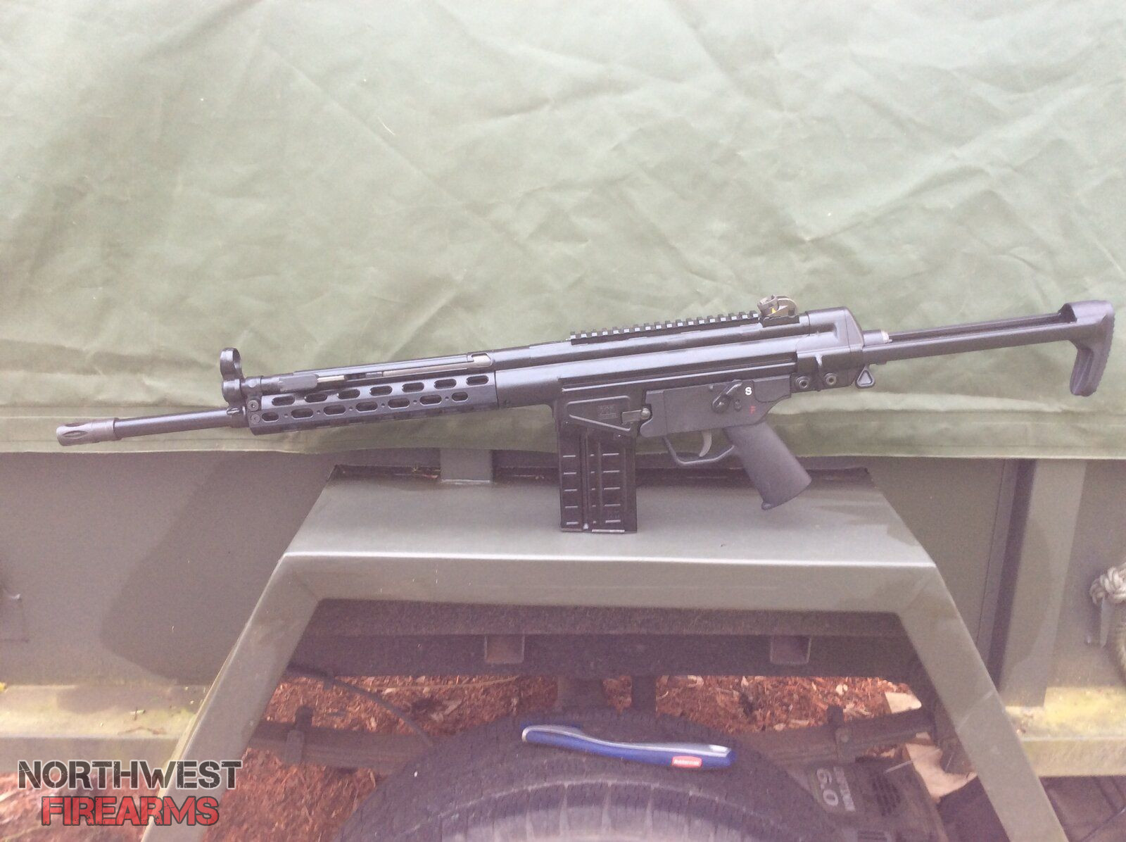

PTR91:
:D
Apologies on the thread drift....
Haven't taken any of our PTR's out in "a while". May. They're a hoot. Accept CETME & HK mags, of which we have over 400 combined nowadays...:)
Mixed feedback as towards wether all PTR's accept CETME mags. Ours do, of the ones we've tried.

I set up a scout in an EBR stock and it was a sweet set up. The thing is a vey heavy beast and ultimately that is why I went another route.
