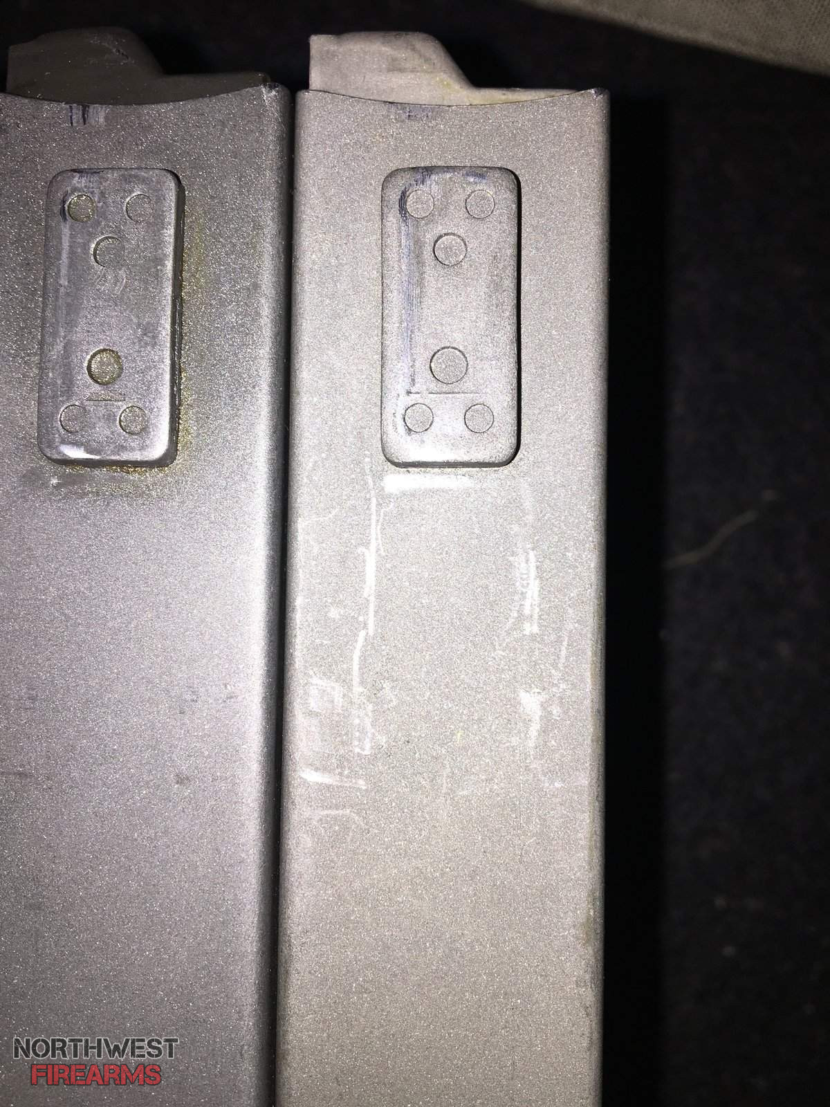

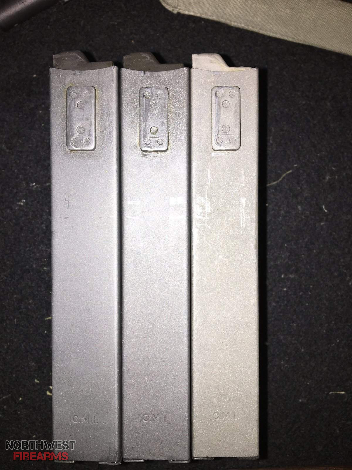

Looks like one included may have been filed a bit. Look at the second picture.
View attachment 447972 View attachment 447973

I did not file anything. Just pulled the the trigger group and reinserted it and tried 6 magazines and they all locked into place. The second picture that the magazine on the right was the one included with my M14. The left and center magazine I did not do any filing at all. Looks like one that was included may have been filed a bit under the magazine tab. Look at the m14Forum.com website.

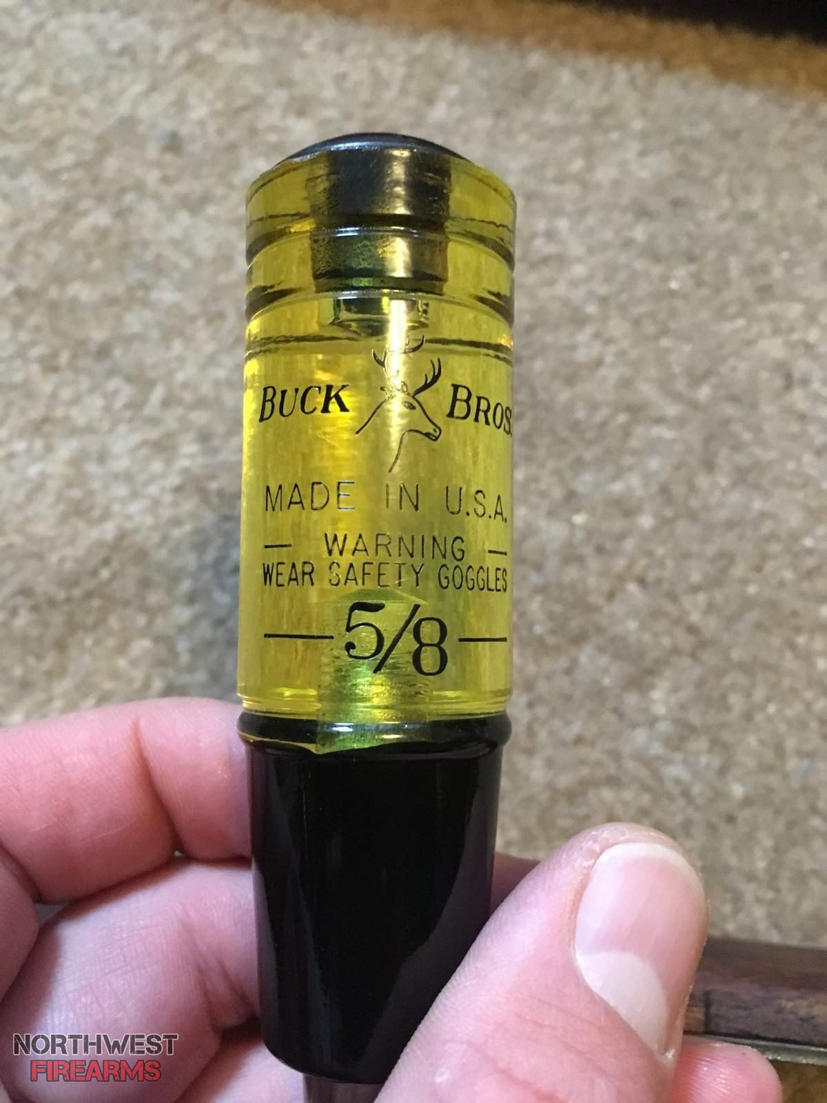

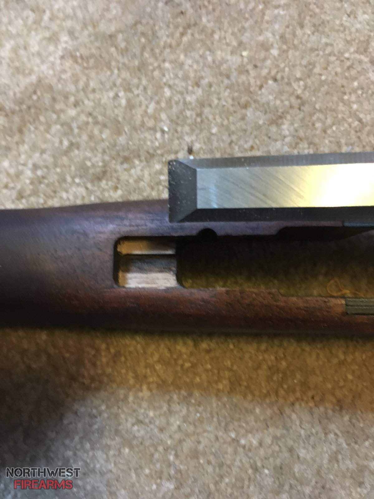

Ok everyone, fixed my problem in 7 minutes with a 5/8 inch wood chisel.
Removed the barreled action from the stock. Found the little flat spot where the rear of the trigger assembly fits flush against the two little wooden "flats" inside the stock (see pic). Got a sharp 5/8" chisel which fit perfectly into the channel and carefully removed a few curls of wood, pushing the chisel gently across the flats with hand pressure only. I probably removed less than a tenth of an inch of wood. Put the rifle back together to test for fit; the mag goes in way easier now! It requires substantially less effort to click in.
