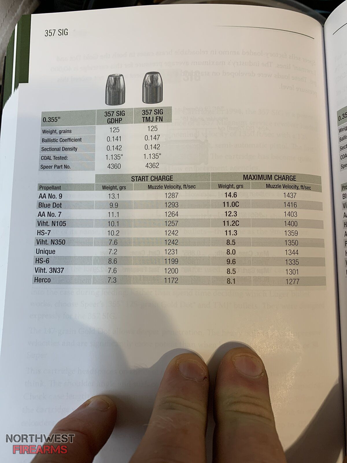

My Speer #10 doesn't have reload data for the 357 Sig - I was hoping to get early Speer data from #11 and compare it to my #14 manual.
If you have the Speer #11 reload manual and can help it would be great!
You're correct... I stumbled onto a neighbors copy of #12 tonight & it's not included there either.
#12 was published in 1994 as was the spec on 357 sig. I guess Speer #13 may be the first place it may appear.
I found the page linked below with 124g GD data posted, and the Min/Max charges based on velocity match up with the Speer #14 data on 125g GD recipes.
I thought they would be slightly different, but it appears initial data gathering was good enough and they pulled it forward.
In case it helps, Speer #15 is the same as Dyjital's #14 page, except that they removed HS-7. Whether that was for a good reason or not, don't know. I didn't see where you specified a powder you're using, so thought I'd mention it.
