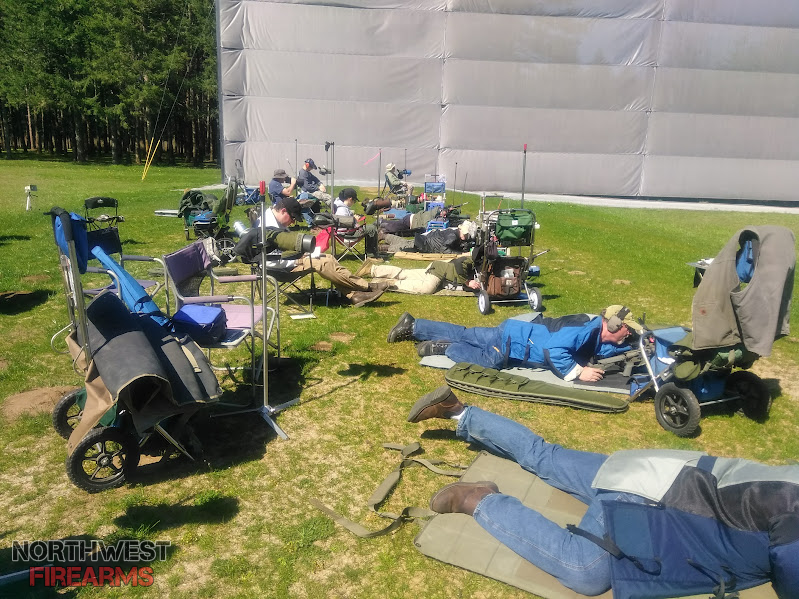

No spotting scope will allow you see holes at 1K or even 600 yards. In competition
shooting the spotting scope is used to read the mirage. Seeing the mirage is for
reading the wind. Majority of Highpower shooters use the TSN-82SV Kowa spotting scope.
It is not the magnification that allows you to see well at a distance it is the clarity
of the glass. Also a Scope stand, scope cover, front and rear clear lens protectors,
and the eye piece. Most use the 27X long eye relief eye piece. Picture of my
scope set up on the left side of this picture at a match.

Is that structure in the background for sound abatement?

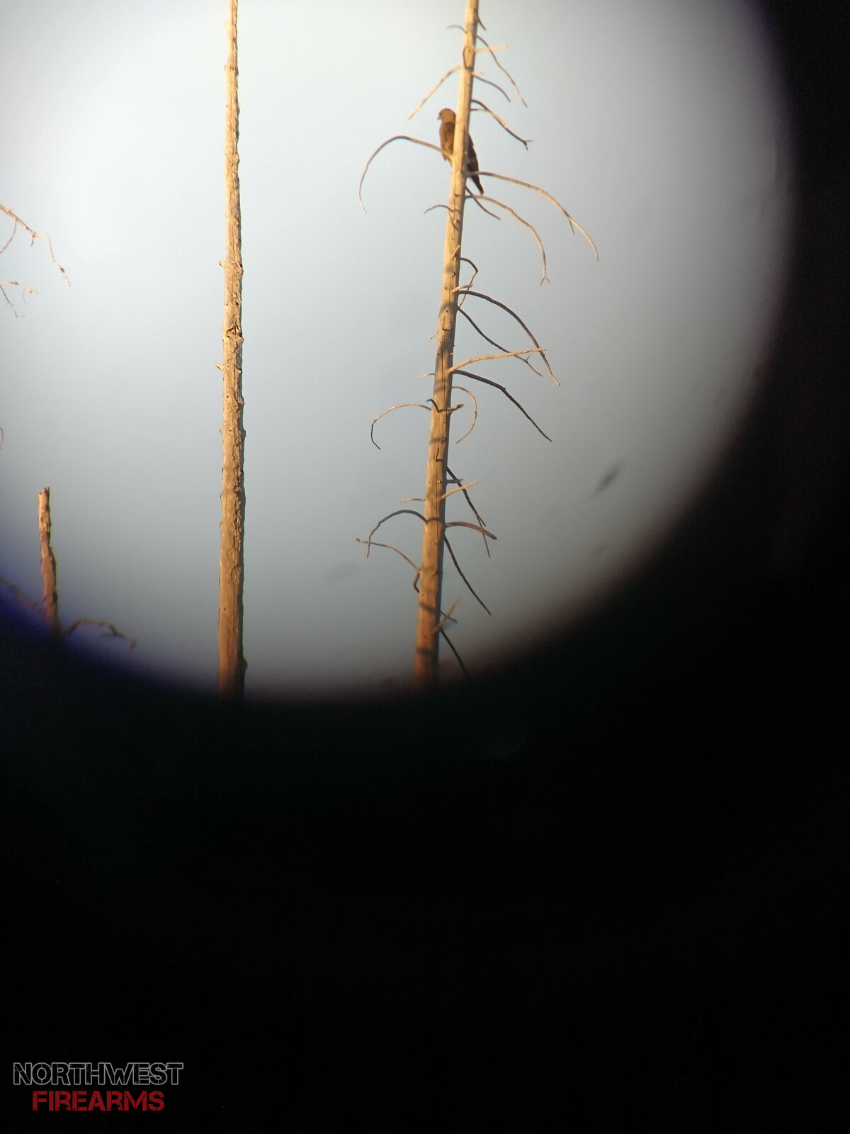

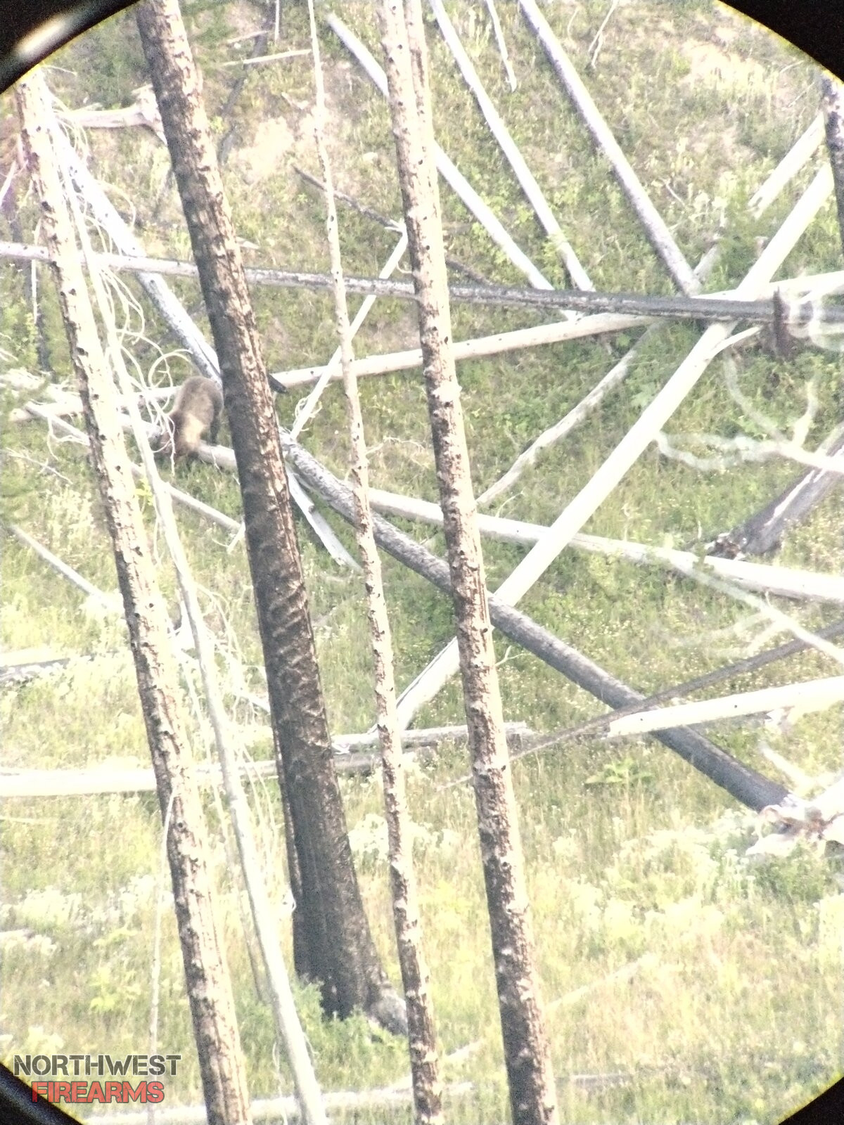

I've got a Swaro ATX with 65x on it. It's pretty clear. These are from last year in Yellowstone. I put my phone up to the eye piece. Hawk was a solid 300 yards, and the grizzly was at somewhere in the 1,000 yards range.
That's pretty cool! That grizzly picture looks almost like a painting.
I couldn't help but laugh. There was a guy that was there looking for the grizzly before us. I spotted her, and I was full zoom. The dude was getting mad that I couldn't give him a better explanation. "Ummm.... I can only see part of the tree, I don't have reference other than that way."
He wasn't pleased :s0140:

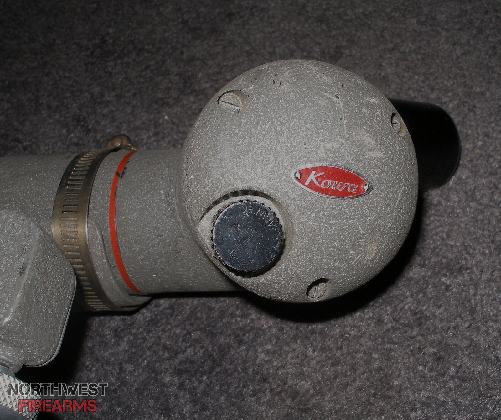

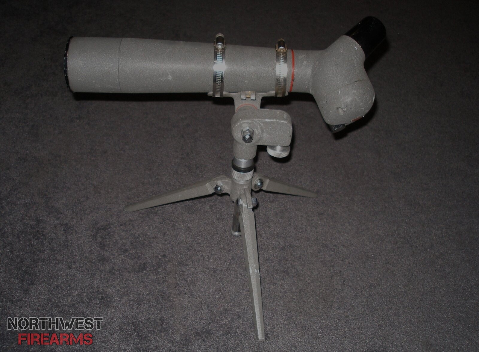

I'll be darned. I just thought my old clunker spotting scope was an old clunker. 25x.
Permission granted to laugh at the hose clamp replacement mountings. I'm not a long range shooter but this one has worked for me a long time. The range where I'm a member used to have one day a year when we had a member swap meet. I think it came from there for a few dollars. I've absent mindedly left it behind at ranges a few times but it was always there when I'd go back later.
