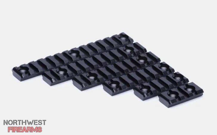

These are Tacticon MLOK rail segments. I am not sure if you can get these from any other supplier (Tacticon is just a Chinese reseller, I have no idea how many of their parts are unique to them), but they are solid aluminum and don't seem to have any spec issues. The specific one I use is the 13 slot rail, which is the longest.
