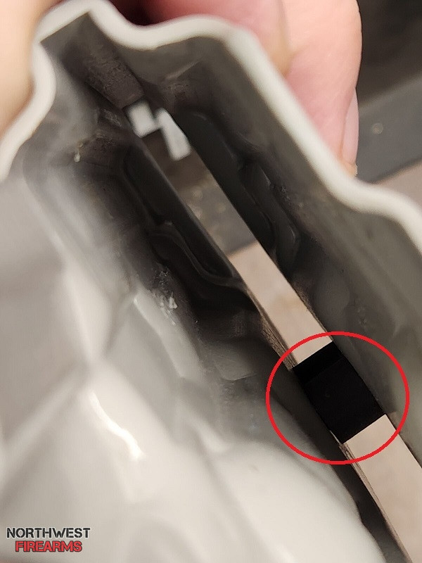

What I have done to a similar too-tight holster:
Removed the tension spacer (circled in RED).
And made a longer replacement spacer from rubber fuel hose (1/4" or 5/16").

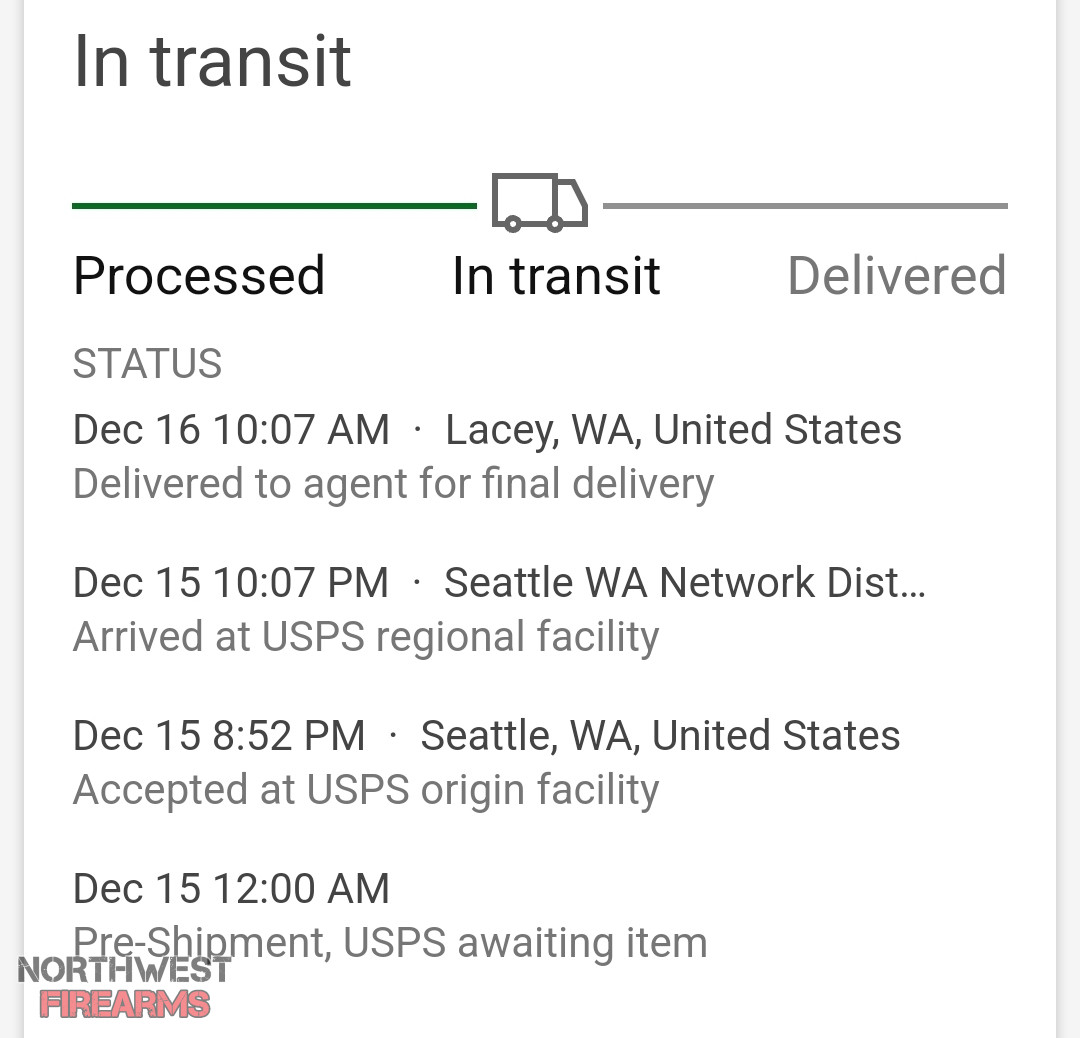

Nope, I was just kinda sitting around, and realized I hadn't heard anything from Cascadia, and I checked the tracking number and realized the holster never got delivered.
oh man, sorry to hear. I feel bad as I was encouraging to send it back to them. Isnt there some kind of basic default shipping insurance you can recover the cost?
Yup, default insurance on Priority is $100, and the holster was $94 with tax, so as long as they don't jerk me around...
