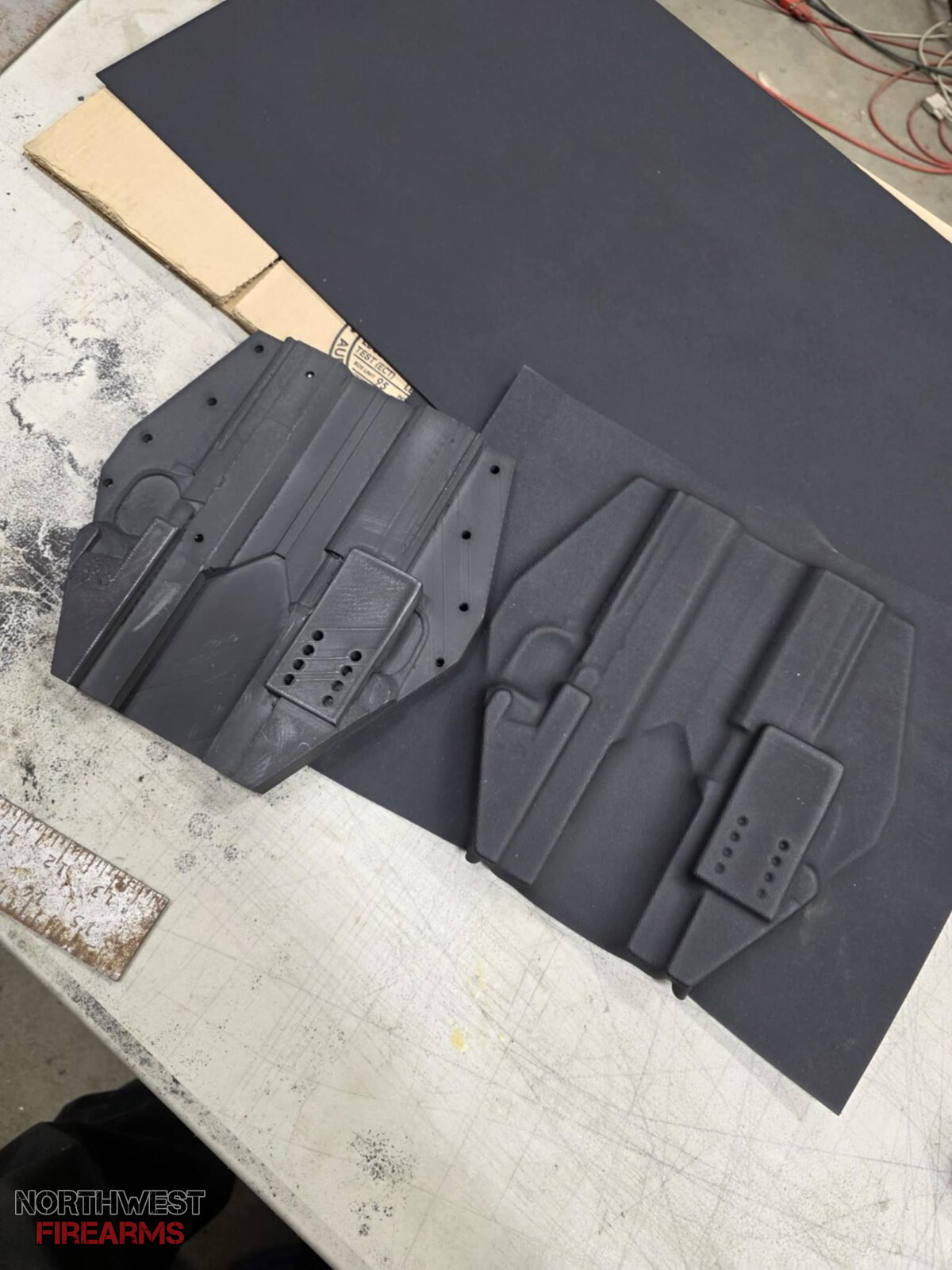

Scanned my RIA Tac Ultra FS-DS

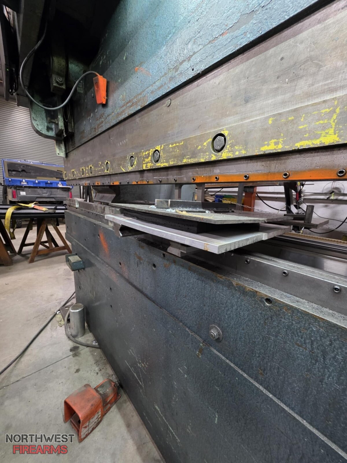

Dunno if 160tons was enough....
Not back for a 1st stab.
I have an outer print so I can have a router jig.
Question is best way to heat the sight channel and bend it. The bottom mold comes off the base plate and pegs together for a complete gun mold.
Just heat gun and fold it over I suppose.

It certainly doesn't take a real press. Vacuum forming looks really fun but a simple foam book press works. The real meat here is scanning and printing the molds, no layers of tape and gum on your gun or a blue gun.
It comes out with drill holes, router jig, etc.
Its totally garage friendly.
Cut wood and masking tape in place the sight channel onto blue gun before press
No blue guns/tape/glue/etc. required if you have the tools.
Getting the process down to A to B.

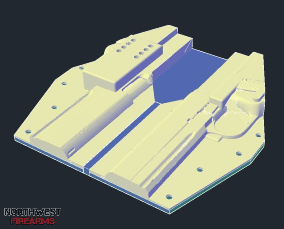

Fusion 360 is really good but Rhino3D seems to be the only program that can shell a mesh.
Can I see more of this process? You scanned your gun and then edit in Rhino3D? What material is the mold printed in?
I'm trying PLA+ on the lastest. PETG would be good as well. Rhino would do all the mesh work but I keep getting bugs , might need upgraded. Fusion does a little better. Solid work is in Autocad.
If all you need is a mold, creat an assembly model, position the scanned gun and subtract it from the mold block.
I work in Solidworks so I dont know how/possible that is in other CAD systems.
I used Fusion in the past but it's been years now. More recently I tried FreeCad, but that was not very intuitive. I'll have to play with this some more.
Its simple if your dealing all in solids. Problem is the scans are mesh polygons which get too heavy as solids unless you reverse engineer them into solids.
Programs that do mesh Boolean (add/subtract/etc.) well are a little rare- one does this, one does that. The scans can be really DIRTY (bad faces, holes, etc.).
It took some experimenting in every program I have to get results.
Not happy with the sight channel onto the glock, needs tweaking. The Beagle is too tight, printed some 1 peice spacers to adjust it a bit. Overall not bad, I really want a vac press, foam just isn't the same.
