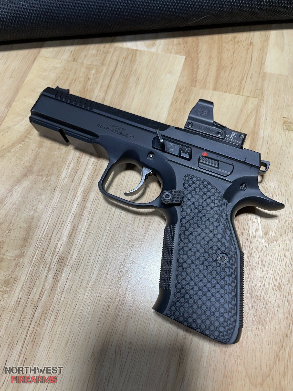

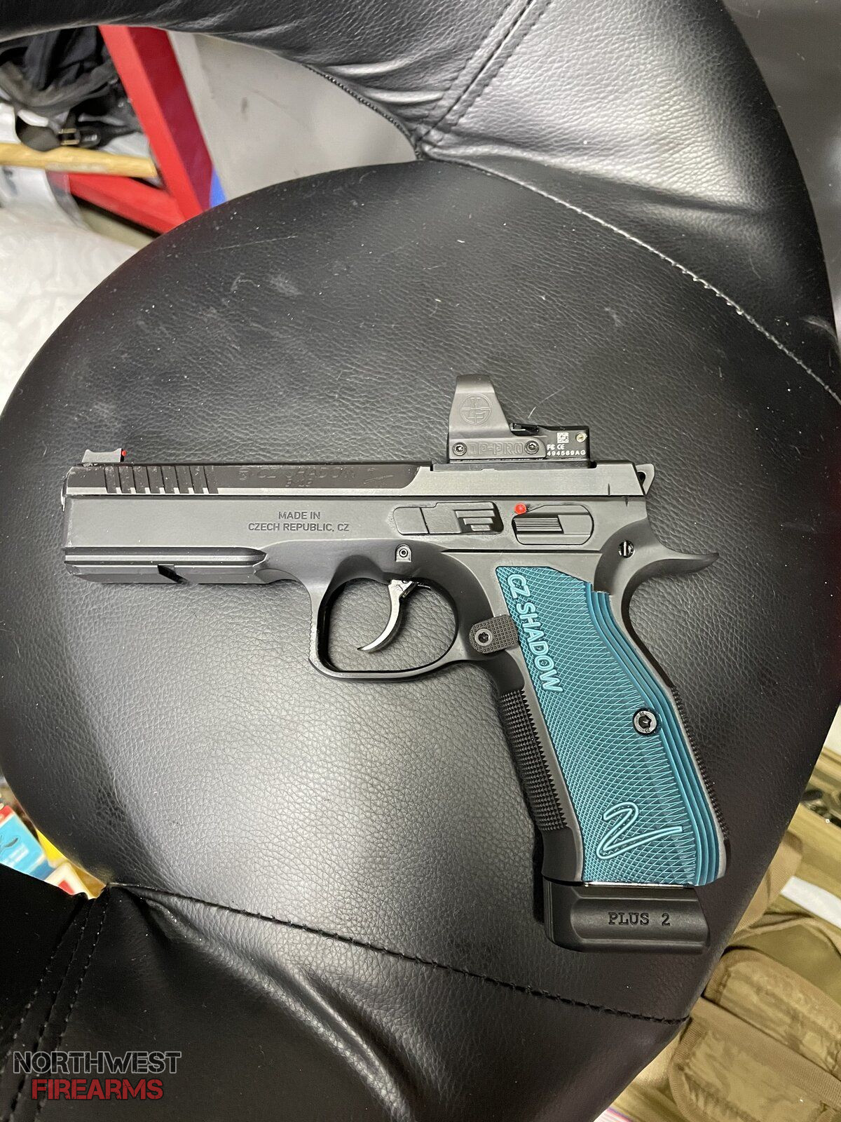

Sorry it took so long. This thing is awesome. I ordered and installed the Cajun gun works upgrade kit with reach reduction and their barrel bushing. The gun is absolutely incredible! It's like a finely tuned Swiss watch. In DA it's about 7 1/2 pounds and in SA it's about 2 1/2 pounds

That has to be one of the smoothest double actions I've seen, what do you think the pull poundage is in double & single action? Did your gun come with that gas pedal, or did you add it?

It is crazy smooth. 2.5lbs single and 7.5ish double action. The video clip can't do it justice. I've played around with different hammer springs and got the DA weight down to 6lbs. CGW warns that if you go that low you may have occasional light strikes, especially with CCI primers. If you're using federal you'll be fine. I left it at 7.5-8lbs because it's so smooth. Plus the reach reduction makes the total trigger travel a lot less. I installed the gas pedal. I love how it feels.
