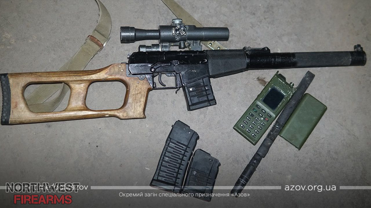

Here's a Ukraine battlefield pick-up that I recently saw a few weeks ago. It's a type not seen around these parts too much.
VSS(Special Sniper Rifle) Vintorez
Manufactured by Tula, it fires the 9x39mm subsonic cartridge. It's got an integral suppressor and a PSO-1M2 4X24 scope mounted.
The action is akin to that of AK-type rifles; a similar long-stroke gas system with the piston located above the barrel.
The Vintorez design characteristically uses a rotating bolt with six locking lugs and a milled steel receiver.
Also shown are a couple mags with what appears to be some black tipped and blue-tipped SP-6(7N9) armor piercing bullets.
I would be curious as to how this round (245gr-276gr bullet) matches up ballistics wise with the .300 Blackout subsonic.
If anyone has more information on the VSS Vintorez/the 9x39mm cartridge, or feel free to post other interesting Soviet Era firearms/cartridges in this thread.
View attachment 1176239View attachment 1176238
