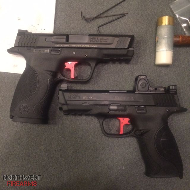

Watched a few video's on YouTube on installing the Apex Trigger. Looked easy. Took them about an hour or so. Took me about 4 hours. Not as "easy" as they make it out to be, at least for me.
But it is in and works.
The trigger is much smoother with less grittiness and a bit lighter pull. It isn't so light that it would be a hazard for CC though. I really like it, that and the Stainless Steel guide rod.

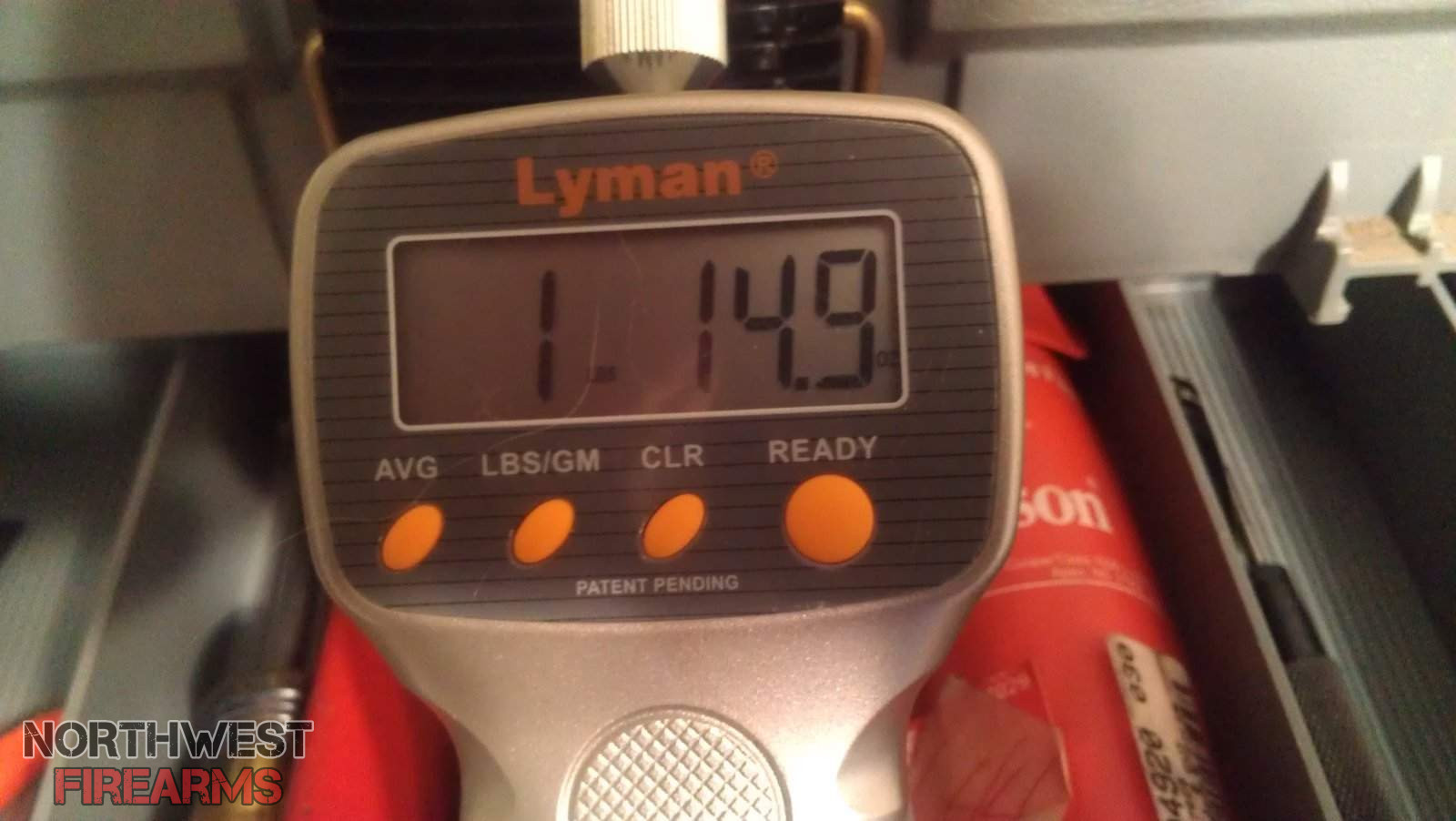

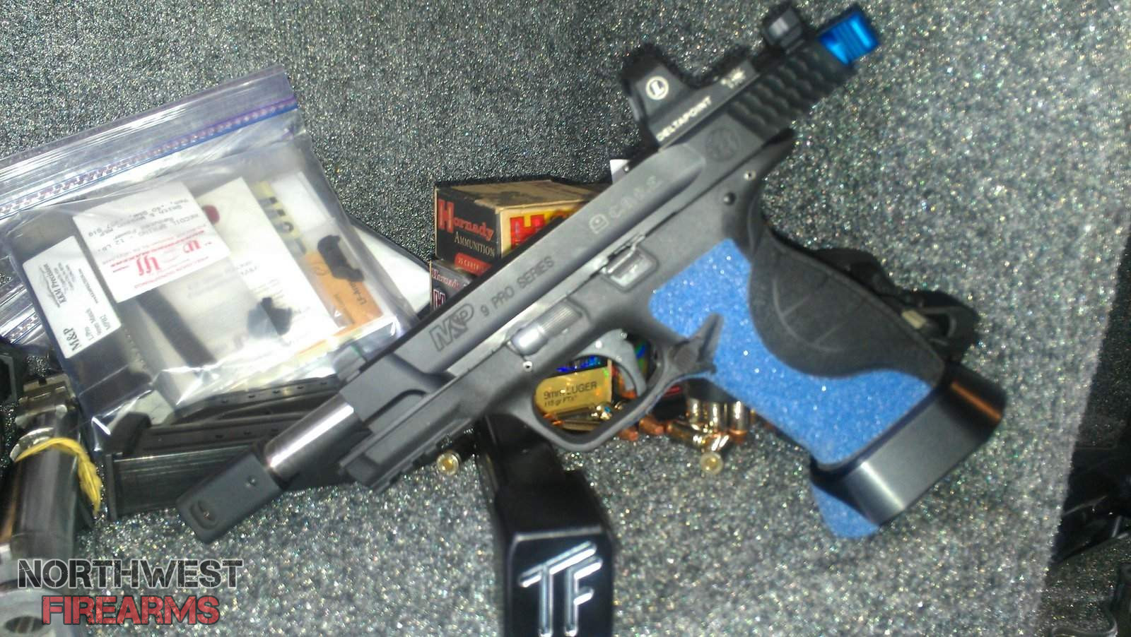

I got their gun smithing block and it made it easy..... installed on my M&P core and got under 2lbs.
Used their competion springs and trigger.
