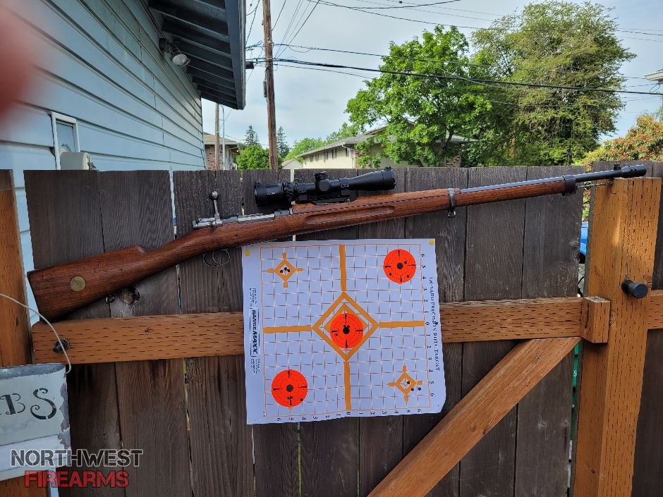

What scope are u using? I imagine the eye relief would cause the shooter to hunch their heads forward.
Must be some kind of long eye relief scope. I've used those a couple of times on old milsurp rifles that I didn't want to disturb the originality of. There are mounts made that allow you to remove the original rear sight and replace it with a scope mount.

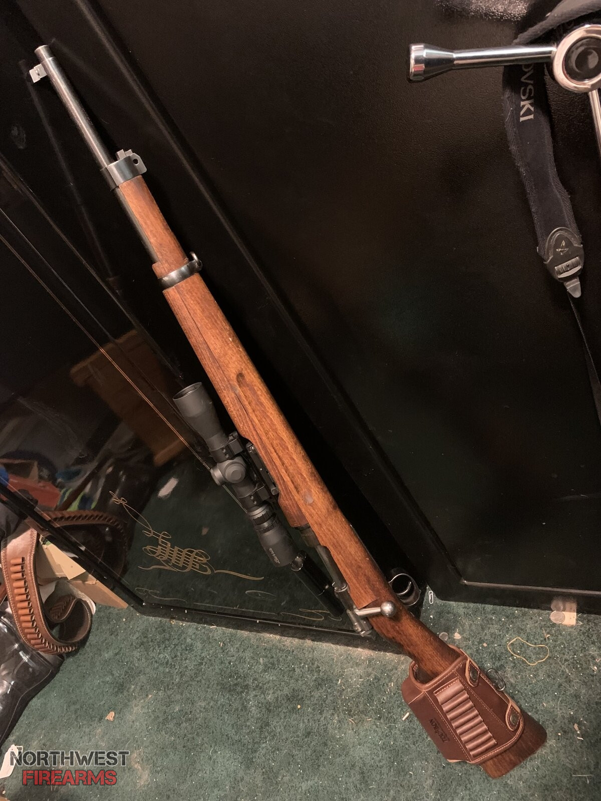

I got my M38 dialed with the same setup. PM me if you would like some data. 100yd ladder testing. Aftermarket trigger helps a lot.
I got to posting some years ago on gunboards.com when I became interested in the Swedish Mausers. I became aware of the Bad Ace mount that attaches to the original rear site base with no modifications to the gun. A member there had replaced his straight bolt with a bent bolt and had no more use for this:
https://vortexoptics.com/vortex-crossfire-ii-2-7x32-vplex-moa-scout-scope.html Or the Bad Ace mount, and made me a helluva' deal on the two. The guy takes good care of his stuff, the scope and base look brand new and 9" eye relief gives a perfect picture of the target. Perfect for me, my eyesight really doesn't allow me to enjoy shooting over 50-60 yards with iron sights.

@Mikej my trigger is 2lbs. Feels like the set trigger on my CZ527. Had to relieve some wood to get it to fit. The Husqvarna trigger was smooth but near 5lbs with longish pull.
