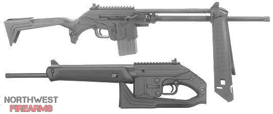

Or 2 PLR-16s which will nearly fit end to end in your Jeep if you wish. They come in at 18.5" long and weigh 3.4lbs without ammo. Takes any AR-15 mag and shoots 5.56/.223 ammo. Costs @ $600 or so last I checked.
Negatives, short sight radius, more recoil (due to light weight), more muzzle flash (due to short barrel).

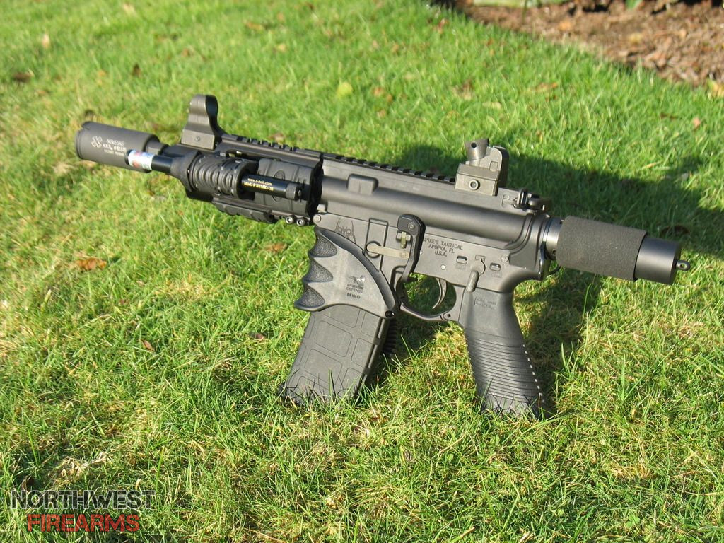

But for a small AR without a stamp, I would definitely do a pistol. 14" barrel to keep the ballistics up and a sig brace would make a nice little truck gun
And if 10mm is accurate at 150 yards I'm sure a 556 pistol will be fine out to 250 maybe more
