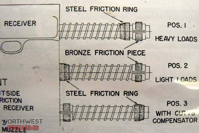

If it's a Browning Auto 5, then the friction ring must be adjusted to the shells power loads that are being used.
A very light coating of 30wt oil is generally used on the ammo tube.
Don't shoot hvy game loads when the friction ring is set to light skeet loads, because you'll damage the gun, but if you're shooting light loads and it's set up for hvy loads, then it won't cycle correctly.
