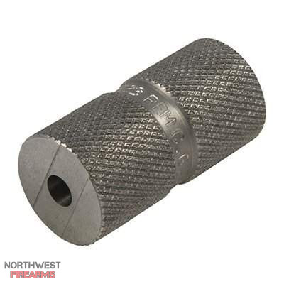

I prepped 600 cases, was all proud of myself and my mentor at the time said time to grade your work..... Over 80 cases failed the case gauge check....:eek::eek::eek:
For less than $20 these are a must have... especially if you're loading for semi-auto's. If you're loading 300bo and forming from cut down 5.56 brass they are essential.
Great tool, I was thinking maybe he didn't have one. So if the chamber of the firearm is available why not use it? I have had my share of learning experiences but never did own a thing like that, and never had a major fail due to improper prep. and set up wile using my own chambers.
All I've ever used are the chambers of my own firearms. I've often thought a guage would be great to have and much easier use, but this always occurs while actually reloading.
It never serms to cross my mind when sitting at the computer actually putting together an order so I have never actually got around to purchasing one.
